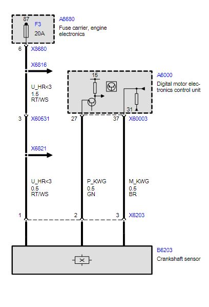

6 years 11 months ago #34903 by motah33
This diagram shows the crankshaft sensor I have (as shown in the attachment): www.newtis.info/tisv2/a/en/e46-316i-lim/...shaft-sensor/hCVEZvo
If I connect a multimeter between Pins 2 (negative lead) and 3 (positive lead), I measure about 7M ohms. Does that sound about right? Can measuring the resistance damage the sensor in any way? I read on a forum that it could. However, on my DMM, at 40Mohm setting, it barely produces a 1mV.
I measured the voltages on Pins 1, 2 and 3 on the connector (no sensor connected), with the ignition on, and got the following:
+11.8V between Pins 1 and 3
+10.8V between Pins 2 and 3
Pin 2 as the signal/reference pin is not +5V but close to +12V. When I turn the ignition off, all the pins show 0V.
I connected a crankshaft sensor to the car, brought a large spanner next to it and nothing happened to the voltage on Pin 2 i.e. the +10.8V stayed fixed. From what I read online, bringing a metal object next to the sensor should cause that voltage to drop to 0V. That could be pointing to a bad crankshaft sensor?
I was watching the 'Hall effect cam/crank sensor operation and testing Part 2 (an SD Premium video)' and about halfway through, with the section on the bypass test, I got the impression that the engine may respond differently if there are camshaft sensors on the car as well. I've got 2 camshaft sensors and 1 crankshaft sensor. I presume this doesn't affect the issue with the sensor itself but does that mean the ECM needs to see signals from the camshafts too before it starts to activate the fuel pump, injectors etc?
Is it possible to bench test a crankshaft sensor? Supply +12V to Pins 1 & 2, GND to Pin 3, bring a metal object close to the sensor, and the voltage on Pin 2 should be close to 0V?
Thanks
6 years 11 months ago #34905 by jreardon
Based on your measurements it appears this is a 12 volt pull down hall sensor.
"bringing a metal object next to the sensor should cause that voltage to drop to 0V. That could be pointing to a bad crankshaft sensor?"
Yes.
"does that mean the ECM needs to see signals from the camshafts too before it starts to activate the fuel pump, injectors etc?"
Maybe, it depends, that's why the bypass test is not 100% reliable across all car makes to work because some cars need both cam and crank to be timed correctly for a reaction. However in your case you could try cranking the engine while creating a low signal on the signal wire (incandescent test light to battery ground). Couple this with a crank sensor signal fixed high and a successful bypass test with engine cranking, and a successful computer reaction like an rpm signal in your scan tool, that maybe all the info you need to buy a new crank sensor.
Yes.

6 years 11 months ago - 6 years 11 months ago #34929 by jreardon
When I found out it was a 12V type, I tried again but this time I used a single 12V supply: Pin 1 was 12V, Pin 2 was pulled up to 12V via a 2kohm resistor and Pin 3 went to GND.
I think you mean to say pin 2 was supplied 12v through a 2kohm resistor.
Even if a sensor passes some basic tests, is it possible that it's only working intermittently?
Yes. If it passes your bench test, that's no guarantee it would continue to work in the confines of a hot engine compartment.

6 years 11 months ago #35012 by motah33
I'm trying to bench test a crankshaft sensor and it's just not reacting. I'm not sure what I'm doing wrong here. I've tried the sensor which I removed from the car when it was working - the engine was starting fine. This is the second sensor that I'm using. The first I was unsure of because I bought it used but both are giving me the same result.
I'm using a single +12V supply. This goes to Pin 1 (+12V) and Pin 3 (GND). I then take a 2000 ohm resistor from the same +12V supply and apply it to the signal pin (Pin 2). This should simulate power to the electronics in the sensor and the signal wire pulled-up to +12V which is what the ECM would do. It's now down to the sensor to pull that signal wire to 0V when I bring a metal object to nexto to it. However, it stays at +12V. Am I supposed to have a separate +12V supply to the signal wire?

Is it possible that pins 2 and 3 are wrong in the wiring diagram?
I just saw the wiring diagram for a N54 crankshaft sensor which is almost identical to the N42 one except Pin 2 is GND and Pin 3 is +5V. In the diagram I have for the N42, pins 2 and 3 are swapped.
Both the N42 and N54 engines show an A6000 DME control unit. The N54 shows a B6203a crankshaft sensor and the N42 shows a B6203 crankshaft sensor.
6 years 11 months ago #35045 by jreardon
motah33 wrote: Is it possible that pins 2 and 3 are wrong in the wiring diagram?
That wouldn't make any sense from the voltage measurements you took with the sensor unplugged.
Perhaps the description of the sensor is wrong and the increment wheel is the magnet, and the crank sensor responds to magnetic fields. Try a magnet off your fridge.

6 years 11 months ago - 6 years 11 months ago #35057 by motah33
Thanks for the reply.
I've tried it with magnets before and not got anything out of it.
I swapped pins 2 & 3 and I got a reaction. I have: Pin 1 = +12V, Pin 2 = GND, Pin 3 = +12V (signal) via ~2000 ohm resistor connected to same +12V supply as Pin 1. This is what the meters read:
No magnet near sensor:
Current being drawn from PSU: ~13.33mA
Signal voltage: ~178mV
Magnet near sensor:
Current being drawn from PSU: ~14.74mA
Signal voltage: varies to around ~775mV peak.
I also found that sometimes it would stick at ~775mV until I "unstuck" it by bringing a magnet next to it once again. It works the same way with the magnets and with a large spanner. I get the same voltage when looking at it on a scope: produces a square wave as you move something near it but the voltages are as above, not what I've seen in the videos.
This is what I don't understand: I went to re-check the crankshaft sensor's connector on the car and I'm still getting Pin 1 ~12V, Pin 2 ~10.8V and Pin 3 GND.
No idea what's going on here.

6 years 11 months ago - 6 years 11 months ago #35091 by motah33
Solved!
I was using crocodile clips to connect to the pins on the sensor. They had boots on but it looks as they might have been touching at some point deep in the connector. I found some smaller ones, put insulation between them and it works - bring a magnet close to it and Pin 2 swings from +12V to 0 and back again!
When the voltage swing is normal, it takes 6.82mA (at +12V) but sometimes it sticks to 0V (takes 13.44mA). It might be just the way I move the magnet - it sticks to the sensor sometimes. But if I move the magnet close to it again, it works fine. Does this sound normal?
Could there be any damage to the sensor with the pins touching or when the pins were swapped?
This is from bench testing the sensor:
What I discovered is that the first time I apply power, the signal voltage is at +12V. When I move a spanner next to the sensor, the voltage on the signal pin stays at +12V. When I pull it away, it drops to 0V. Now, when I push the spanner towards the sensor, the voltage changes to +12V and when I pull it away, it goes back to 0V. This now repeats. It's just the first time, after power-up, that I get the unusual "sticking" effect. I realised that if try to move it past the sensor, side-to-side or some other pattern, it sometimes sticks at 0V but after a few more tries, it's fine. If I bring a spanner square on, wait for the voltage on the DMM to go to +12V, and then remove the spanner, the voltage then swings as expected. This works every time.
These are the results from trying it on the car:
The first time I connect the car battery to the car electrics, the voltage on the signal wire is +10.8V. After that, once I bring a spanner next to the sensor, the voltage drops to 0V. Thereafter, it works as above i.e. bring the spanner next to it and you get +10.8V and pull it away and you get 0V. Even if I switch the ignition off/on, it stays at 0V. It's only when I remove the leads from the battery and then re-apply, that I see the signal wire start at +10.8V.
Does this sound about right?
