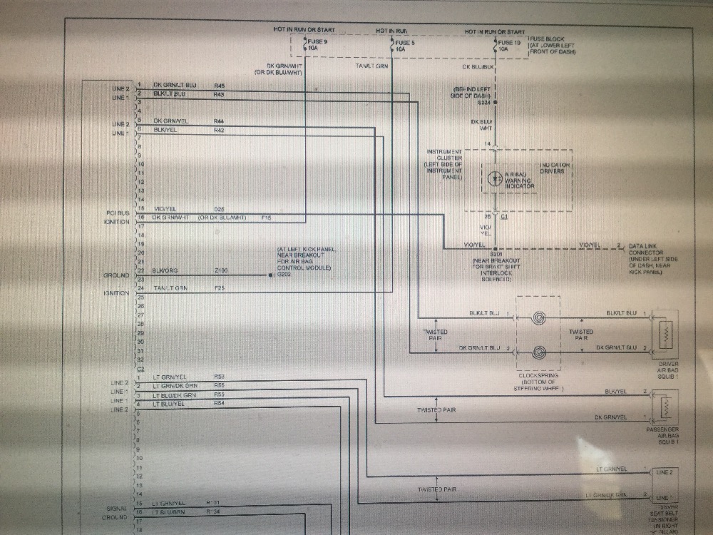

My Autel AP200 scanner dongle displays an active and a stored P1200, airbag pretensioner circuit open code. Resistance in the driver’s side pretensioner unit itself reads 0 ohms on my Klein auto ranging DVOM. Not an open, I know, but from what I have read that resistance should be between 2 and 5 ohms. Tried a 2ohm resistor plugged in to connector in place of pretensioner And light stays on and code won’t clear. Resistance on the circuit measured at connector is 2,300 ohms. What else can I measure? Are there any insights that can be gleaned from what I have found?
Thanks, guys,
Pop
6 years 11 months ago #35015 by Cheryl
Replied by Cheryl on topic 2004 Chrysler PT Cruiser Airbag light
Can you post wiring diagram? If all possible... so we can troubleshoot this
  • popoften

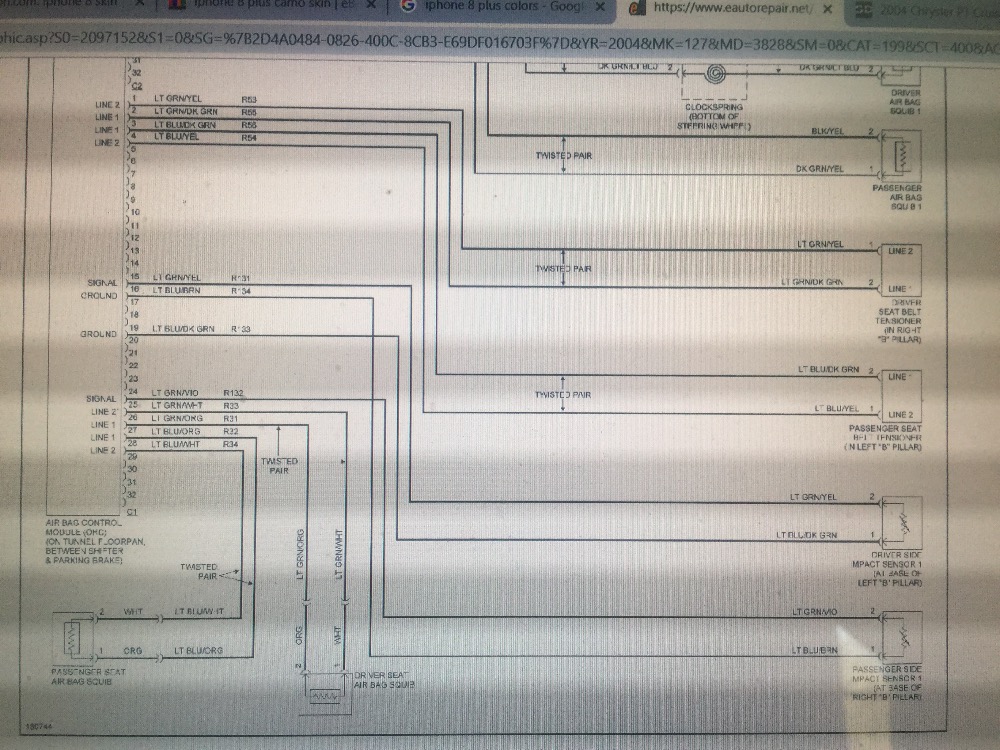

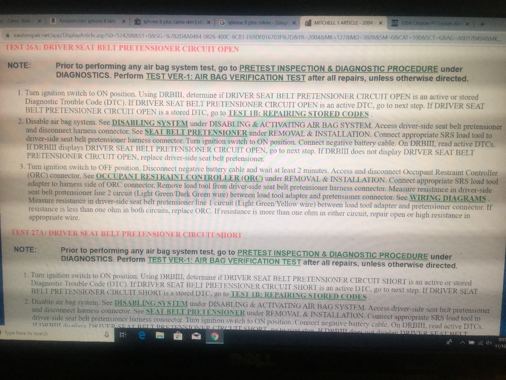

6 years 11 months ago #35053 by popoften
Replied by popoften on topic 2004 Chrysler PT Cruiser Airbag light
Here is the diagnostic procedure and diagram. Any advice on DIY approach appreciated!
See pix. Thanks!
6 years 11 months ago #35055 by Cheryl
What does the passenger side pretensioner read? If you put a 2 ohm resistor in place I’d try with the passengers side to see if the module responds. Only other thing after that is checking resistance of the wires from ocm to drivers pretensioner for opens and shorted to each other or short to grounds/power

6 years 11 months ago #35076 by Tyler
Replied by Tyler on topic 2004 Chrysler PT Cruiser Airbag light
Gotcha. If you're confident that you had the two ohm resistor installed into the pretensioner connector correctly in step two, I'd redo step three and see what the total circuit resistance is. The way you had it set up previously may have been reading the internal resistance of the module itself.

6 years 11 months ago #35078 by popoften
I do not have the "load tool adapter" step three talks about. Can I measure the resistance in the circuit without the adapter and just carefully use the ends of my ohhmeter leads?
6 years 11 months ago #35083 by Tyler
Sure! That'll work. Just pick one wire at a time and measure for resistance and short to ground. With the ORC and pretensioner disconnected, of course.
The load tool they're talking about is just your two ohm resistor. Dunno why they can't call it what it is. :lol:
