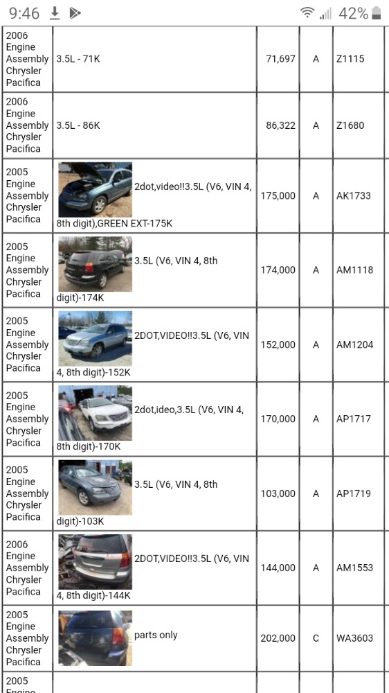

6 years 11 months ago - 6 years 11 months ago #35147
Replied by Noah on topic 2006 Chrysler Pacifica 3.5l. Hard start, will start and run but will not drive.
Judging by the search results from car-part.com
www.car-part.com/cgi-bin/search.cgi
The direct interchange appears to be 2005-2006 only
Edit:. I don't know why the link doesn't work, but here's a screen shot of available engines for sale. Only 05 and 06 listings. If anything else fit, I'd expect to see it listed here
