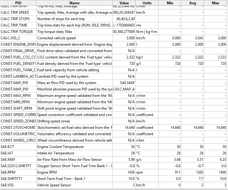

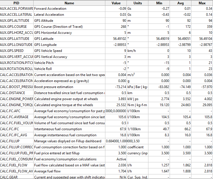

6 years 11 months ago #35406 by scotty.sutherland
Replied by scotty.sutherland on topic Subaru Impreza 2003
this is only data mine shows, thts log from warmed up not got 1 from cold yet :)
6 years 11 months ago - 6 years 11 months ago #35407 by Noah
Replied by Noah on topic Subaru Impreza 2003
Have a look at the coolant temp PID before you start it cold. See if it looks reasonable. It should be very near the intake air temperature or ambient air temperature.
During that capture you were 50°c min, max & avg. So it never changed during the capture which doesn't necessarily indicate a problem depending on how long it was running and how long you were logging.
(50°C × 9/5) + 32 = 122°F. Thanks Google :)
If you can make a custom data list I would include:
Engine RPM, Desired RPM, IAC position, ECT, IAT, whatever throttle position data you have and engine run time (if available) and watch it warm up a little from a cold start without giving it any throttle.

6 years 11 months ago #35409 by scotty.sutherland
yea i started logging once i realised it started idling fine so it was already kinna warm, ill go get a cold start with no throttle, i open the log in scanxl, i have a bluetooth obd there pretty basic lol
