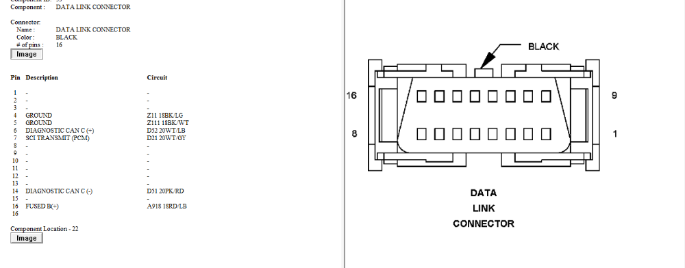

6 years 11 months ago #35445 by Paul P.
Replied by Paul P. on topic Stuck after a lightning strike!
MIL on at Key ON Engine OFF and 5v is good. The PCM has Power.
You PRNDL not lighting up or unable to connect a scan tool is a COMMUNICATION fault on the CAN + and CAN - data lines.
So let's start off with some basic Voltmeter checks at the DLC where your scan tool hooks up.
Let's check the grounds first, this will all be KOEO(Key on Engine Off). On Volts, find a good B+ source and carefully probe(just touch) pins 4 and 5. You should have B+. IF you have a test Lamp, attach it to a good B+ source and touch 4 and 5, the lamp should light.
Next, check pin 16 for B+. Test lamp to a good ground and touch pin 16, lamp should light.
What are the voltage levels of pins 6 and 14?
Now switch over to the OHMS scale;
What is the resistance between pin 6 and 14?
What is the resistance between pin 6 and pin 4,5 ( assuming they are good grounds or find a good ground source)?
What is the resistance between pin 14 and pin 4,5 " "?

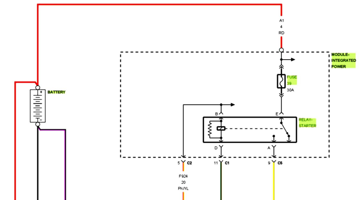

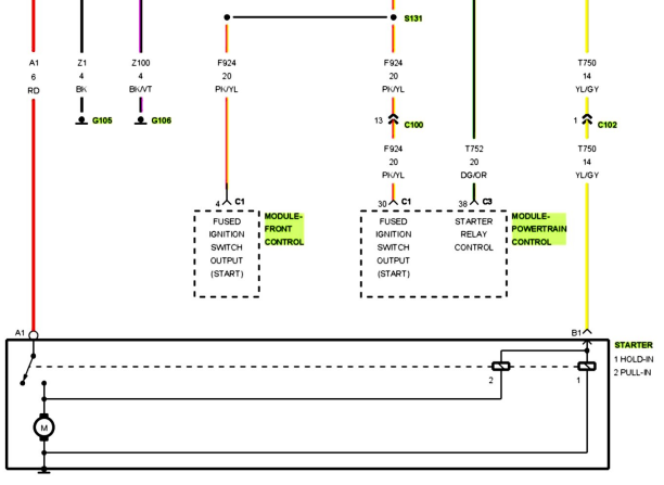

In a nutshell, this is how your starting system works;
The Ignition Switch changes the voltage level on the PK/GY wire to the Sentry Key Remote Module. This Module sends the Sart command via the CANbus to the Front Control Module ( aka TIPM) and from here, to the PCM (Powertrain Control Module) via the CANbus. The PCM then supplies the ground through Connector 3 PIN 38 DG/OG wire to the starter relay. Then the Vehicle will Crank.
You need to determine what is not functioning correctly on the CANbus (Pins 6 & 14 @ the DLC).
Let's start here for now.

OK - just checked that information and here's the results.
pins 4&5 have lots of power.
Pin 16 lights the test light
OHMS between 6&14 sat at about 55.8. (After reading why to do this test, I also tested it with the key off and out and it ready at 65 ohms)
OHMS between 6&4/5 - 0 same with 14&4/5
All were tested with the key on, engine off.
