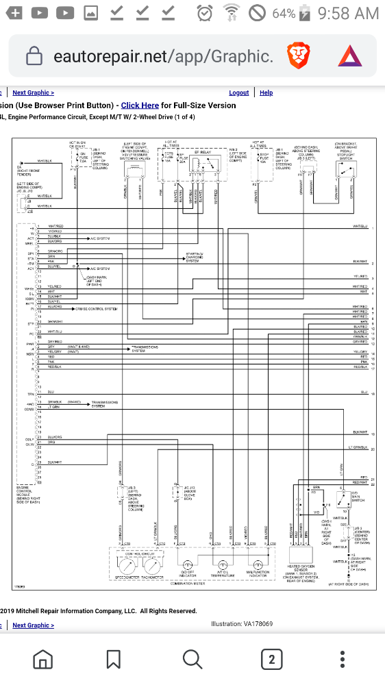

6 years 10 months ago #35579 by Cheryl
Replied by Cheryl on topic 03 Tacoma #1& #4 no spark
Got a diagram of the ignition system??

6 years 10 months ago #35581 by Otbrecords
Replied by Otbrecords on topic 03 Tacoma #1& #4 no spark
Let me know if you need anything else or if I'm missing anything. Once again thank you.

6 years 10 months ago #35583 by Cheryl
I see 6 injectors but only 3 coils. What page are the other coils on

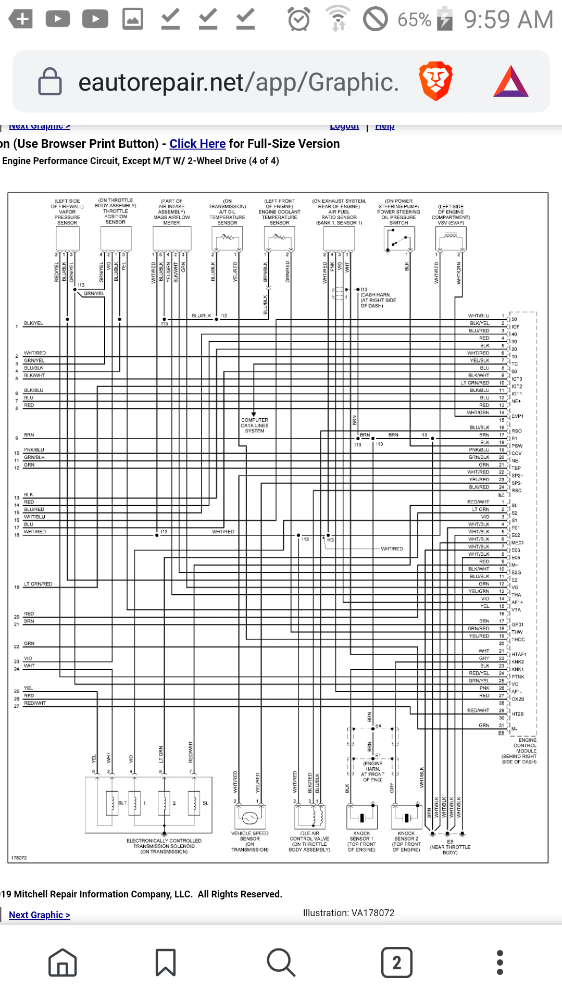

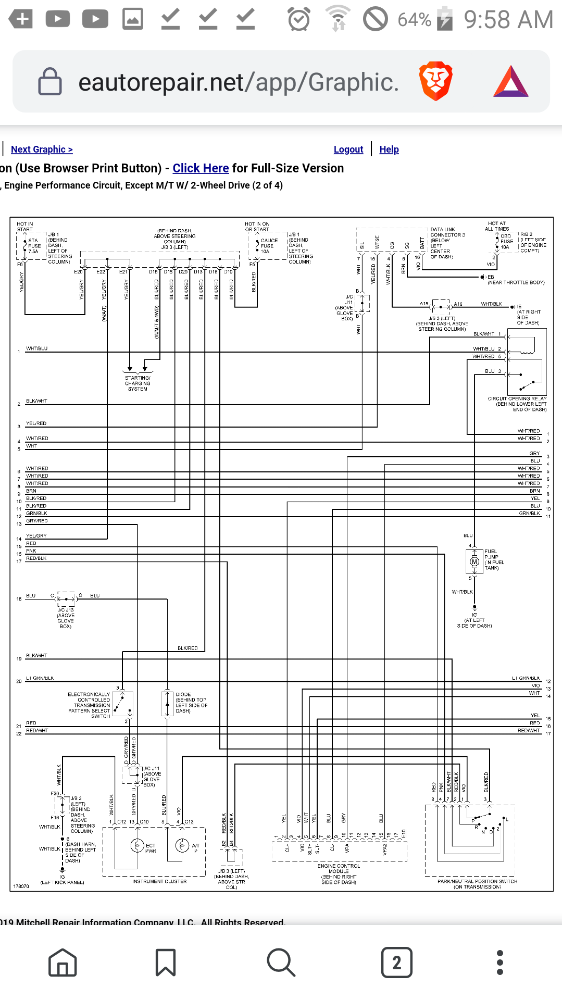

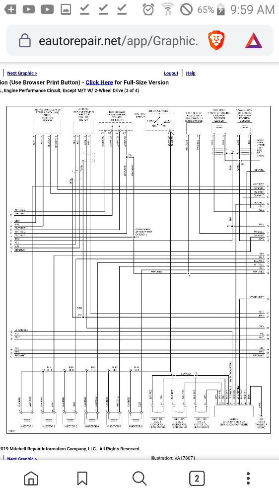

6 years 10 months ago #35584 by Otbrecords
Here are some better quality images. Only 3 coils on cylinders #1, #3, & #5, Each coil has a secondary wire for the other three plugs. That's why i have P0301 and P0304 because cylinders #1 & #4 share the same coil.

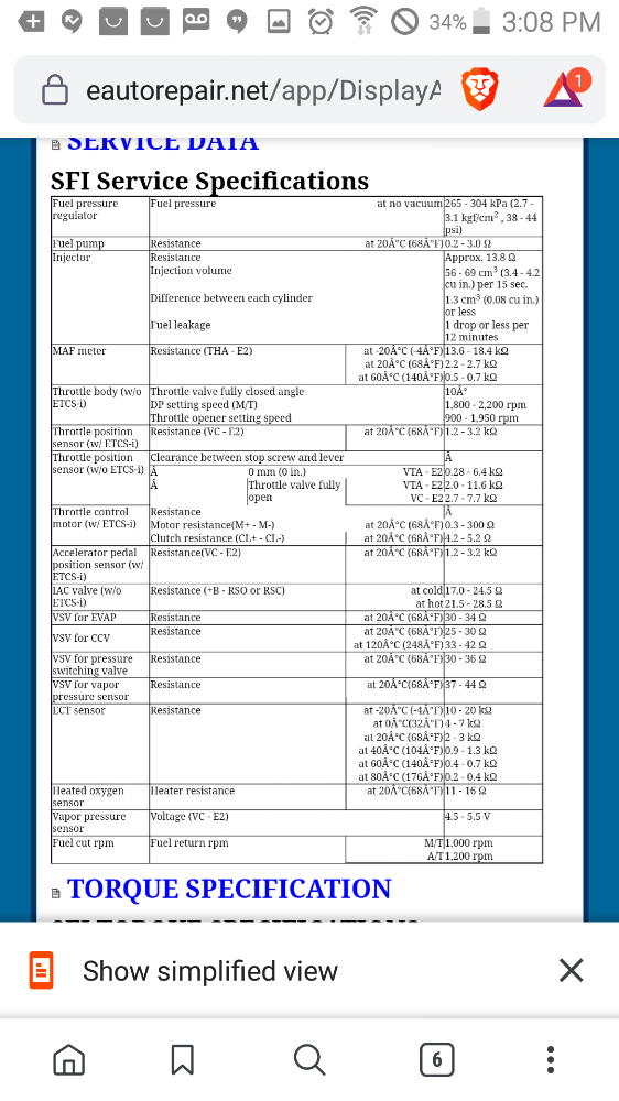

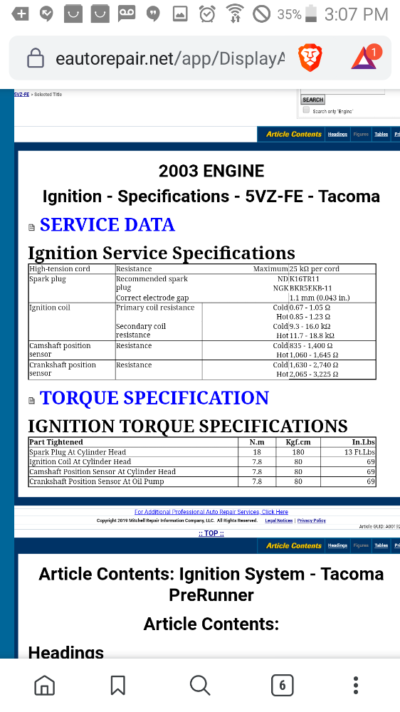

6 years 10 months ago #35589 by Otbrecords
This is what i've found so far. There's a lot of info, well worth the investment in Mitchell but I'll keep looking. I appreciate it once again. You've given me new Ideas and direction.
