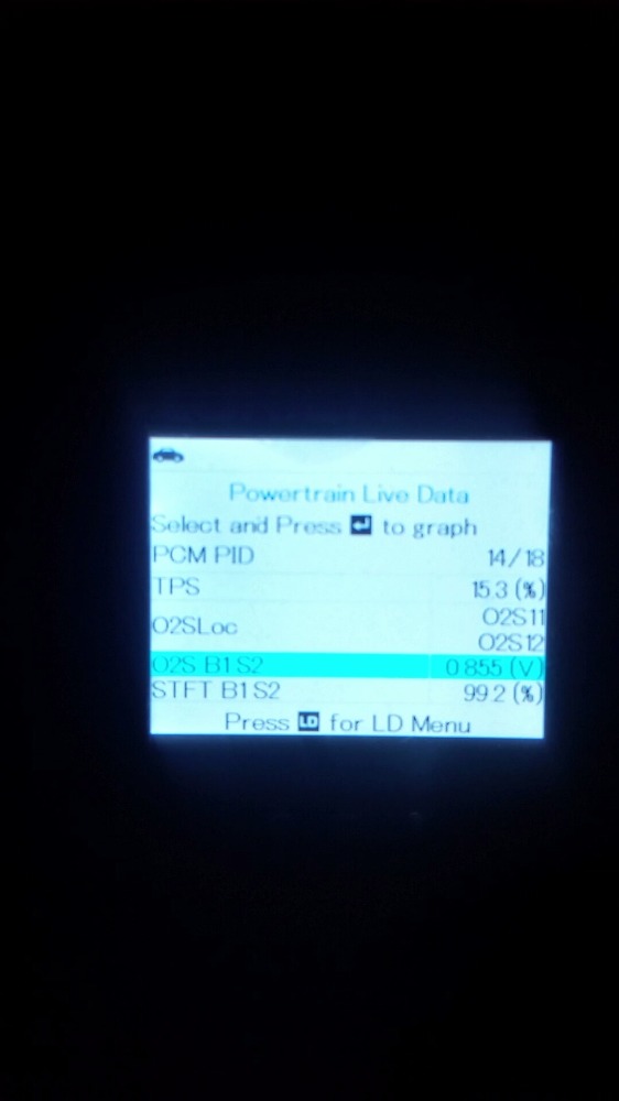

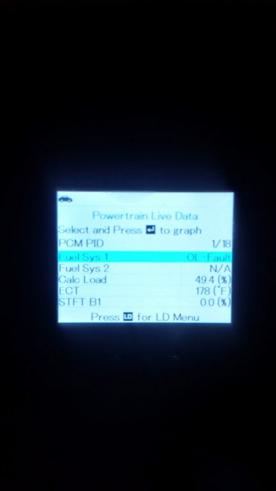

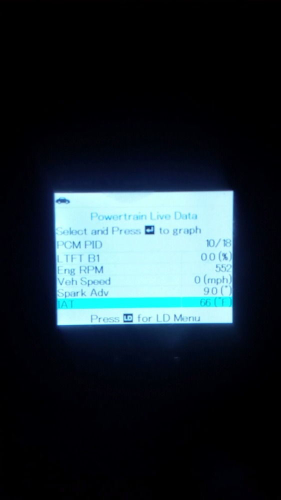

Thanks for asking Cheryl. I decided to "regroup" and put everything back together again. Since I'm not the one who initially started working on it, I thought it best to start with it assembled. That way I could find out if something was missing, I could get a fresh look at the enging, take a break with racking my brain and start it possibly take it down the road. I'm hoping that will clear up the issue or clearer idea whats happening. I went to Autozone for fuel line to empty the tank from the engine bay. I tried siphoning but either I'm hitting an anti-siphoning device or the bends in the tube are to much. The salesmen used the "force" and Jedi mind tricked me into buying that crappy clear tube w/hand pump. I HATE THAT GUY, HATE! lol I also bought a fuel filter and ended up drain the tank before reinstalling filter. That was last night and now with fresh gas I hooked up a scanner. Didn't run it long enough to get to temp because it was kinda late and it was spewing smelly fumes out the tail pipe. I'm getting ready to pull it out of the side yard out on the street so fumes aren't up near the house. I have some clue of what the live data is about but not necessarily in this context of "not a clue" what is the issue. I hope to come back with some info to share. Cheryl what makes a computer completely shut off signal to only one coil? I'm excellent at Googling info but can't find anything with that symptom. I will tell you I have one suspicion. The guy who did the timing belt also replaced spark plugs. When I performed a compression test I notice how easy the removal of spark plug were. I found out that he didn't torque them to spec and he doesn't have experience enough to not use a torque wrench. My point? That means he also didn't torque the crank gear and I can't help but wonder if the keyway pin sheared. Timing marks would still look good but timing would be off. The reading on the vacuum gauge is 10 inches just like i have a timing issue. When I started it up last night I looked for any kind of wobble for the crank gear but nothing. Darn, this isn't an easy one. Thoughts? Thanks again for checking on me.
  • Otbrecords
  • Otbrecords's Avatar Topic Author
6 years 10 months ago #35719 by Otbrecords
Replied by Otbrecords on topic 03 Tacoma #1& #4 no spark
I'll let these screen shots say what they will, I will share that there was a smell of "hot" coming from the truck or tail pipe. Please tell me what you see in the data.
6 years 10 months ago - 6 years 10 months ago #35726 by John Curtis
Replied by John Curtis on topic 03 Tacoma #1& #4 no spark
these Tacoma’s are notorious for the injectors failing electrically. I’m not sure if the ecm will cause intentional shut-down on this vehicle but it is something that should not be overlooked.
Usually with intentional shutdown the misfire counters stop counting (I don’t know if that’s an always or not) but from what I have seen it appears to be the case. Though this would equally disable injector pulse on the correlating cylinders to prevent baking the CAT

Thanks for thinking out load John, I appreciate it and learn a great deal. The 3 weeks I've been messing with this truck has VASTLY improved my diagnostic skills and I'm eager to learn. The information you posted is it good to know. Having that insight will only serve me well now and in the future. As far as what the computer is doing and why I don't know but it has IGT 1 shut down on the original computer and the replacement I have. The injectors are firing verified with a pulsing test light, a stethoscope, and wet plugs on 1 & 4. With my limited experience I gathered that this is unusual mostly because of extensive web searches turn up nothing about this specific symptom concerning IGT1.
