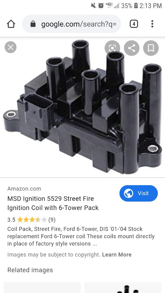

replace coil pack, wires and spark plugs. only the top part of coil pack ( cilyndres 1,2&3) has a jumping spark, the button part N0 Spark. what is next?

What do you mean? You only have spark on 3 of the 6? I can’t remember on those are they coil on plug or just a coil pack with spark plug wires? Also have any codes??

is a coil pack where the transistor are grounded at the computer, i hear that from the maestro "Scanner Danner". So today i will replace a computer?

yes,the code was misfire at cil.#4 so replace new coil pack from auto store then no spark on cil. # 4,5 &6. install a old coil now i am running fine
