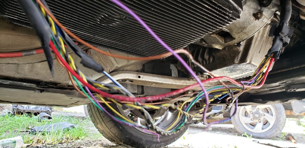

i have a 2004 bmw e60 (530i) and the car does not start , the enging will tumble only once and will not tumble again unless i disconnect the battery and reconnect it , multiple mechanics told me the dme went bad and i bought a new dme together with the keys and cas but am still getting the same problem , the car has been down for the past 4 months any help or suggestion will be welcomed

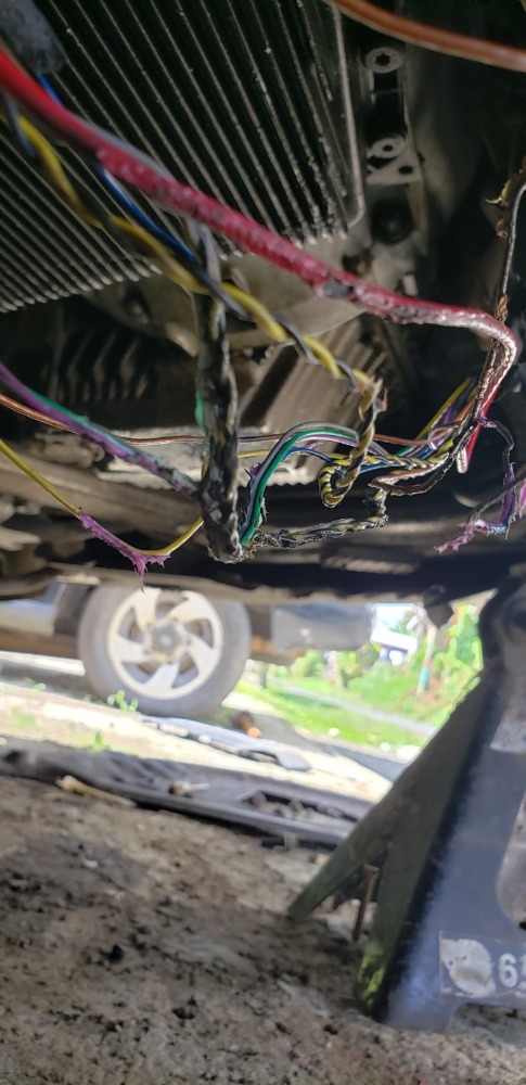

- skets
- Posts: 6
6 years 10 months ago #35908
by skets
Replied by skets on topic 2004 BMW E60 NO COMMUNICATION WITH DME
my friend got the car started today , apparently the some wires in the harness was fried so he replace them and the car started , there is a misfire and the number 6 coil misfiring so i am currently trying to source the part in new york will keep u posted ....
