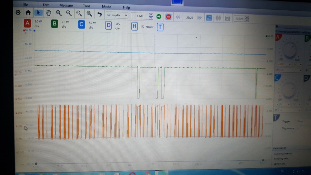

Goid day
I have jeep libarty 2004 v6 200kmil
Code p0433
I have intermetant drop in 5v of cam sensor
Can i take 5 v from other sensor (A/c pressure sensor ) to check ?
I mean support current 5v by other 5v from other sonsor that not use same 5v supply
Or i should disconnect the current 5v and plug other sonsor 5 v
Thanks

6 years 10 months ago - 6 years 10 months ago #35921
Replied by Andy.MacFadyen on topic P0433
Yes 5v is 5v (except for the temperature sensors) BUT be 100% sure you aren't dealing with an open not a shorted 5v ref As It is intermittent it is like you are dealing with an open somewhere in the wiring where the engine moves relative to the body.

6 years 10 months ago #35935
by VegasJAK
Replied by VegasJAK on topic P0433
the chrysler cam and crank sensors share a 5v reference voltage and are pull down hall effect... the signal wire on the cam will have 5v then 0v on off in a square wave design. If the signal is intermittent meaning you do not have a consistant square wave 0 to 5 volts you should have a P0344 code.
You maybe confusing the signal and reference wires.
P0433 is as Matt's Auto says, "heated catalyst effiency below threshold" error.

6 years 10 months ago #35941
by A93320336@gmail.com
Replied by A93320336@gmail.com on topic P0433
Yes it is p0344
I scope the 3 wire by backprobing
I lost 5 v then i lost signal

6 years 10 months ago #35944
Plz find attatchment the green is 5v supply
- VegasJAK
- Silencing the Parts Cannon
- Posts: 566
- Thank you received: 140
6 years 10 months ago #35949
by VegasJAK
If you're loosing the 5v reference voltage, you have an open in the reference wire from the common connection with the crank.
You asked if you can use a 5v voltage from another source. Yes, but you will have to remove the bad 5v cam wire from the connector and replace it with the alternate source wire. It would be better to fine the open in the reference wire.
