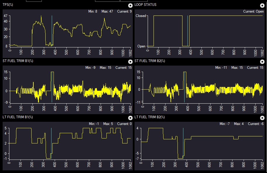

Are you ever actually noticing a misfire while driving? Or are you basing that solely on the misfire counters? Likewise, do you ever notice a lack of power, or are you only concerned about the trim numbers?
I gotta be honest, after reading the thread, I don't think there's anything wrong. :silly:
Sometimes the STFT spikes all the way to 29 for about a second. This seems to correlate with a misfire or two on random cylinders.
Was this while you were letting off the throttle? Because that's pretty typical for newer GM's when the PCM will shift into Open Loop and/or fuel cut decel with a closed throttle. Here's a shot from a '12 Captiva with very similar behavior:
* Random misfire on any cylinder. Sometimes 2, but never all at once.
How high do these counts go up to? Does the History PID on any cylinder ever show counts? Again, I sometimes see this on known good vehicles. The misfire monitor isn't perfect. :lol: If the miss counter ticks up to 2 then disappears, and the History never shows anything, I usually don't worry about it.
What scanner are you using, specifically? I was surprised to hear about a 'fuel flow rate' PID, as I've never heard of that on GM products. The Fuel Pump Control Module scan data is your best bet for ID'ing a pump problem. It'll have actual pressure, desired pressure, as well as pump trims. Keep in mind that desired pressure will change based on driving conditions, and isn't static.

You can see above that it def occurs when I snap/punch the throttle. (Do you make anything of what looks like a 10 psi drop on that shitty gauge?) I have noticed it occasionally when letting off/coasting as well, just not as often.
I'm using Torque. I have a hard-wired computer set-up as well (forget which program, not one of the major ones, but def usable), but I use Torque as the one to watch in real-time and to log trips. I have a screen set up with all 5 cylinder's misfire counters and their history, and it will show 2 for a few seconds, move it to history, and then erase it after maybe 20 seconds. Occasionally I'll get only a count of 1 misfire, but 90% of the time it is a 2-count.
I have a little bit of a trim issue, regardless, but nothing that I would be immediately worried about if not for this additional weirdness, at least in my mind. The LTFT can stay in the 9.5 - 12.5 range on the interstate. Your pick shows a spike up to 15, and my #'s are showing a spike up to what looks like it's maximum, but you think it might be just be open-loop anomaly? I'd be cool with that!
