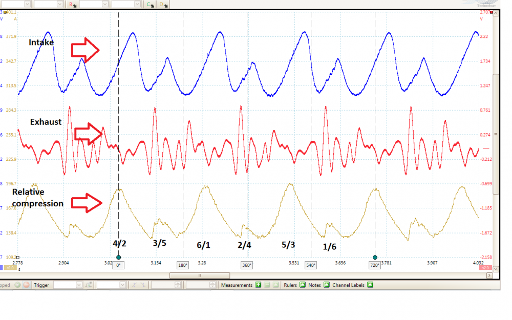

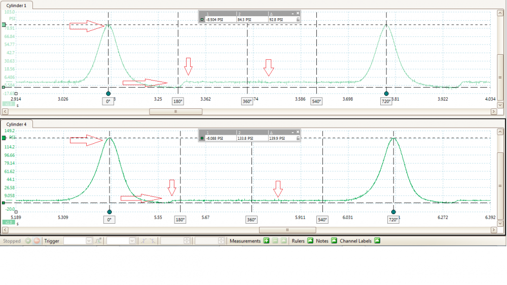

Next, I did a relative compression test along with intake and exhaust pulse waveforms

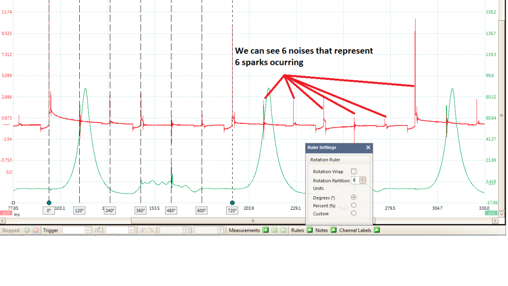

10 years 3 months ago #393 by GeorG

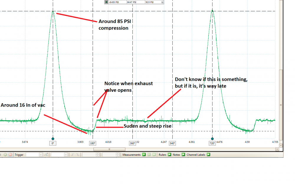

It's starting to look like bank 1 timing is off, so I use an In-cylinder pressure transducer to TRY to see something (even tough I'm not ANY good at it).

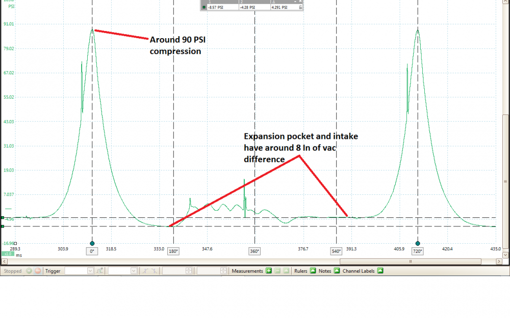

10 years 3 months ago #394 by GeorG
I,m not sure but I think I shouldn't have that much vacuum cranking, right?

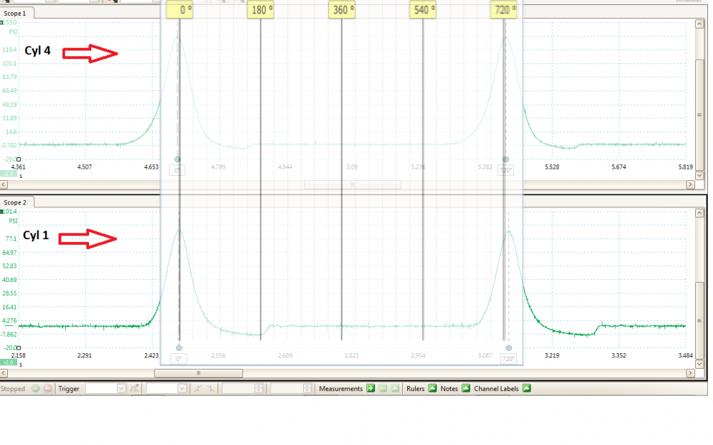

10 years 3 months ago #396 by GeorG

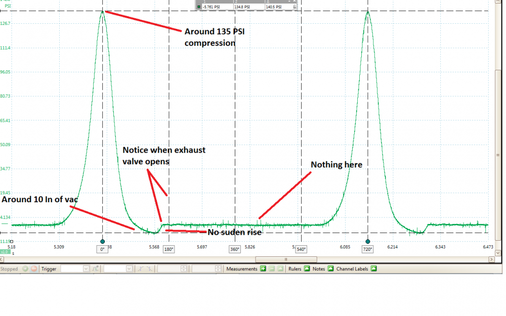

I could only do the bank 1 In-cylinder pressure transducer,because when I tried to do it on a contributing cylinder, the car obviously would not start (4 cyl not contributing).
So here's cyl 1 running :

Ok so looking at your scope captures it's pretty obvious you have a compression problem on those cylinders from bank 1.
I think it would be a good thing to add some more waveforms/variables in order to call this a jumped timing chain or belt. Did some research and found a couple videos you might wanna take a look at. 2 are from ScannerDanner's free channel and 1 is from Pico.
Let us know what you think or if you have any further questions.

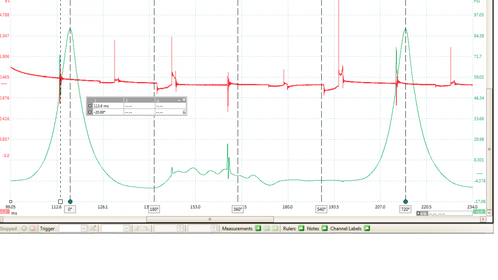

Dylan wrote: I think it would be a good thing to add some more waveforms/variables in order to call this a jumped timing chain or belt.
After watching the videos and reviewing my captures, I came to realize that spark is occurring at around 20 degrees before TDC.That's 9 or 10 degrees more advanced right?

And yet another clue, when we compare cam timing on a "known good" cranking cylinder vs a known bad one (cyl 1), they are night and day different.

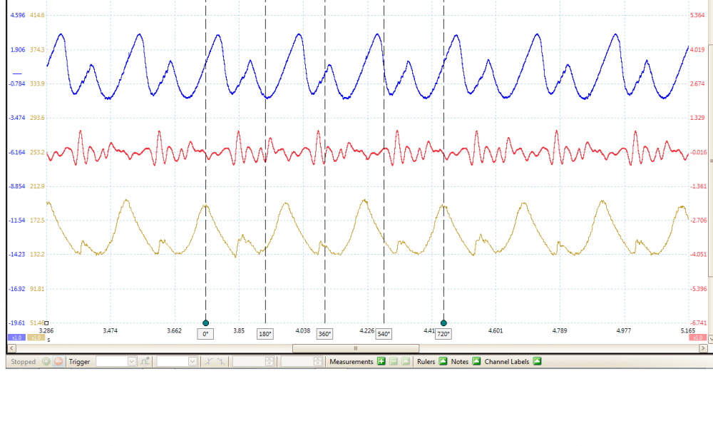

10 years 3 months ago #480 by GeorG
But what I would really like to be able to plug in is the intake and exhaust pulses.
Yes sir. Indeed, that's bad news.
Good idea. I was going to suggest that but you got there first. We can see that compression is lower on cylinder 1 and that there's a difference when the exhaust valve opens.
I'll take a closer look when I'm on my laptop. But I agree it's quite interesting. We'll figure it out. If my colleagues read this they might also chime in.

To say that i'm a novice when it comes to in cylinder capture would be an OVERstatement. I've never employed this test in a diagnosis, and can glean very little from those capture. That's really why I was hesitant to add my opinion to this post, and still am...

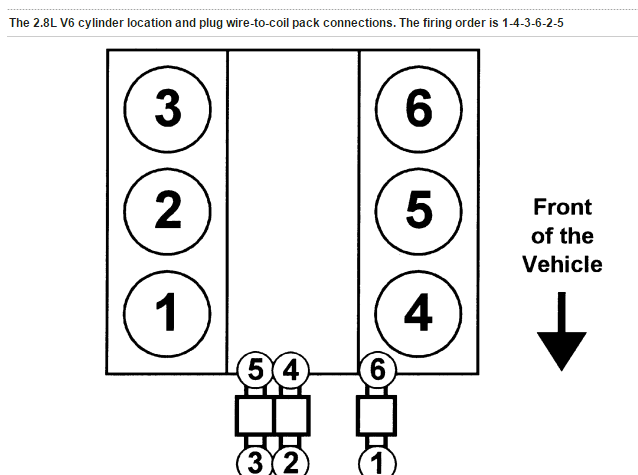

Based on the intake pulses, the relative compression test and the firing order, coupled with the advanced spark timing on the effected cylinders, I think it's safe to say that bank one timing is off.

Let me know if I'm wrong, but I'm seeing retarded exhaust AND intake timing on bank one. I can't do measurements on the images, of course, but it seems to be around 20-30 degrees.
Both cams being out of time makes sense on this design, since the timing belt only drives one cam per bank, and a chain is used to connect between cams. I've never done one of these belts, but it doesn't look like a walk in the park.

Tyler wrote: Let me know if I'm wrong, but I'm seeing retarded exhaust AND intake timing on bank one. I can't do measurements on the images, of course, but it seems to be around 20-30 degrees.
I'm thinking more like 50 degrees if the exhaust cam should open around 30 degrees BTDC, but I could be wrong, maybe someone with more knowledge than me could explain to us. ;)
