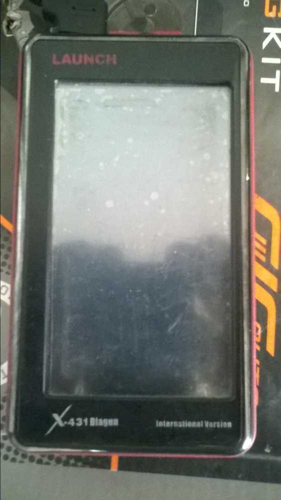

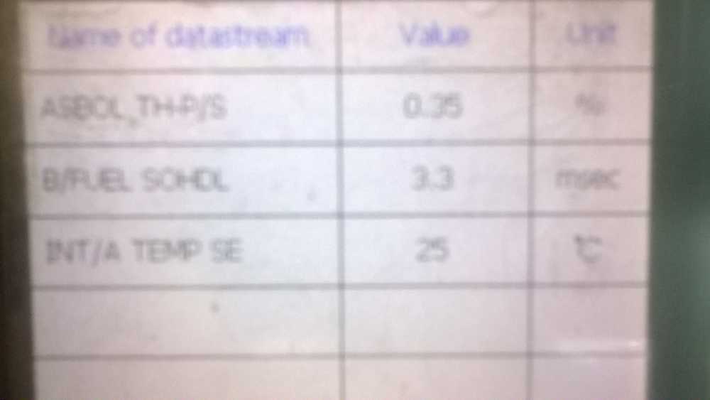

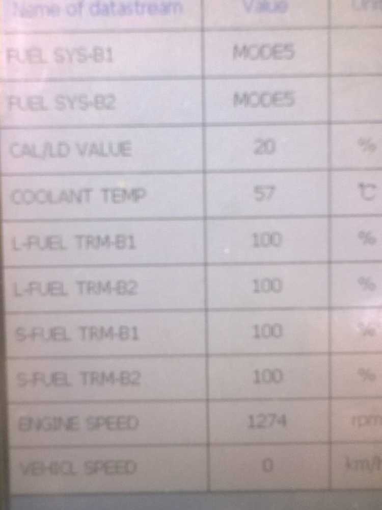

06 Maxima codes p0300 ,p1800 and p0011 where to start here is the freeze frame.
This is what i have to work with thank you for your help.

Hey Cheryl thank you for your quick respond, my scanner only has live data and timing fluctuates between 8 degrees to 18 BTDC.

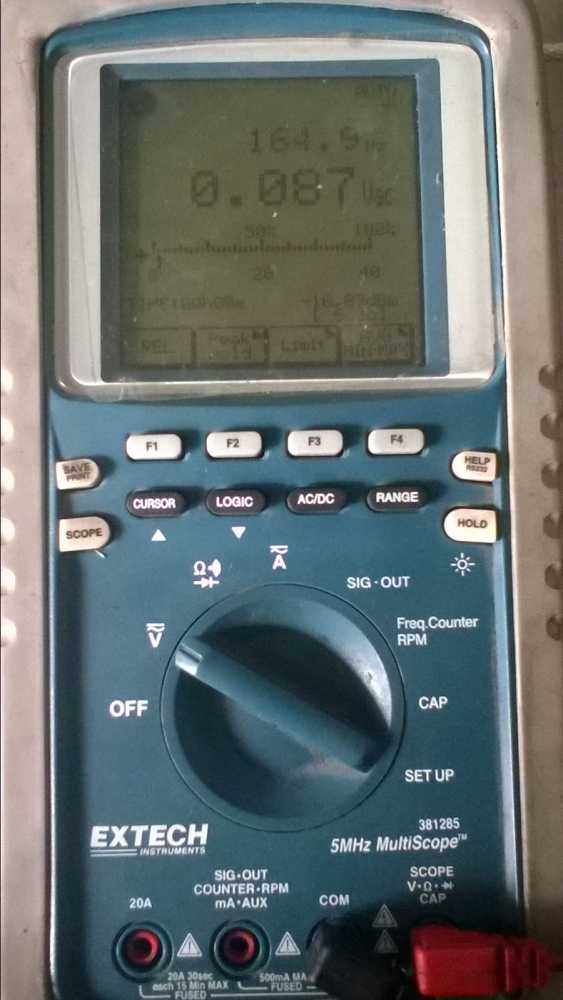

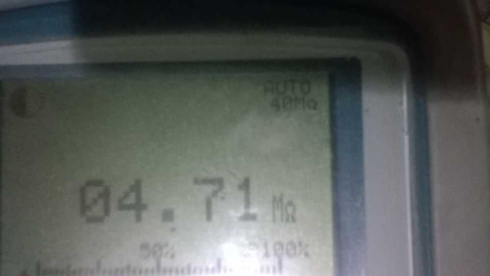

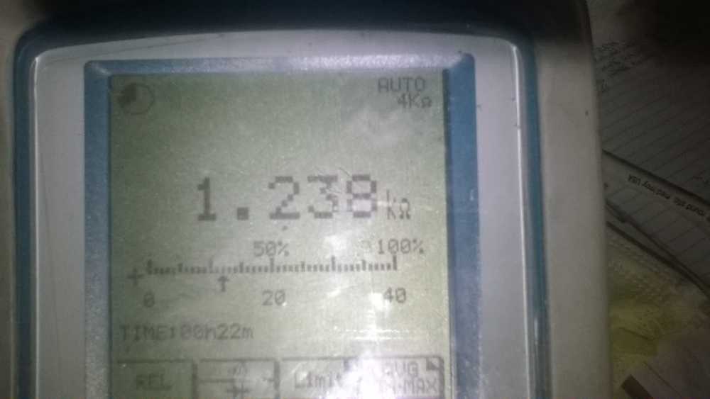

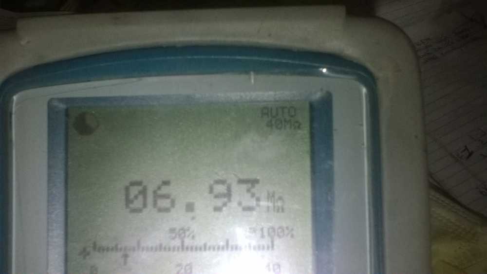

9 years 9 months ago #4849 by gilbert
Replied by gilbert on topic 06 nissan maxima

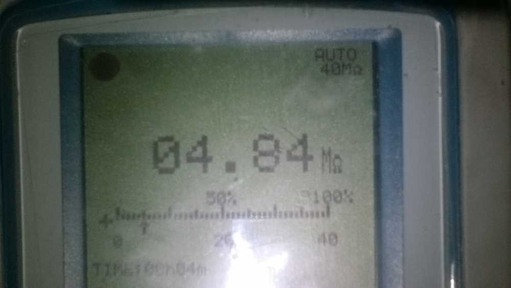

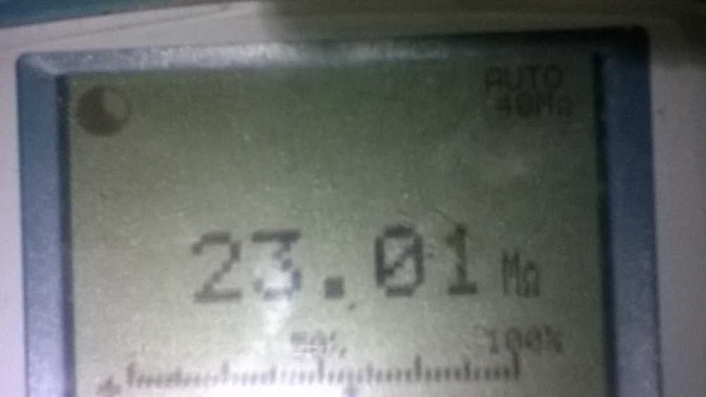

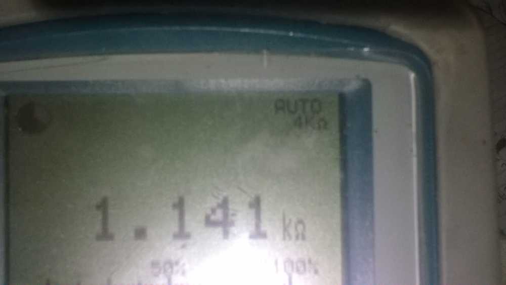

OK so i took off the valve and it was clean, so i put power and ground and valve opened and closed. Next i took off both cam sensors to check the resistance. On bank 1 pins 1&3 i get (04.71)m-oms pins 1&2(1.238) K-oms and pins 2&3(04.84) m-oms. Bank 2 pins 1&3 (06.93) m-oms pins 1&2 (1.141) k-oms and on pins 2&3 (23.01)m-oms. I read somewhere that as long as you get a reading it's good please let me know if they are good.
Hey Tyler on the p1800 code will this cause a misfire ?
9 years 9 months ago #4860 by Tyler
Replied by Tyler on topic 06 nissan maxima
Negative, sir. That P1800 may cause a slight loss of performance off idle, but won't cause misfires.
Ohming these kind of Hall effect sensors is tricky... Those readings seem OK, but I really don't have a good reference!
If you have the chance, maybe clear the codes and see if you can get the misfire or timing code to reset. I'm betting that you'll see a lack of camshaft advance on one bank while cruising with the engine warm.
