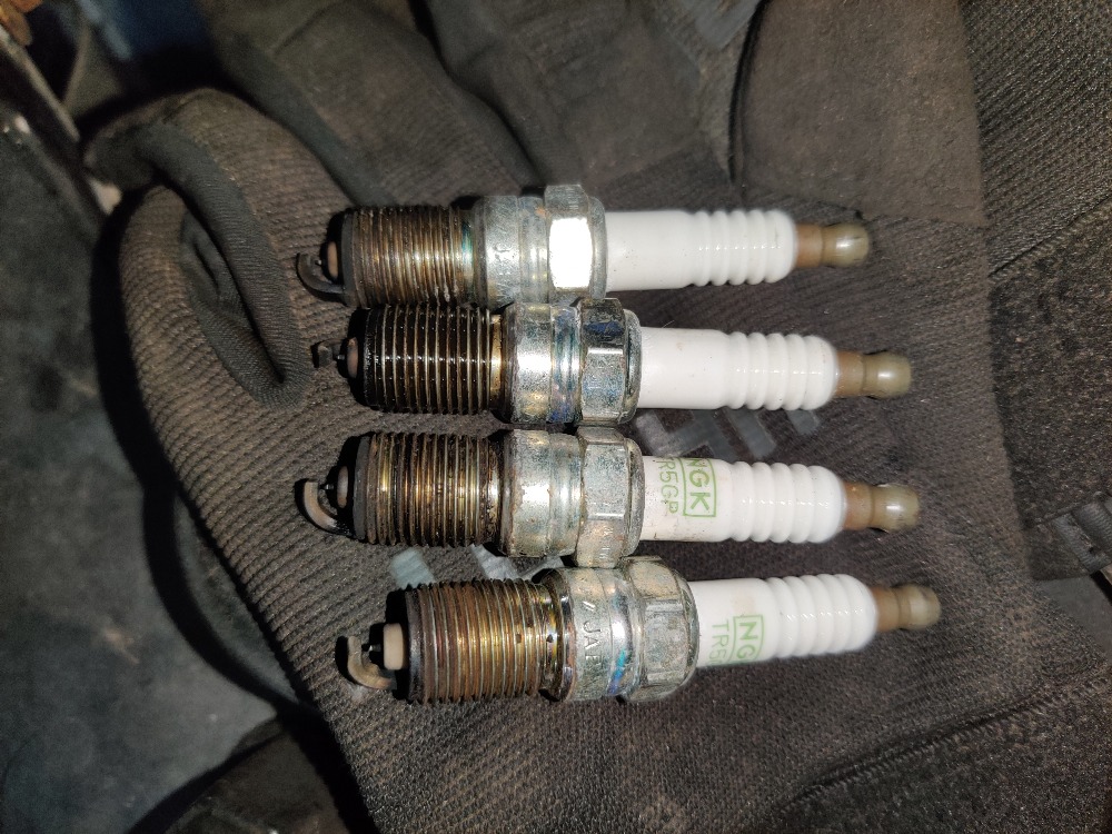

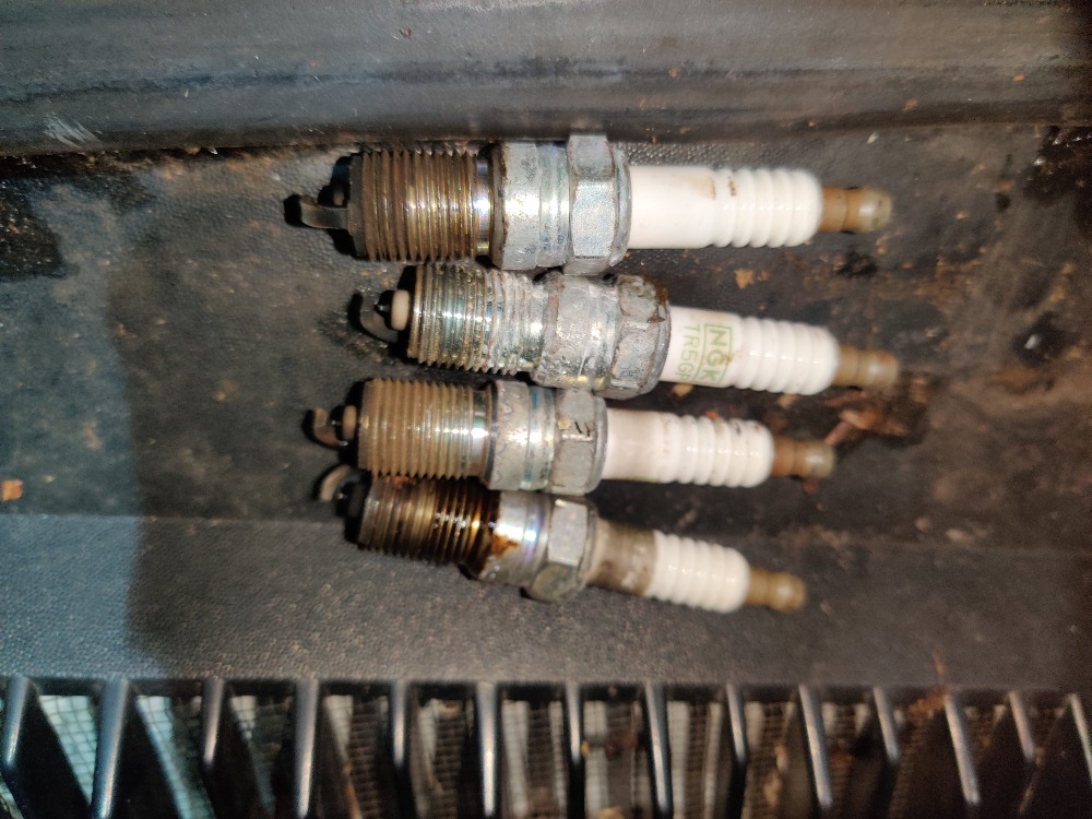

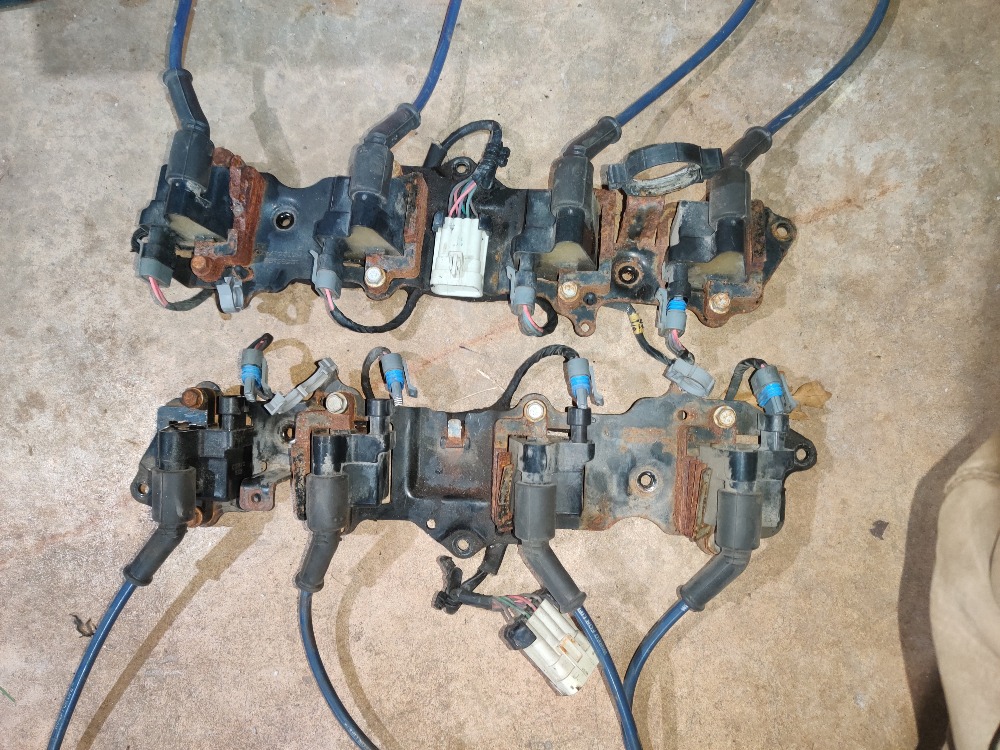

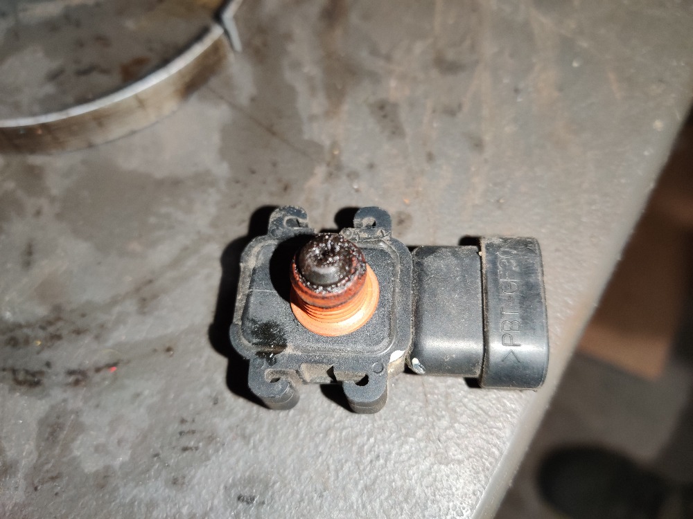

I'll try and come up with a way to do injector balance.
I have pictures of coil packs and Map.
Will be changing both because used parts are very available for next to nothing for me.
New plugs too. anybody have recommendation for what plugs in the 6.0
The long crank was already present at times.
Long as is in 6sec. I think only on cold days.
Dies right away. Second crank is instantly running.
Warm days will be 3 sec.
- Dothedew92
- Posts: 16
6 years 10 months ago #36261
by Dothedew92
Replied by Dothedew92 on topic PCV with no valve/ball? Gmc 6.0 2002 HIGH LTFT
Plugs, coils, Map.
