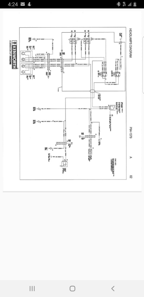

This is the only diagram I have recieved from the dealer.

Replied by Darrel on topic This was a diagram I found online but says it for a 2003. But so far matches wir

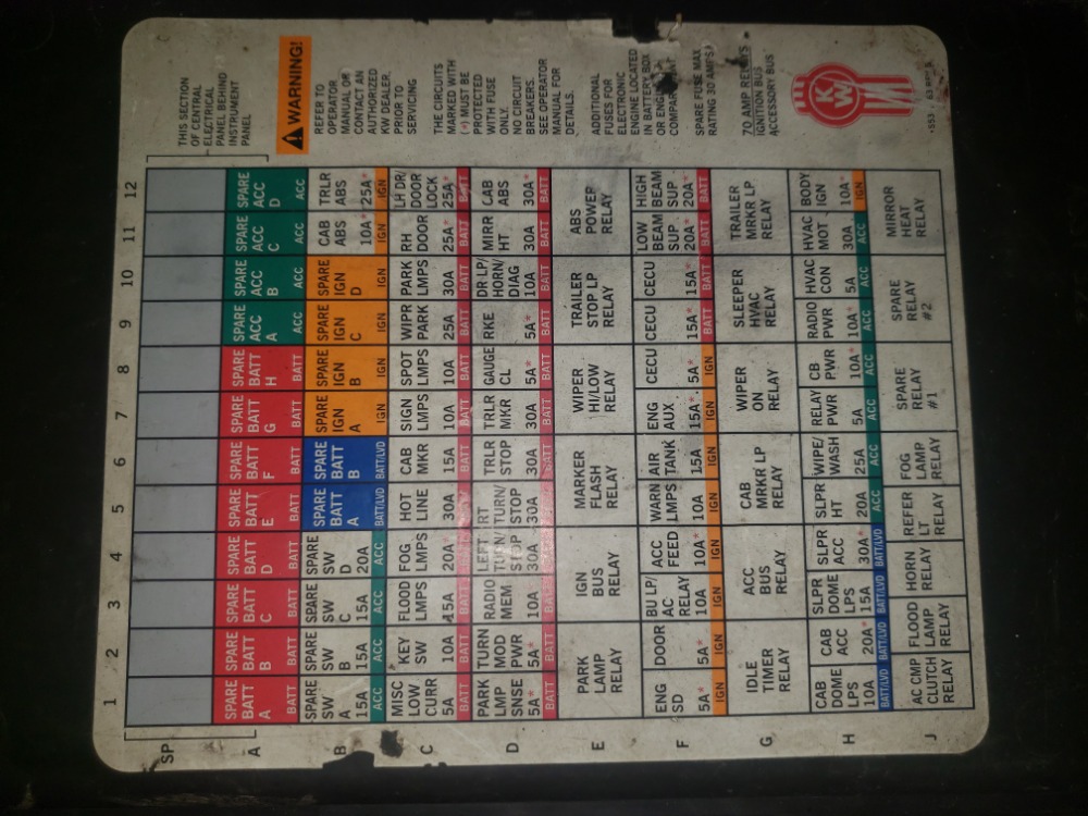

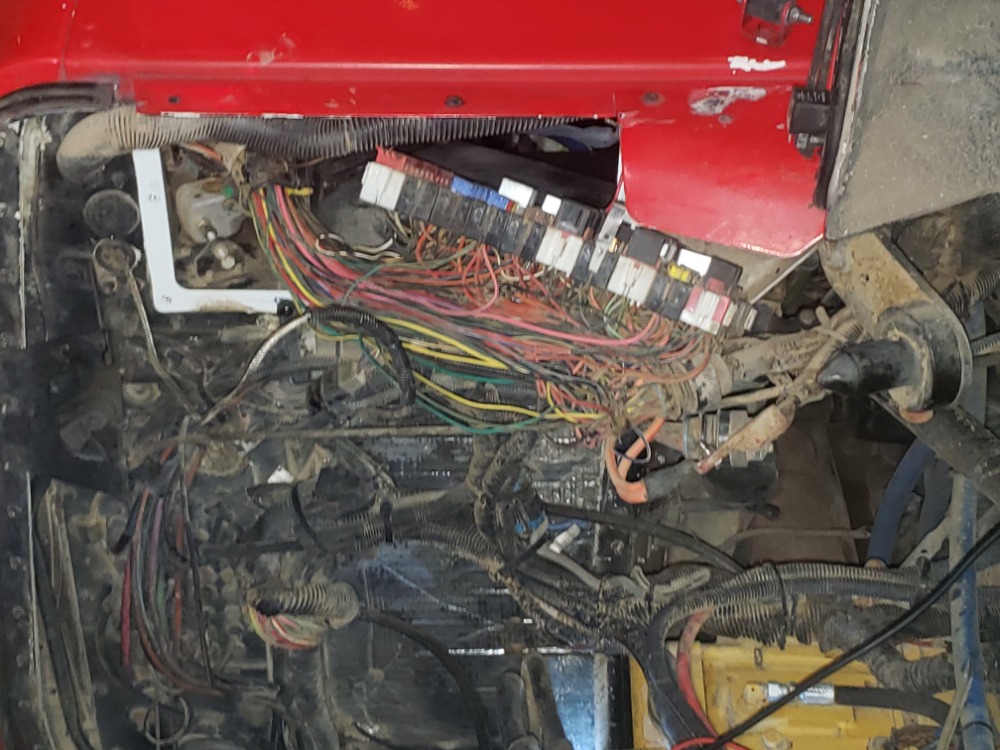

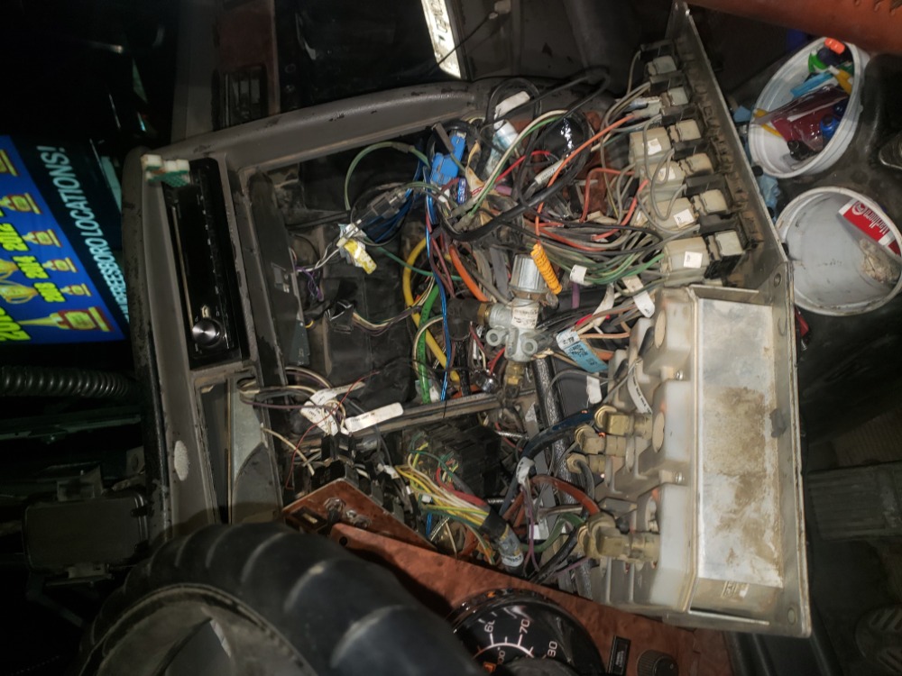

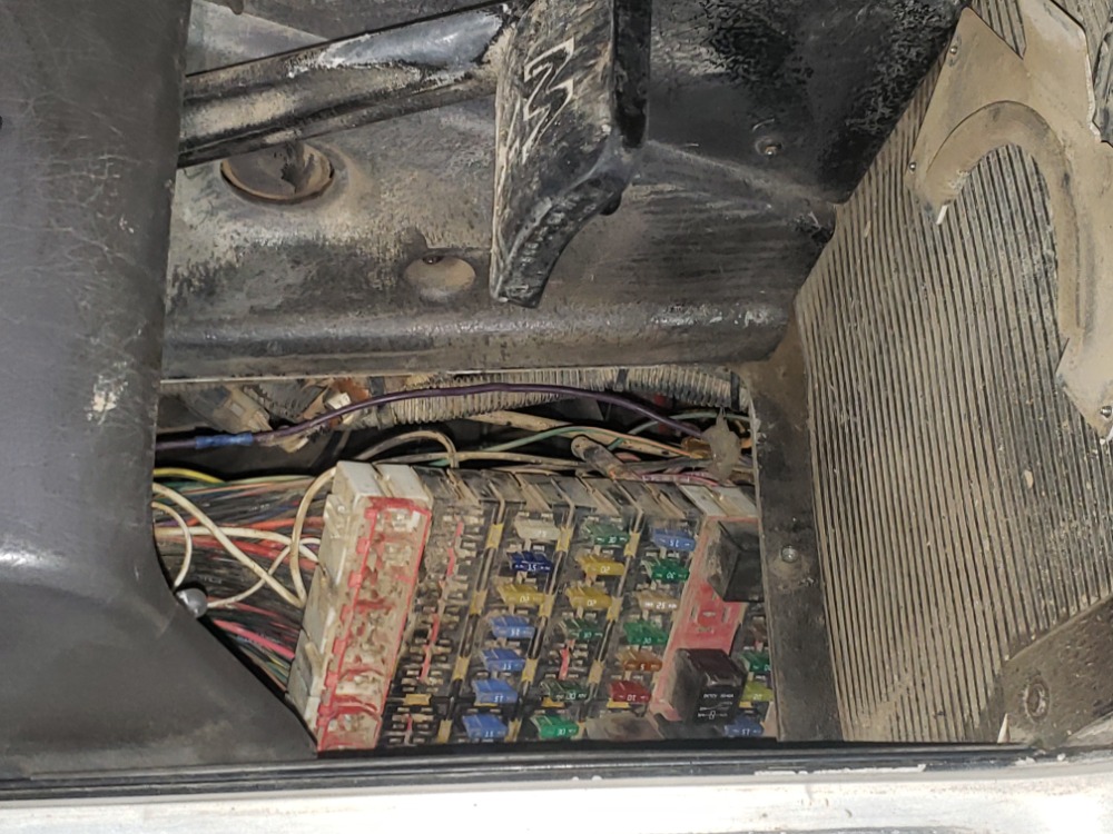

I thank you for your help. I'm a new sub. Hopefully one day I'll be able to help someone also. I have not been able to find the head lamp relay. Dealership said that all of the fuses and relays are in this panel I just posted. But I actually found a set of 4 relays buried behind the dash but aren't labeled. They are in the wiring diagram. The one I pulled has yellow and black wires going to it.

Because of the low resolution I can not decipher the diagram. Post the original wiring diagram instead of a screenshot, if you have access to it....
The fusebox sticker actually mentions "this section of electrical panel behind instrument panel", referring to the first 2 rows labeled "SP" and "A". There might be more to it.
