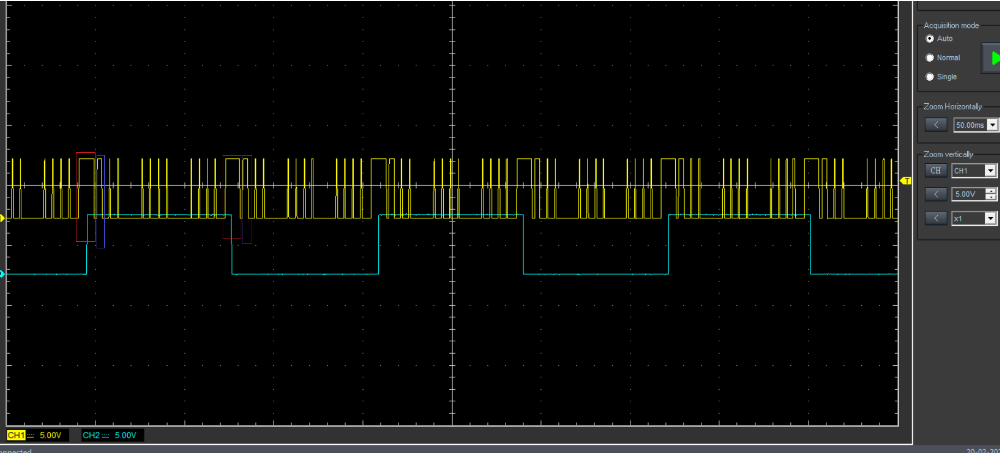

I'm trying to catch some irritating misfire that seems to be at random moments but is mostly present on idle. When engine is cold ( eg has been sitting for 4-5 hours on cold weather) car will start but it will hesitate and buck randomly a couple of times for a minute or two until it warms up (I'm not sure if this is related to going into closed loop). Car drives fine after that but slight to mild misfire is present when idling, and it is not really consistent when it comes to frequency.
When I hook up PCM to my Snap On MT2500 there are no DTCs, all parameters seem to be normal except Fuel Trim which is 3 to 4% (max is 25% per snap on documentation). By looking at this I can conclude that the car is dumping more fuel. Could the reason for this be cylinder bore increase for .020 oversize pistons? IAT, MAP, CTS, TPS - they all seem to be valid. I can trigger injectors one at a time from MT2500 and test IAC.
I checked spark plugs and there are some oil (not fuel) deposits on one of them, but cleaning them doesn't change anything. I'm suspecting deposits came from valve stem seals since compression on each cylinder is 150psi which is maximum per manufacturer.
Fuel pressure test showed some 29-30 psi on idle. Per FSM, it should be 31. Maybe my gauge is not that accurate, but the reason why I don't suspect fuel pump or regulator is because there are no performance issues when it comes to driving this car.
I recently got oscilloscope, thinking this might be better thing to do than randomly replacing sensors. First thing I did - I tested crank and cam sensors. And here is what I got:
This pattern seems to be constant. I understand that there should be four equal peaks for each cylinder. This is definitely not a good CPS signal. I tried to adjust sensor, but no difference, pattern is constant. Should I suspect CPS sensor or flexplate? It could be that the flexplate got damaged while we were mounting transmission to the engine.
My concern is if this is the only issue. Could this disrupted signal cause huge mpg decrease, idle misfire and bucking when cold?
6 years 10 months ago #36331 by Tyler
Replied by Tyler on topic Jeep Wrangler 4.0 idle misfire and bad mpg
I would suspect a flexplate issue at first glance of your waveform. The big gap suggests a bent reluctor or metalurgy problem between two of the four pulse sets. The other problem is the wider second pulse out of four - kinda suggests someone used the CKP window as a pry point to turn the engine over. Not pointing fingers, just seen it before.
That said, I'm honestly surprised this truck runs as well as you say it does! :silly: It also looks like the distributor/CMP timing is slightly retarded, but that still isn't the issue.
I don't know what the increased displacement will do to the fuel calculation? But I wouldn't sweat the 3-4% fuel trim at all. Same with the fuel pressure. Find out why your CKP waveform is off first, then proceed further.

I'm not a mechanic and this is the first time I did complete rebuild. And you are absolutely correct. I remembered something and now I understand that using a flexplate for blocking the engine was not a good idea. I have spare one so I will drop the transmission and replace it.
As for the fuel trim, I thought that slight increase in displacement might require a bit longer injector pulse because of more oxygen being sucked inside cylinder.
Timing - both sprockets and timing chain are new, just like distributor. When I put distributor in, I remember that I could move it forth and back a bit, really not much, before fully tightening it. Could that be sufficient to cause this sort of signal? Camshaft is not new so there might be some slack between distributor and cam gear.
I guess that timing chain is not an issue for this since compression test showed maximum per FSM.
6 years 10 months ago #36351 by Tyler
Rutesic wrote: As for the fuel trim, I thought that slight increase in displacement might require a bit longer injector pulse because of more oxygen being sucked inside cylinder.
You're probably right? I honestly don't know! :silly: In my head, the PCM is basing the fuel calculation on the MAP sensor, and theoretically the vacuum level in the intake should be the same between the original displacement and where you're at now. Someone please correct me here.
Definitely. As you noticed, it's really not much, just enough to get the waveforms squared. You can do it live with the scope, but it's easier with the scanner if the function is available. I usually see it labeled 'Set SYNC Signal'. You hit the button, the PCM raises the idle to 1000 RPM, and you turn the distributor until the sync value is zero.
If that's not available, just move the distributor until the transition of the CMP is square in the middle of a low section on the CKP. Or as close as you can, anyway. :silly:

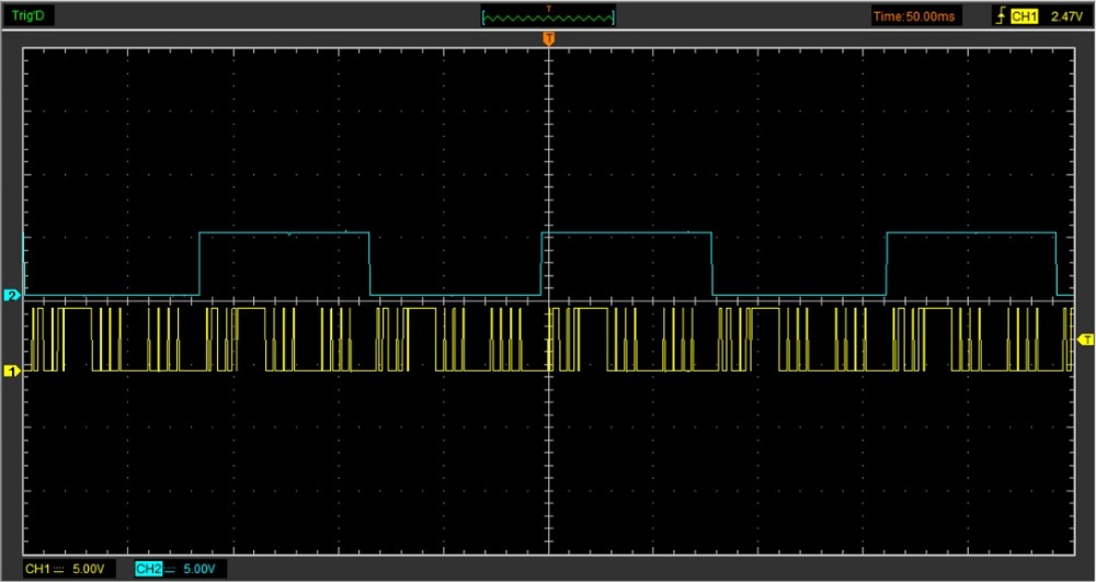

Ok, so here are the results.
I replaced the flexplate. New one is correct part number, made by ATP. Seemed to have reluctor windows on same locations as original one. I reinstalled same CPS.
What happens now is that I have the same pattern, but it moved one group to the left. But pattern is the same, one a bit longer window and later huge one. Car hesistates around 2000 rpm. I don't think that this is flexplate related now since the patern is exactly the same.
Can this be somehow related to torque converter? Like it is bent or something? Or can I blame CPS sensor for this? I installed spacer but I'm not sure if it is correct size

6 years 8 months ago - 6 years 8 months ago #37696 by Rutesic
Replied by Rutesic on topic Jeep Wrangler 4.0 idle misfire and bad mpg
Here is the new waveform. Again it seems to be incorrect.

Thanks Ruben, however as per documentation this waveform is incorrect. I got this with car running on almost constant rpm when it's hot. It should have groups of four per each cylinder, each of equal length
6 years 8 months ago - 6 years 8 months ago #37773 by hakachukai
Replied by hakachukai on topic Jeep Wrangler 4.0 idle misfire and bad mpg
According to your signal and the chart posted by Tyler, after the new flex plate was installed it is happening:
between cylinder 5 TDC and 3 TDC
between cylinder 2 TDC and 4 TDC
Is it possible to rotate the engine over by hand until you get to that extra wide malfunction in the wave form, remove the sensor then take a look at what is near it?
Maybe it's the reluctor teeth ( but doubtful since you just replaced the flex plate )
Maybe the grooves and the sensor are both fine, but some other piece of metal is coming near the sensor.
Maybe something down there became magnetized ( which you of course could not ever visually see ) and is affecting the sensor.
Did you visually inspect the reluctor teeth when you installed it? Are they all exactly the same thickness and shape?
Do they all have the exact same gap between them?
I don't work on Jeeps ( yet ), so I don't know how hard this would be.
I also noticed on closer examination of the wave form that all of the lower or bottom parts of the wave form look correct, but something seems to be forcing it to the high state at certain times.
Maybe a wire or plug is rubbing on something that is shorting it to power somewhere? I don't know what would cause it to happen at an interval that regularly... but something must be causing it.
It also now seems to happen right when the cam signal switches. Is it possible to run the engine with the cam sensor unplugged to see if the cam sensor signal is somehow crossing over into the crank signal?

I will try to turn the engine by hand and check if this error still appears. However, it could be that it doesn't pick up signal only when it's turning fast.
I can run car without cam sensor once it fires up, so I will try that one to. They share the same ground and reference signal from PCM, so this could be an option too. However, I doubt a bit since in previous waveform (before replacing flexplate) that glitch was outside of cam sensor switch

6 years 8 months ago - 6 years 8 months ago #37859 by Rutesic
Ok, so this is driving me insane now.
I bought new NTK crank sensor. Now I have three crank sensors. Those sensors are held with one bolt and should come with paper spacer for air gap adjustment. Two of them give the same pattern like I posted above after flexplate replacement. Doesn't matter if I do any adjustments. Those two are some cheaper aftermarket ones. I doubt they are bad since they give exactly the same waveform.
If I push new NTK CPS all the way down in the hole, keep it pressed and hand-tighten it, it works. On idle waveform is perfect. Sometimes it will backfire above 3500 and I'm seeing that some peaks are missing from the waveform or some of them are too long, but this is completely random. Real problem comes if I tighten it with wrench it instantly starts running like crap. (it is not hitting flexplate at that point). What the hell could this be?

6 years 8 months ago #37888 by hakachukai
Can you show us these 4 wave forms:
  1. Crank vs Cam with it hand tightened
  2. Crank vs Cam with it wrench tightened
  3. Crank vs Cam with it hand tightened with cam sensor unplugged
  4. Crank vs Cam with it wrench tightened with cam sensor unplugged
This will tell you exactly what is going with that sensor.

6 years 8 months ago - 6 years 8 months ago #38065 by Rutesic
hakachukai wrote: Can you show us these 4 wave forms:
I did this test. Waveform doesn't change with cam sensor unplugged at all. This is how it looks no matter cam sensor being unplugged (I tested with multiple crank sensors. .
Since I have FOUR crank sensors, I did a little test. I noticed that hole on NTK sensors is positioned too low, so I drilled it a bit. By doing this I can adjust the air gap between sensor and flexplate. I pushed it all the way down I could and still it isn't touching flex plate when tightened. After doing this waveform looks much better. The glitch that is marked red disappeared, that peak is perfect now. However the one marked with blue color is still there.. It is not as wide as in this picture but it is a bit wider than all the others (maybe twice the normal one).
Since all crank sensors give same signal, and drilled one gives better, my guess is that this flex plate is bad (probably out of round) and only by decreasing air gap sensor is able to pick it up correctly. If flex plate was ok, then all of them should be able to give proper waveform. One more reason to suspect this is because on original flex plate (which was definitely bent by me) glitches looked completely different (image from first post).
Does this make any sense?
Last edit: 6 years 8 months ago by Rutesic.
