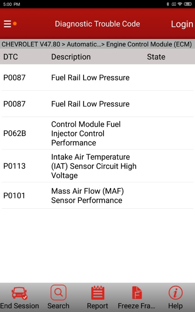

My Chevrolet Beat is cranking but not starting. I got four error codes, which are
P0087 - Low Rail Pressure
P062B - Control Module Fuel Injector Control Performance
P0113 - IAT Sensor Circuit High Voltage
P0101 - Mass Air Flow Sensor Performance
I had performance issues for month before going dead, wouldn't go beyond 50mph no matter how much I press the pedal.
As far as I have checked the rail pressure is low, not getting enough pressure from High pressure fuel pump, and also no power to the injector feed wire and earth wire.

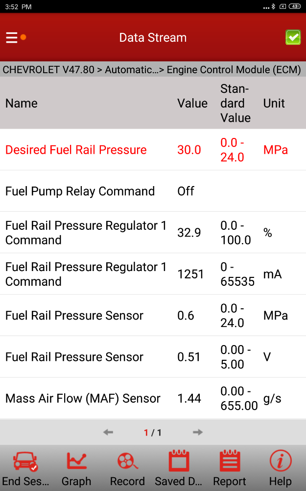

Non starts on disels are often due to low fuel rail pressure this can be due to excess I've leak back from an injector or pump fuel pressure r. egulatorIf the engine computer sees low fuel rail pressure below a minimal value I would think the engine computer won't even attempt to fire the injectors. As there is also a performance issue I would suspect the lack of fuel rail pressure is real rather than a faulty sensor or power & ground failure. I would start with an injector leak off test and electrical tests on the hp rail pressure sensor. I would also do cam and crank sensor checks. My feeling gut however is this is a fuel pressure regulator issue.

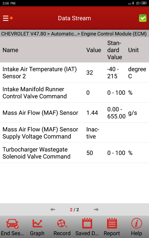

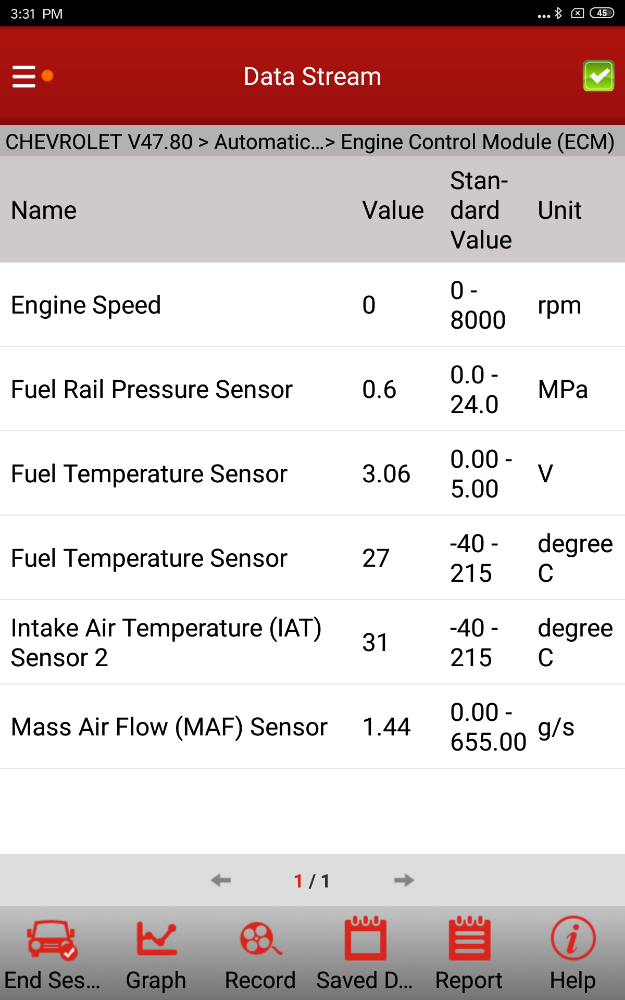

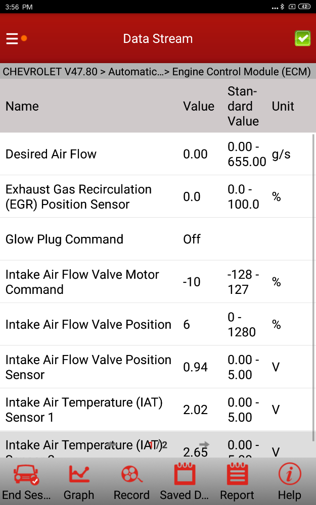

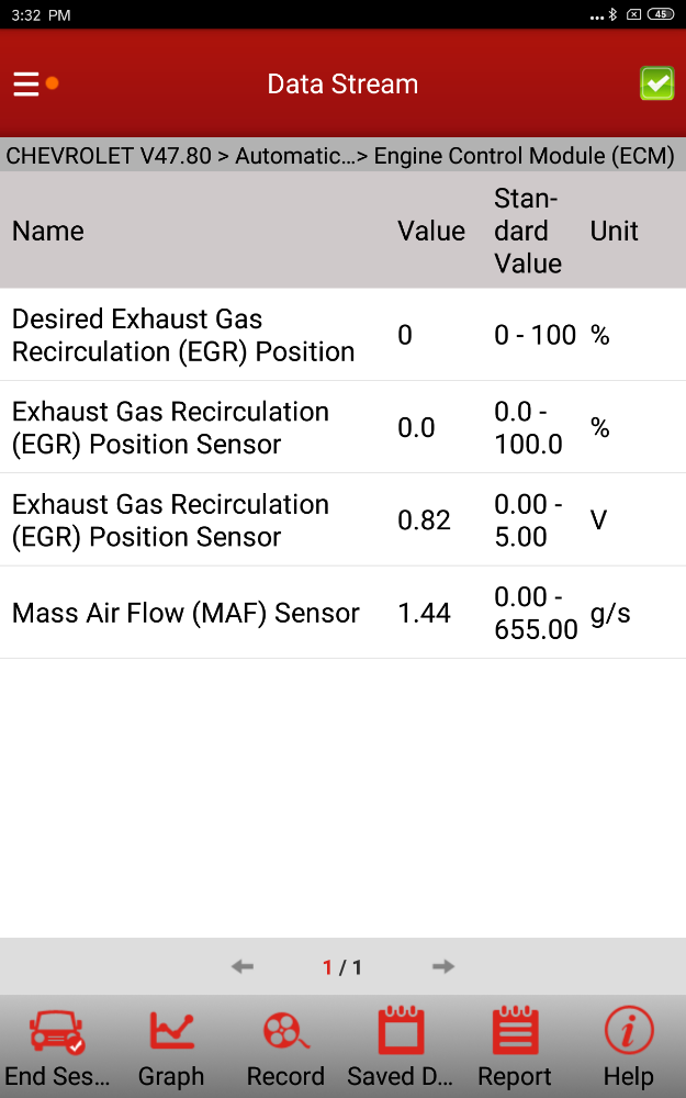

I have attached some screenshots of the data streem readings, maybe it could give some Clue
- gearup.garage
- Posts: 7
6 years 9 months ago #36465
by gearup.garage
Replied by gearup.garage on topic Cranking but No start
Why is that desired rail pressure value is out of range ?
