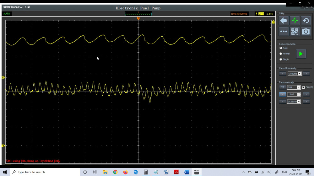

Replied by Cheryl on topic Nissan Xterra 2004 SC Stalls - Fuel pump current
When I scope fuel pumps I usually use 1 amp per 10 psi of fuel pressure. So I’d check power and ground at pump and call it. The amperage doesn’t seem low.

Replied by XterraVJ on topic Nissan Xterra 2004 SC Stalls - Fuel pump current
The pump is in the fuel tank attached to another connector(again within the tank). This connector is fed by an external connector which is beneath the rear passenger seat. I can't do voltage drop tests until I get the pump out. The vehicle stalls intermittently so trying to see.

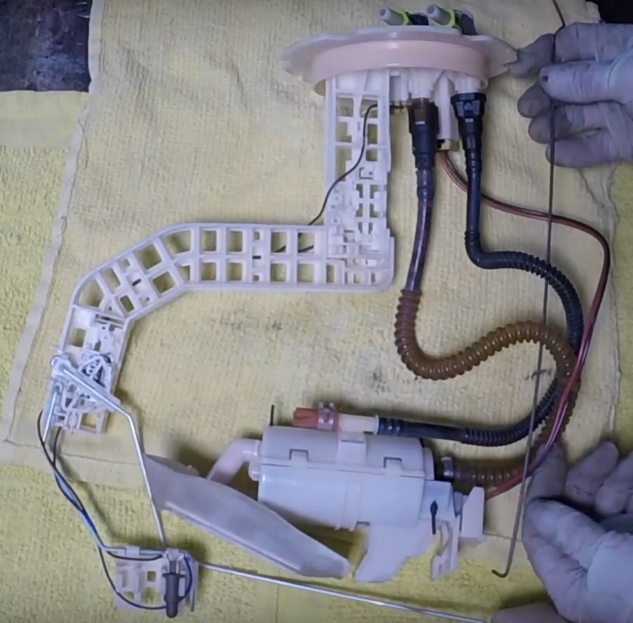

Thanks. No I am not.
As it's an intermittent issue, I can't say what goes bad - spark or fuel. Plus I have a P0181. The fuel sending unit houses the connector(in the tank) to the fuel pump plus also has the temp sensor(P0181) and fuel level sensor.(Pic added)
Chicken or egg problem here.
#1- If the pump is failing to deliver enough fuel and the engine stalls, the camshaft signal will not be produced and so the ECM will not activate the relay(+ there will be no spark) and the pump will stop. So here the Cam shaft signal goes Zero first(or the relay signal from ECM) and then the fuel pump current follows it to zero.
#2 - Other way is the pump current goes zero first(loose connection - simply disconnects) stalling the engine and then cam signal will go zero taking down .
spark(controlled by Cam signal).
