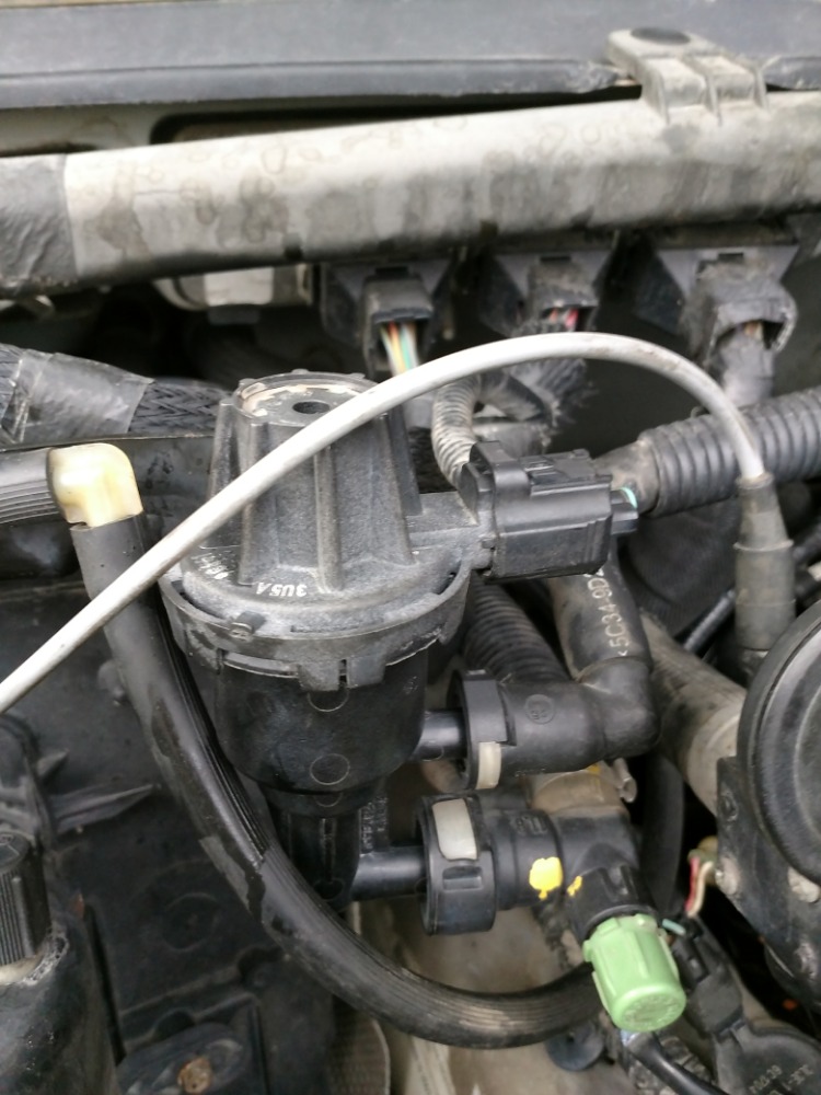

I don't know what to check on the DPFE selinoid. Is that the egr? I don't see what I would call an EGR. It is running better (smooth again). But after running the RPM up it just wants to die at idle. Is this the DPE selinoid.

6 years 7 months ago #36701 by MTROTR
Replied by MTROTR on topic 2007 F250 5.4 Baro reading?
  • MTROTR
  • MTROTR's Avatar Topic Author
6 years 7 months ago #36702 by MTROTR
i think this is DP solenoid but not sure how to check it?
6 years 7 months ago #36706 by Tyler
Replied by Tyler on topic 2007 F250 5.4 Baro reading?
That's the EVAP purge valve. That style almost never fails, in my experience. You can check it by disconnecting the vapor line (from the tank, the one with the green cap on it), unplug the solenoid and put your finger over the vapor port with the engine running. You should feel no vacuum.

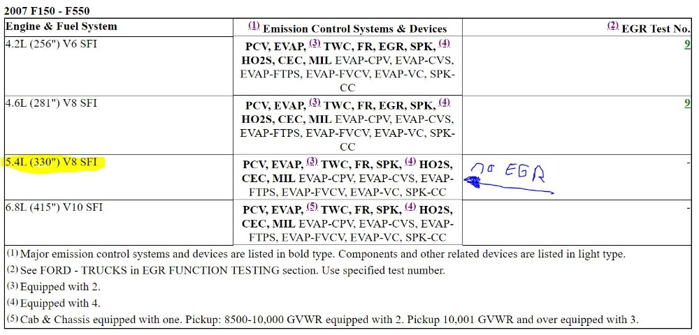

6 years 7 months ago #36716 by VegasJAK
Replied by VegasJAK on topic 2007 F250 5.4 Baro reading?
DPFE and EGR are related but are two different components. The EGR is attached to the intake and has a metal tube running from it to the exhaust manifold. Should have a vacuum line attached at the top. Unplug the vacuum line from the EGR. Should not have vacuum in the line at idle. If it does, the engine idle probably smoothed out when you unplugged it. The sensor that is attached to the EGR vacuum line is allowing vacuum at idle.

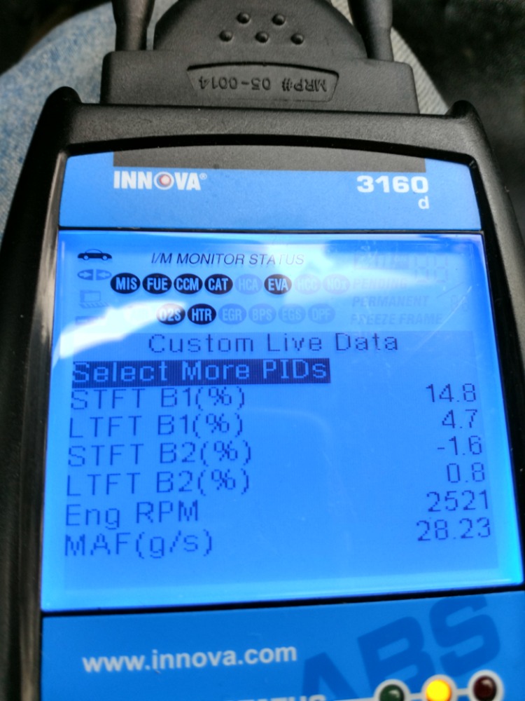

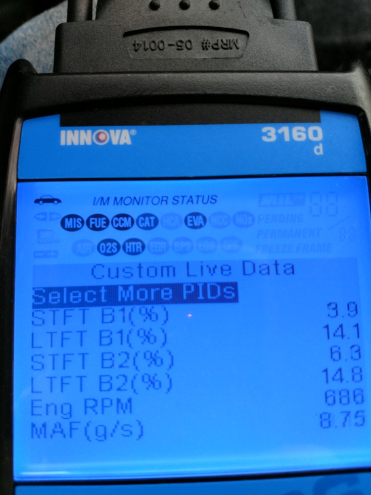

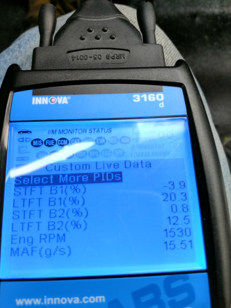

I really appreciate all the help. I am going out of the country on a mission trip and won't get back to this beast until February. In the meantime here are some pics of data. Cold idle 1500 and 2500.

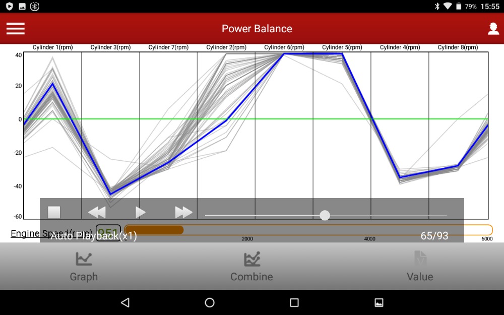

So I now have a better scanner and did a couple things. First relative compression test. and Power balance. #3 cyl shows -32% . cyl 4 and 8 were slightly low but not nearly as bad as cyl #3. power balance shows #3 cyl very low. no surprise. here is a screen shot.

6 years 6 months ago #37660 by juergen.scholl
Replied by juergen.scholl on topic 2007 F250 5.4 Baro reading?
Basically you're experiencing a #3 and#4 misfire, going by your picture at idle speed. What happens with elevated rpm and/or when you put a load on the engine?
Pulling the head is not a move I'd start with...there are multiple possible causes for the misfires.
Depending on your gear you might want to start with a leak down test, running/snap compression test,.look at the injector current etc. A vacuum gauge is a great tool to detect mechanical issues as well.

6 years 6 months ago #37667 by MTROTR
The picture of the power balance confirms the compression test. #3 cylinder is 32% low. The miss fire is the result of a compression problem. You can hear it when you crank the engine.

6 years 6 months ago #37716 by juergen.scholl
The cylinder balance test shows there is more than 1 bad cylinder....
Low compression can be caused by different things and a running and a snap throttle compression test will tell you cylinder-specific if there are any breathing issues..... Just do it and write down the results for static compression, running compression and snap throttle per cylinder....
