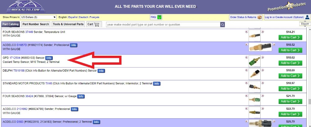

I'm wondering if that's a gauge sender. I found this item on RockAuto that seems to match your description:
I'm not saying you want to put a GPD sensor in your car. :silly: But that might get you pointed in the right direction.
The wiring diagrams are a little vague. The engine diagram only shows one ECT, and the instrumentation diagram shows a temp sender with only one wire.
As a fun test, you could measure voltage on both wires KOEO. Then, use a test light to short them together. If your coolant temp gauge now starts swinging hot, you know you're on the right track.

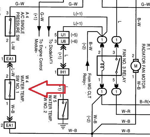

Dug around the wiring diagrams and found this:
Do the wire colors match? Blue/white and white/black.
Searching for a cooling fan switch takes you here on RockAuto:
www.rockauto.com/en/catalog/toyota,2000,...ator+fan+switch,4312

Thanks guys. I ordered both the GPD from rock auto as well as a beck arnely from amazon. The GPD had threads that were too small despite what the description said. But the Beck Arnley from Amazon is perfect. Thanks all for your help!
Pop
