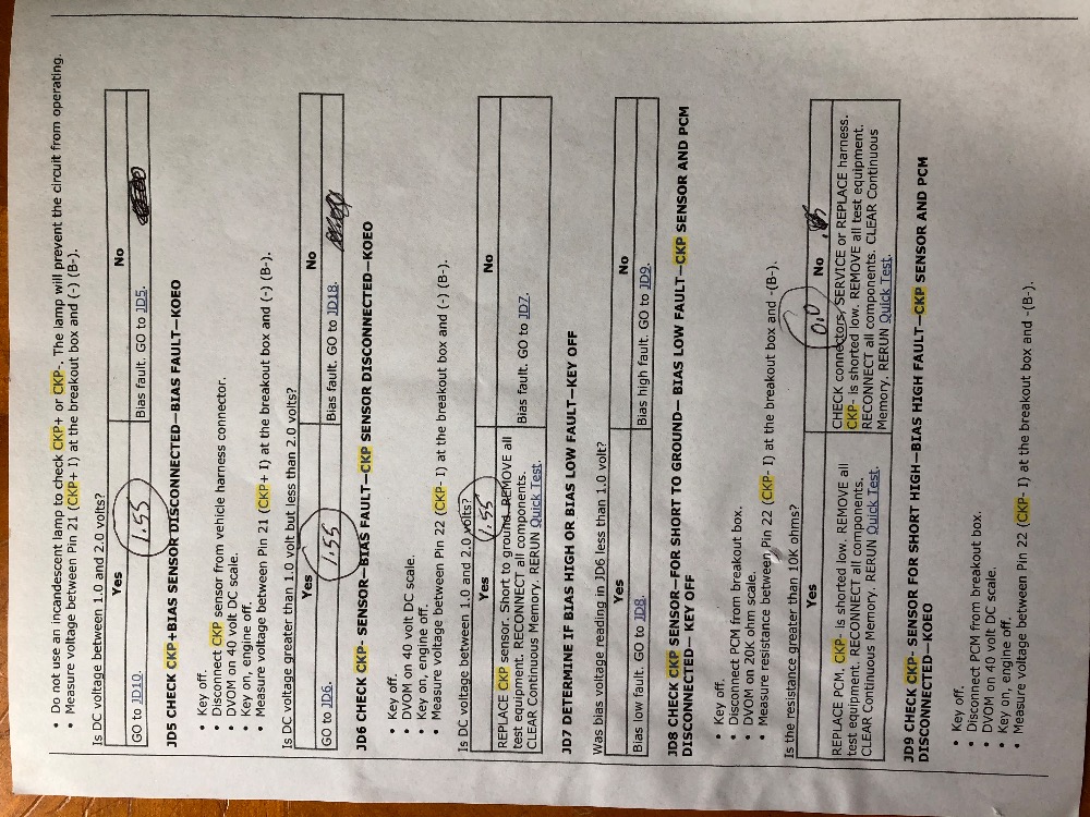

PCM pin 103 to B- has .6 ohms key off.
PCM pin 97 to B- has 12.1 volts key on.
CKP pin 21 to B- has 1.55 volts DC key on.
pins 21 & 22 at PCM -has .5 AC volts while cranking.
CKP at sensor - .5 AC volts while cranking.
CKP at sensor - 660 ohms resistance.
Tone ring visual inspection looks normal.

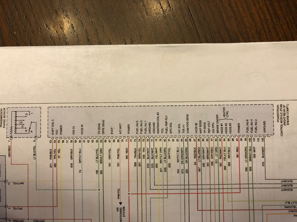

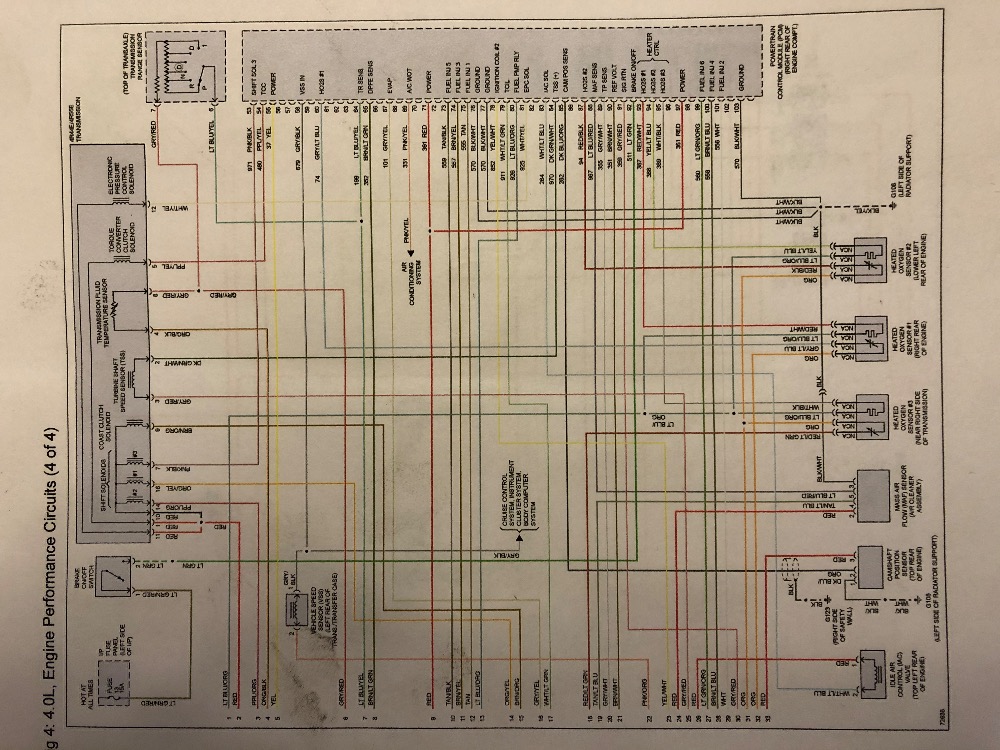

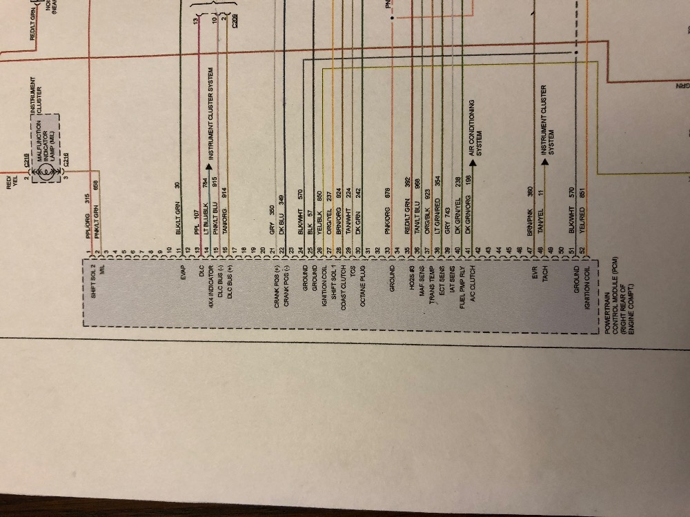

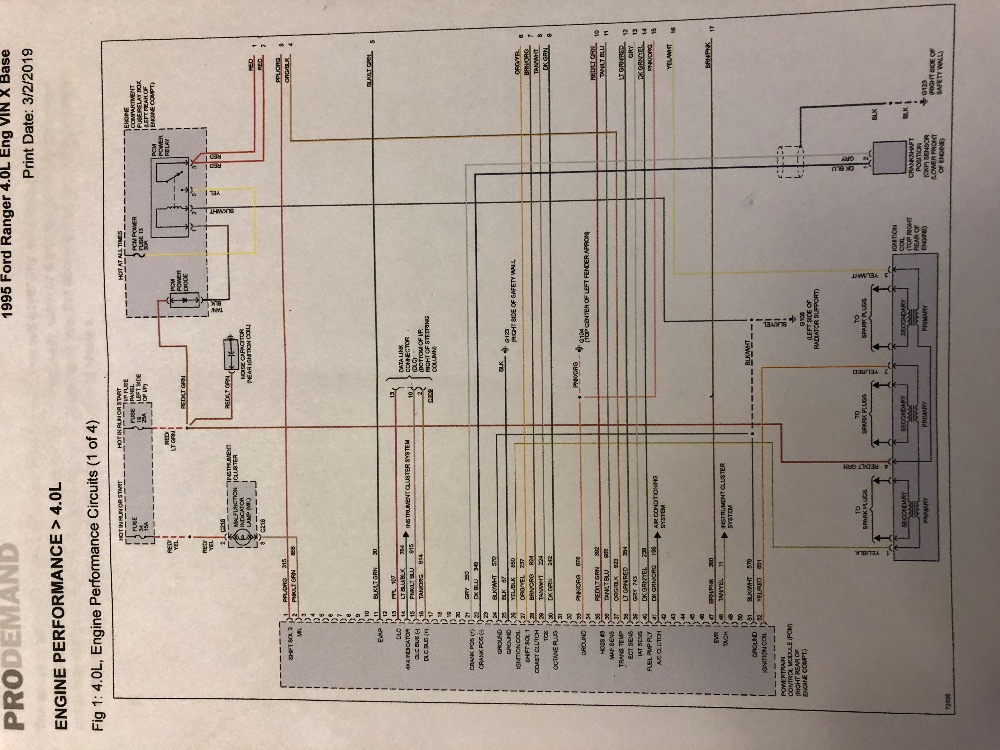

I’m attaching a picture of the PCM pin assignments, and have a couple of questions. I see the pins labeled power 97,71,55. I also see pin 90 labeled reference volt. Should all three power pins light a bulb with the ground pin 103? Sorry, like I said, electrical is not a strong point for me.
Last edit: 6 years 9 months ago by kvforte.
  • kvforte
  • kvforte's Avatar Topic Author
6 years 9 months ago #36758 by kvforte
Replied by kvforte on topic 1995 Ford Ranger 4.0 V6, XLT 4x4- no spark
After some testing today. I do have 5V on the reference voltage pin back probing the PCM with key on. I also checked all power and grounds pins as labeled on the PCM chart, they all check out good and will light a test bulb. I have 11.5V with key on at red wire on coil pack. I assume the other three wires at coil pack harness are grounds that the PCM used to fire the coil. When testing each of these along with the battery positive, the test bulb will only light up very dim. Is this correct?

Also, just for good measure I tested the crankshaft sensor signal again. Got .4 AC volts at the sensor and at the PCM while cranking. Is this enough signal to tell the PCM to fire the coil?
6 years 9 months ago - 6 years 9 months ago #36788 by Noah
The pcm will give the coil control circuits ground as it is triggered. So there should be 12v on all of the wires key on engine off, coil plug connected. Try a volt meter instead of the test light.
I'm not sure about the test light for that test, doesn't sound right. I would think that it should not light at all, but I suppose it could be finding a ground path through the pcm?
As far as .4vAC on the crank sensor, I think that should be sufficient. I've never checked one with a meter, but according to the Engine Performance and Diagnostics book: pg15 21-8,
"Amplitude must be a minimum of +/- 500mv for the AD converter to "see" the signal."
So your .4v (400mv) is course enough for me to think it's working, remembering that a voltmeter gives you an average reading. So at an average of 400mv, I would assume that when viewed on the scope that the signal is likely crossing that 500mv threshold.
