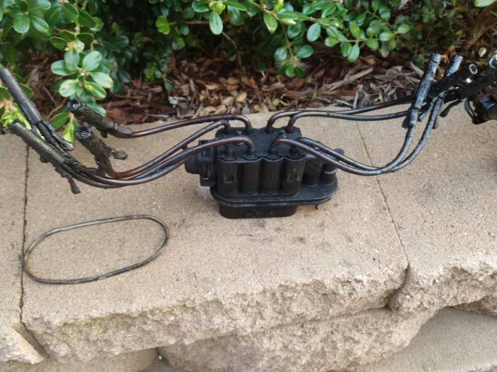

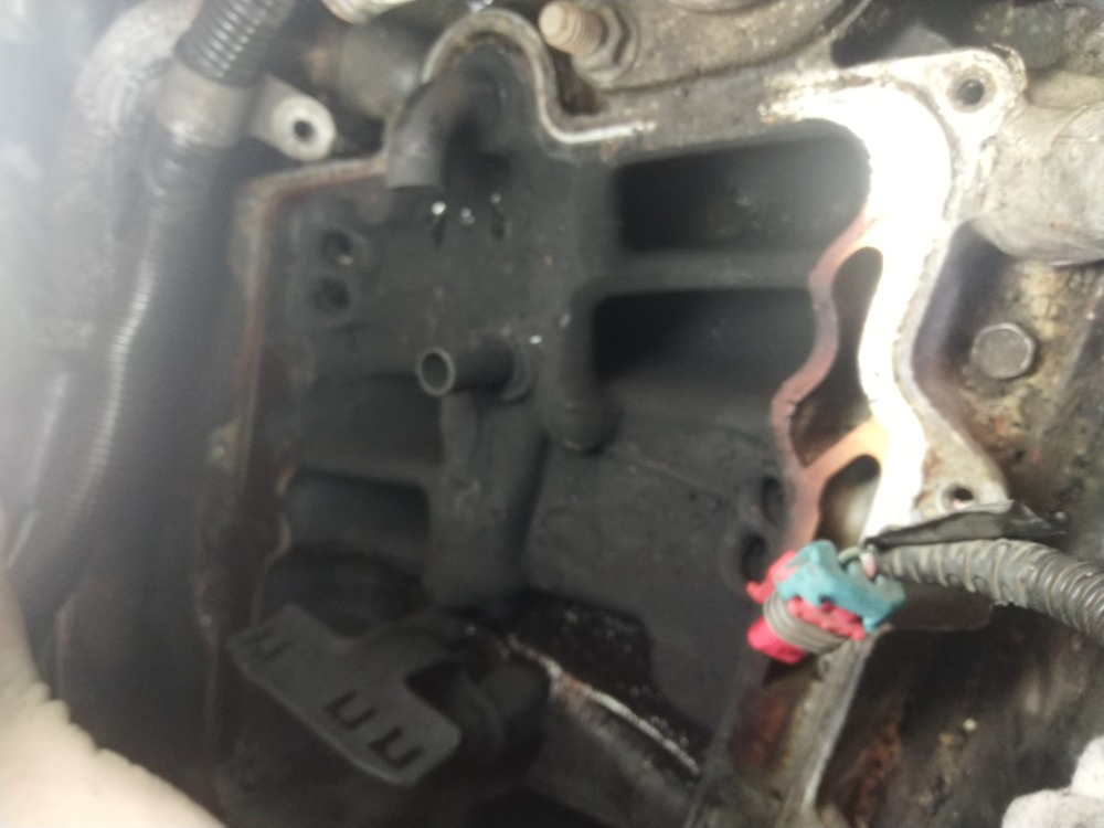

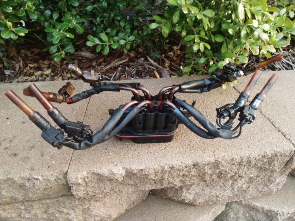

Yes it was taken at idle, I pulled the intake manifold. Lots of carbon buildup on top of the plenum. I also picked up a updaated spider injector from junk yard. Im going to swap the old one out and replace the gaskets.

Like Stioc said, the ecm is seing a lean condition and adding fuel because of that.
I suggest you to stay focuse on it.
I would start with O2 sensor activity (just to verify ecm is seing the truth)
