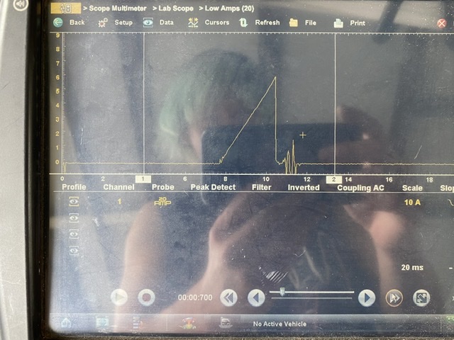

I am working on a 98 Factory spec twin turbo RX7, I am experiencing a flat spot and hesistation off idle and snap throttle. If I snap the throttle fast it will backfire and engine will bog.

-carried primary current ramp test on the leading coil( the leading coil is a waste spark system that’s does 95% of the work on both rotors)
Here my my findings (attached)
The tail oscillation is a bit different on a few snaps and I have managed to capture it. Not sure if it’s normal?
How can I determine whether this is a rich or lean misfire? When I pulled the plugs they certainly didn’t look too carboned or too white.

You're gonna have to work with me a bit here. :silly: The only rotary experience I have is from a couple US market RX-8's.
The snap throttle bog and backfire screams lean to me. You won't be able to see a lean condition in the primary current ramp, but you'll likely be able to see it in a primary voltage or secondary voltage trace. If you're interested, it's pretty straightforward to make your own secondary ignition probe:
www.scannerdanner.com/forum/lab-scope-di...need-to-buy-one.html
Is this a speed density or MAF system? If MAF, that'd be my prime suspect.

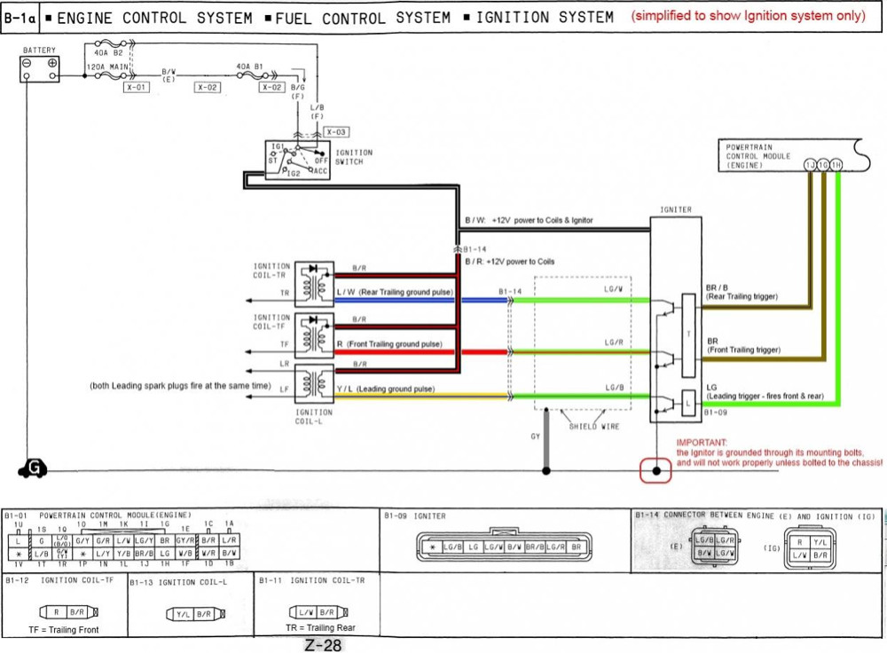

This car uses a map system, I have tested the map sensor with a vacumn/pressure gun . It is within specs. The owner has tried a known good sensor as well. No improvement.
Slightly different ignition circuit to rx8 (individual coils). This system uses a leading that companion and fires both lower plugs , and a trailing coil for each trailing of their respective housings. I have added a schematic for better understanding.
I don’t have a secondary probe, the article above is a little confusing (I don’t think I quite understand how to set up the alligator clamp up to be able to read it) unless you can help me along, happy to try and learn!
I can try pull a primary meanwhile, in theory it should pretty much be a mirror image as the secondary right? What should I be looking for? Is there glitches that I can only catch in a secondary pattern that I won’t be able to capture in a primary voltage pattern?
