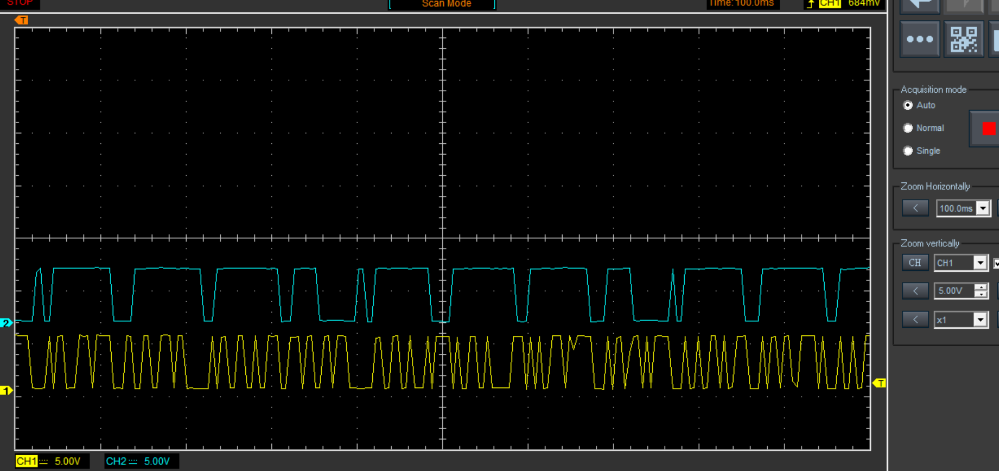

Here is my cam crank on the scope, i dont have a know good one so cant say that this is good or not
- derekoliveira
- Posts: 72
6 years 8 months ago #37772
by derekoliveira
Replied by derekoliveira on topic Camshaft Position Sensor issue, 08 VW Passat 2.0 TDI BRM
It does not look a very nice signal, there should only be square waves!
