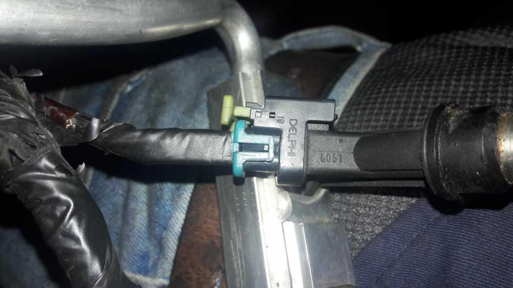

Any tips for how to remove the connector from the injector? Theres a green lock tab that i slid up, tried removing the connector, no luck... see that theres also two blue lock tabs on side of actual connector, lifted those up. Sill not coming off. Any advice before i emd up breaking a piece of the connector?
All mitchell says is * remove fuel injector connector......*

Sounds like you're doing it correctly, sir. :huh: Green tab pulls up, pinch the connector to unlock it from the injector, should slide off. The blue thing is just there to retain the weatherpack in the connector.
You may try either removing the green tab completely, or getting a small pick into the connector to manually pry up the lock tab. Gently, of course!

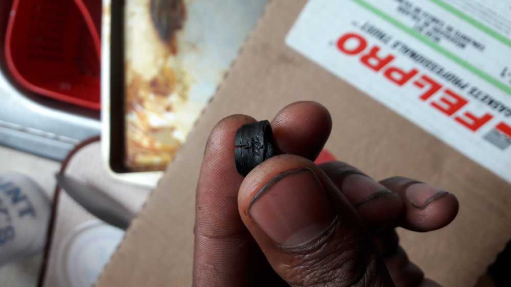

Thanks man I finally got it off. Do you know if I can use some other material for the pintel cap? I really don't want to spend 50 bucks on a fuel injector just to get the dust cap ( current one is cracked)

That dust cap, is it at the intake end of the injector, as seen here?
If you can get the injector back in and still have the O-ring sealing, then you might be OK?

9 years 9 months ago #4943 by Donnyten
Replied by Donnyten on topic Removing gm 3.1 fuel injector connectors
Yep that's it right there. I managed to get it back in. hopefully nothing will come of it. As far as the connector all that was needed was a little Force. Seemed like I was on the verge of breaking the thing.
