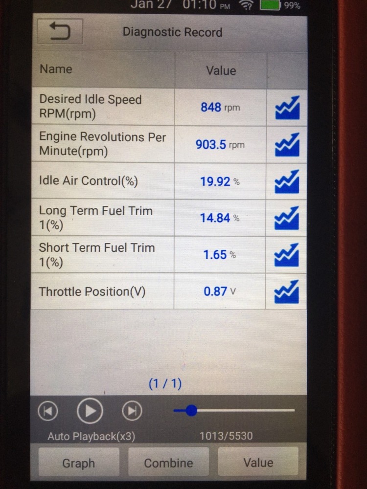

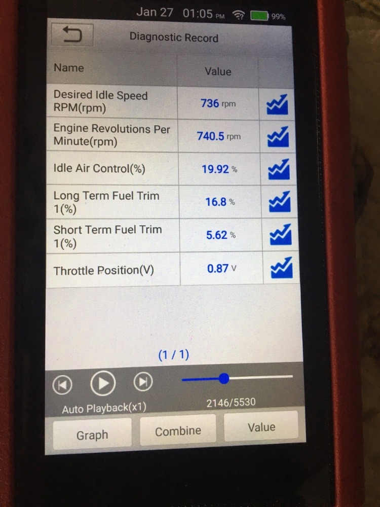

Hello
This is a 2002 ford focus 2.0L Zetec SE with 383,000 Miles with (NO CHECK ENGINE CODES)
except P1000 (OBD System readiness test not complete)
Problem:
After warming up the car for 5 min I experience vibration/sputtering/shaking on idle (park mode) and upon pressing the gas pedal their is 3-5 seconds or longer delay for the RPM to go down. I have no problem driving the car but maybe on the stop light or traffic I will feel the vibration but less because it on (Drive Mode) I have done many repairs with this car and I do it myself. The problem started after doing a complete timing belt replacement and before that front and rear main seal, new valve cover gasket. Compression Test all 4 cylinders around 150-160 psi (wet and dry)
What I did to try solving the problem:
Parts
-New Motorcraft IACV from Ford
-New TPS sensor from (Autozone)
-New MAF sensor (ebay) or my original which is clean and restored
-New O2 sensor (Autozone) upstream
-New Motorcraft Ignition Coil and Cables
-New Motorcraft Spark Plugs
-New Ford EGR Valve
-New PCV and hose (O'Reilly Auto Parts)
-New Fuel Injectors
I used smoke test and found 4 vaccum leaks
-Brake Booster hose to the intake
-hose to the PCV
-Hose to fuel rail
-EGR Valve
-Clean Throttle Body (New gasket)
Observation using my scan tool (Launch CRP 429C)
IACV on first start goes 40-50% and drops to 19.92% after warm up and stays there. IACV increases to 30%+/- when Engine fan cycles and drops back to 19.92%. The symptoms with IACV plugged is Vibration, sputtering and 3-5 sec delay upon pressing the gas pedal
At IACV 19.92% I can unplug IACV harness and vibration is less. The 3-5 sec delay on the pedal before is now normal without issue.
Plugging the IACV harness back will bring all the issue again.
I performed PCM reset, IACV relearn and clear codes with NO LUCK!
I also check the IACV harness for ground and 12V voltage was (good) using Circuit tester and Multimeter
I attached some numbers from the scan tool. If you need other info from the scanner please let me know. Hope you guys could help me. This is been a headache for months but at the same time I know I'm restoring the car anyway. Thanks

6 years 9 months ago #36988 by Tutti57
What are your short and long term fuel trims at when this is happening?

6 years 9 months ago - 6 years 9 months ago #36989 by dazs
At the beginning I found 4 vaccum leak and checking the (long term fuel trim) it was at 20%. Because I didn't pay attention too much I just fixed the vacuum leak immediately. Finding out the issue maybe got a little better but vibration/sputtering is still there. So now I have to start the car and check my scanner watching all the numbers in the scanner from 10-15min until I'm satisfied. LTFT now 15%+/- STFT 1.65% +/- this is while on idle for sometime. The IACV frozen@ 19.92% unless the engine fan cycles it will go up about 30% and drop back down after the cycle.
2002 Ford Focus spec says Desired RPM 700 and IACV 30%. Clearly too low! ScannerDanner's posted video he mentioned in one issue that IACV 19% is fully closed. Mine is stuck to 19.92% like its the lowest point and stays there.

6 years 9 months ago #36994 by guafa
Hi guys,
According to pictures, you have two diferent rpm's for the same IACV position. That means the IACV is not controling all the air passing trouhgh intake manifold. So you still have a vaccum leak.
Test: If throttle plate is completely closed, the only passage to the air enter is IACV passage. When you slowly strangle IACV passage, the engine should colapse.

6 years 9 months ago #36999 by dazs
I did 2 long separate smoke test which I found 4 vaccum leaks
cleaned throttle body plate and new gasket.
*What I've done similar to danner's video post regarding tampered throttle body screw by a owner.
=because I knew my IACV was too low @19.92 I had the car running in Idle while experiencing the vibration, sputtering and throttle delay 2-5 sec if I hit the gas pedal, then I unplug the harness of the IACV.
(result) no much difference. Although unplugging the IACV cures the gas pedal/throttle delay of 3-5 sec which happens when it's connected. Then I adjusted the throttle screw to match the desired RPM around 700 and reinsert the IACV harness (result) All the issue came back
=The setting that sounds good is unplug the IACV, raising the RPM between 900-1000 which I know is too high (throttle is open) and vibration/sputtering is less to none but I can't drive without the IACV.
If you think I need a a new IACV this is the second new Motorcraft IACV+ 1 aftermarket all doing the same thing.
