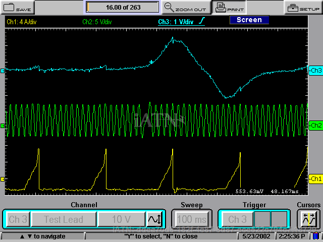

Replied by theyeti on topic P0340 Ford Ranger CAMSHAFT AND CRANKSHAFT Scope signals
OK so I got the following from a scope of camshaft and crankshaft signals and from what information I found it appears I am off alot. From what I understand the 2 signals should intersect in the middle of the camshaft sine wave on the 8th upswing of the crankshaft after the missing tooth signal. Does this sound correct for an 2000 Ford Ranger 3.0? Would adjusting / rotating the camshaft body be the proper way to correct this? Also any suggestion on how to tweak scope settings would be appreciated. See Link below for scope results.

6 years 9 months ago #37192
by gav09
appears you are off a little. You rotate the bottom part to adjust it. They also make tools for your alignment or you can watch your scope and try to match it up to the waveform.
www.amazon.com/Spectra-Premium-TK01-Sync...J9W8FEN51BYMMP78RTPA
Replied by gav09 on topic P0340 Ford Ranger

Thank you I will give this a try today. On your picture of the scope what is the yellow signal indicating?
- gav09
- Posts: 60
- Thank you received: 24
6 years 9 months ago #37199
by gav09
i believe its ignition coil current.

6 years 9 months ago #37208
by theyeti
Solution was to remove the synchronizer and move clockwise until it seated in. I believe a 1l4 turn. When i initially moved a 1l4 turn counterclockwise the scope showed intersection of signals around the 24th rise of crankshaft. When i started it was around the 16th rise. It is know properly on the 8th rise. Camshaft sensor can be tweaked but connector should roughly be at 38 degrees from center, pointed towards passengers side. Truck is now shifting super smooth. Hesitation and bucking gone. Fingers crossed MPG improves. Ty all for your help.
