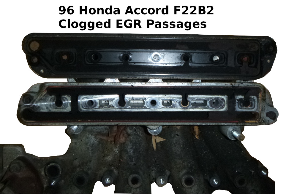

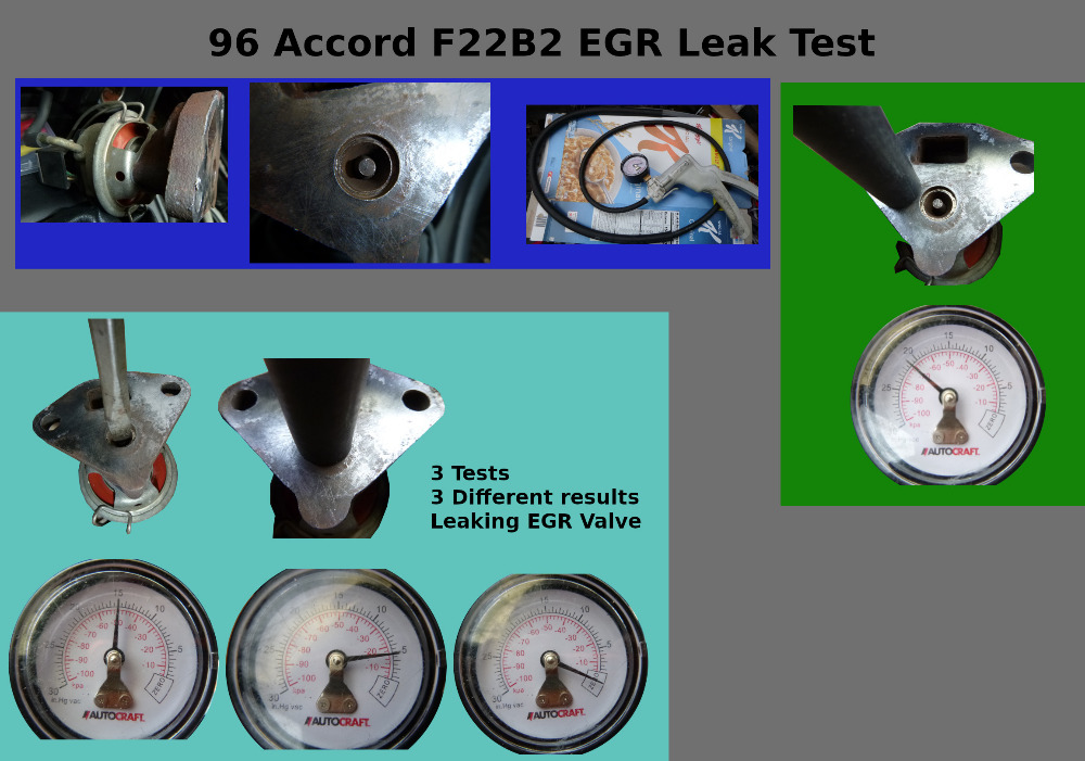

Ok, so I just finished the EGR valve leak test. 100% confirmed! It definitely leaks... but does so intermittently
Hopefully I can maybe clean the valve seat and get good results. If not I'll have to replace it.
You maybe wondering ( because I have said a few times )... how could the car have ran perfectly before the rebuild if this EGR valve was leaking the whole time?
I'm glad that you asked vicariously through me!
Let me show you the answer:
I cleaned every part of the intake completely spotless when I re-assembled the engine. That caused the leaky EGR valve to actually matter.

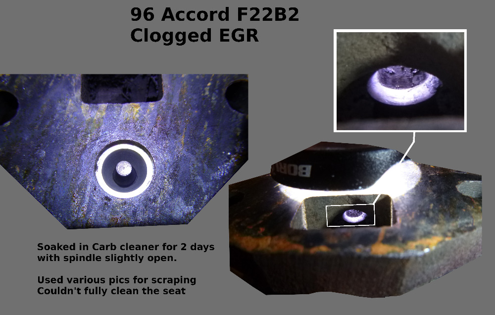

6 years 8 months ago - 6 years 8 months ago #37900 by hakachukai
Well, the weather is still pretty miserable most of the time, but I made a little progress on the 96 Accord.
Here is the update:

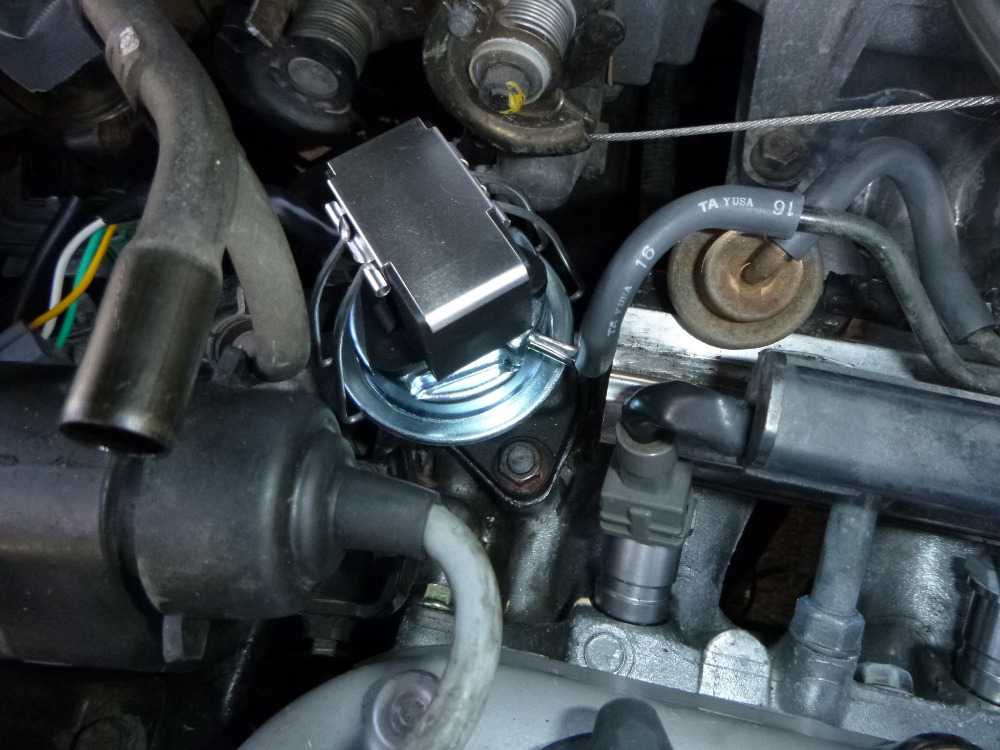

I tried my best to clean the old EGR valve, but no matter why I tried I could never get the valve seat fully clean.
I soaked in carb cleaner for 2 days straight with the spindle slightly open and picked it with various small picks.
I also tried spraying it with carb cleaner and slamming the valve shut multiple times. I was never able to get it to seal.
(in case you are wondering, the rust is from this part sitting outside for a few days after I gave up on it )

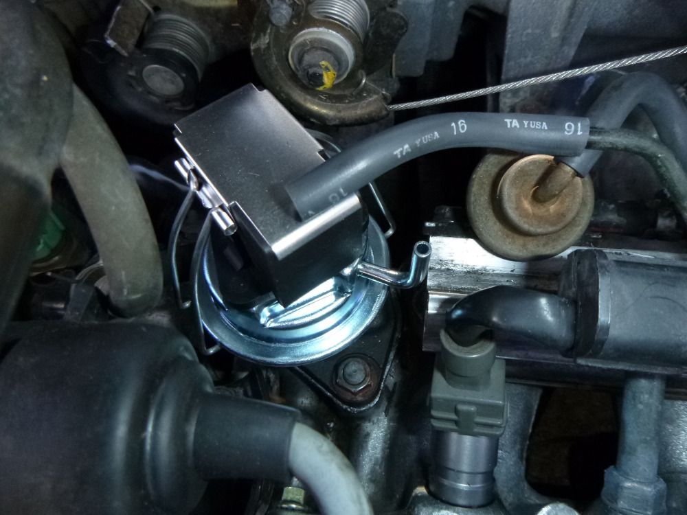

So I replaced it:
After that the car idled fine, but still has other issues. I still hear and feel occasional misfires, fuel trims still seem way off and possible spark timing, but I'm not 100% sure.
In the middle of my test the car suddenly died after being revved up a bit, then going back down to idle. I suspected the EGR valve again.
so I jumped out and pulled the vacuum hose on the EGR just to check.
Sure enough!
As soon as I pulled the hose I heard it suck in a bunch of air.

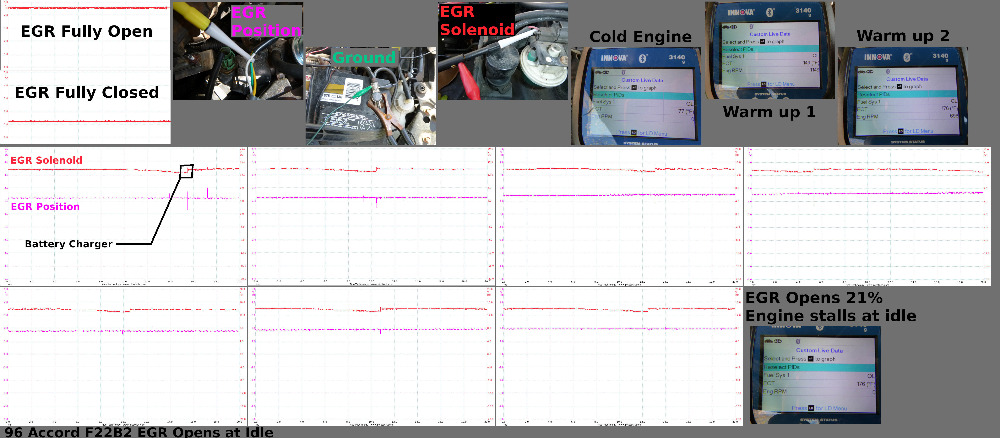

6 years 7 months ago - 6 years 7 months ago #38905 by hakachukai
Sorry for the Long wait! I'm back working on the 96 in the middle of the COVID19 lockdown
Today I tested the EGR valve in detail and found that it is indeed being opened when it should not be.
The ECU is not opening it ( no signal sent ). Something must be going on with one of the vacuum components.
Based on the timing of when it opens, it makes me wonder if the fast idle thermo valve is somehow involved.
Here are the findings:
The image above is completely unreadable using the javascript viewer, so I'll just hit the highlights:
Cold engine: 77DegF
Warm up 1: 149DegF 1149 RPM
Warm up 2: 176DegF 698 RPM
Warm up 3: 176DegF 0 RPM -- EGR valve opens 21% engine dies at idle.
Min EGR position voltage 1.2v
Max EGR position voltage 4.5v
EGR voltage at stall 2.0v -- Rise time 80msec
No EGR solenoid signal is ever sent
EGR vacuum remains even after the engine dies.
It still idles rough hesitates and misfires even before the EGR opens.
At this point I'm going to bypass the EGR for diagnostic purposes. I'll fix all of the underlying issues, then I'll repair the EGR last.

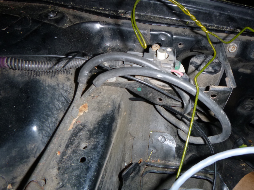

Well, I found the EGR valve problem
These two vacuum hoses that both go to the EGR solenoid got switched.
At first it would seem like that wouldn't even matter, except that the EGR controls have 2 parts:
A. The vacuum reducer / regulator
B. The EGR solenoid
The supply vacuum is supposed to go through the vacuum reducer first, then the reduced level of vacuum goes through the ERG solenoid, which passes that vacuum on to the EGR valve when the ECU activates the solenoid.
Since the hose accidentally got reversed, supply vacuum was first going through the solenoid, then it was going through the vacuum reducer / regulator backward. I guess the vacuum must have been high enough when the thermo valve shut ( at 176DegF ) to either bypass or pull the EGR solenoid shut. Maybe the vacuum reducer / regulator also acts as a check valve is you use it backward?
Anyway, This is how those two vacuum lines are supposed to be. They were reversed before:
Vacuum lines 16 and 24

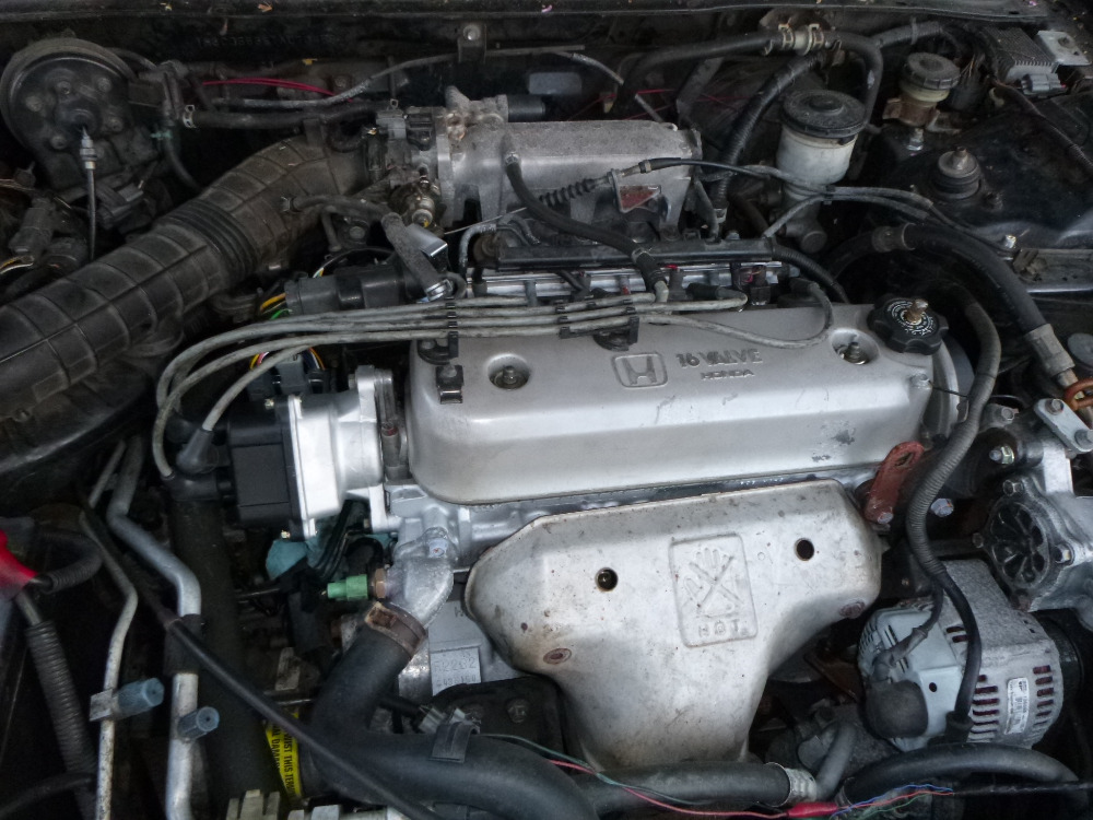

The biggest issue I have right now is that the engine vibrates a lot at idle. No bad noises. It runs pretty well. It just vibrates a LOT. Did I maybe somehow mess up the timing of the balance shafts? I hope not. I put a large amount of effort and study into getting them right.

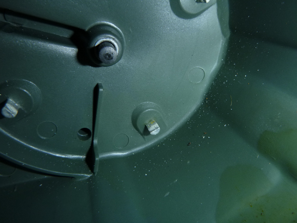

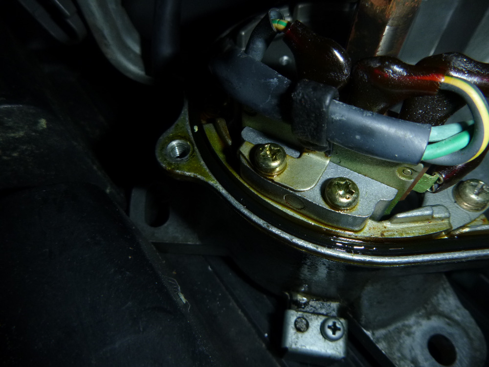

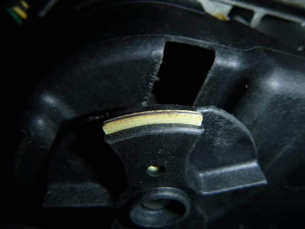

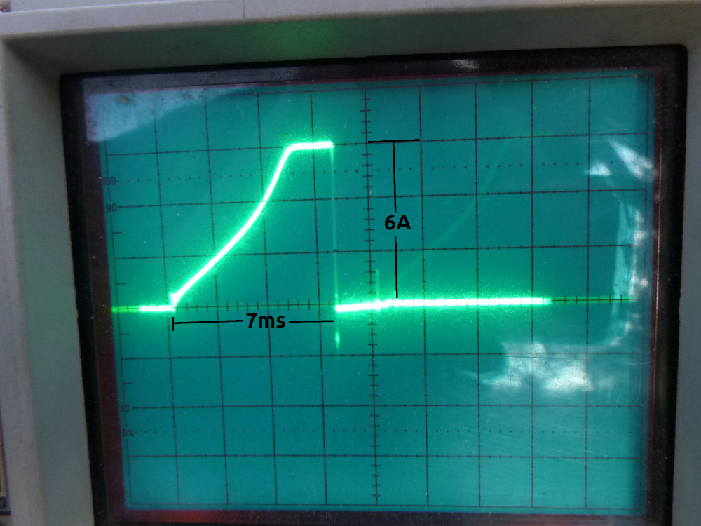

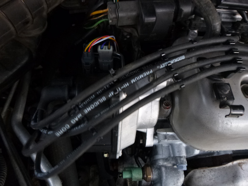

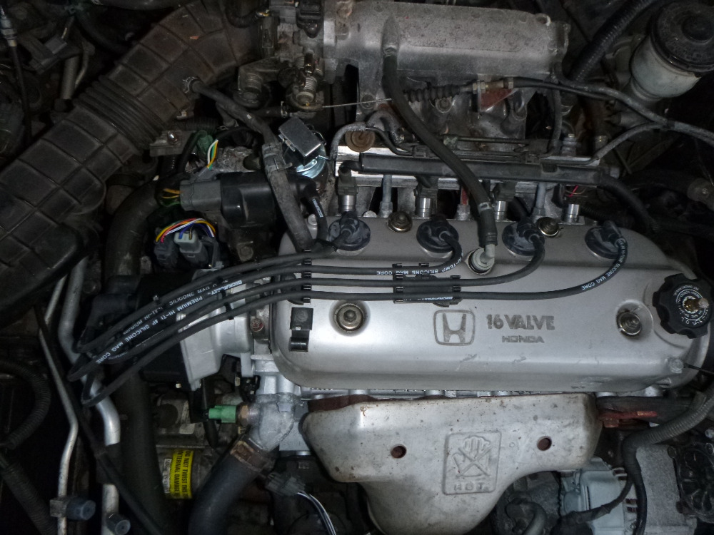

Here is the Primary charge ramp BEFORE I replaced the distro. ( I'll measure it again soon with the new distro to check fro differences )
Just replacing the distro was enough to solve the misfire
but after that I replaced the plug wires too.
This pic shows the new spark plug wires vibrating ( to give you an idea of how much the engine vibrates ). I'd say the spark wire move +,- 1mm just from the vibration at idle
The rest of the pics are a quick autopsy on the old distro. I'm not 100% sure why the cap terminals were so corroded, but I do know that it was leaking oil internally. The center shaft had surface rust on it and the wires were so crispy that I couldn't even get it fully apart with risking snapping the wires off.

So I'm still tracking down a misfire in this car! It's now my daily driver. A lot happened since I last posted. I have replaced several parts all related to the misfire. None of those parts replacements solved the misfire completely, but each one made it run a little bit better ( misfire less ).
  1. I replaced the Distro, plugs and wires ( ran a little bit better )
  2. I replaced the ignition coil ( ran a little bit better )
  3. I replaced the O2 sensor [ which I confirmed was slow to respond ] ( ran a little bit better )
  4. I replaced the alternator which was causing an ignition related code. I confirmed that the alternator was generating dirty power [ too much power fluctuation ] ( the code went away and it ran a little bit better )
However... there is still a slight misfire that is haunting me.

I've checked the primary ignition ramp ( posted about that ). It's right on the money and I don't see any dropouts
