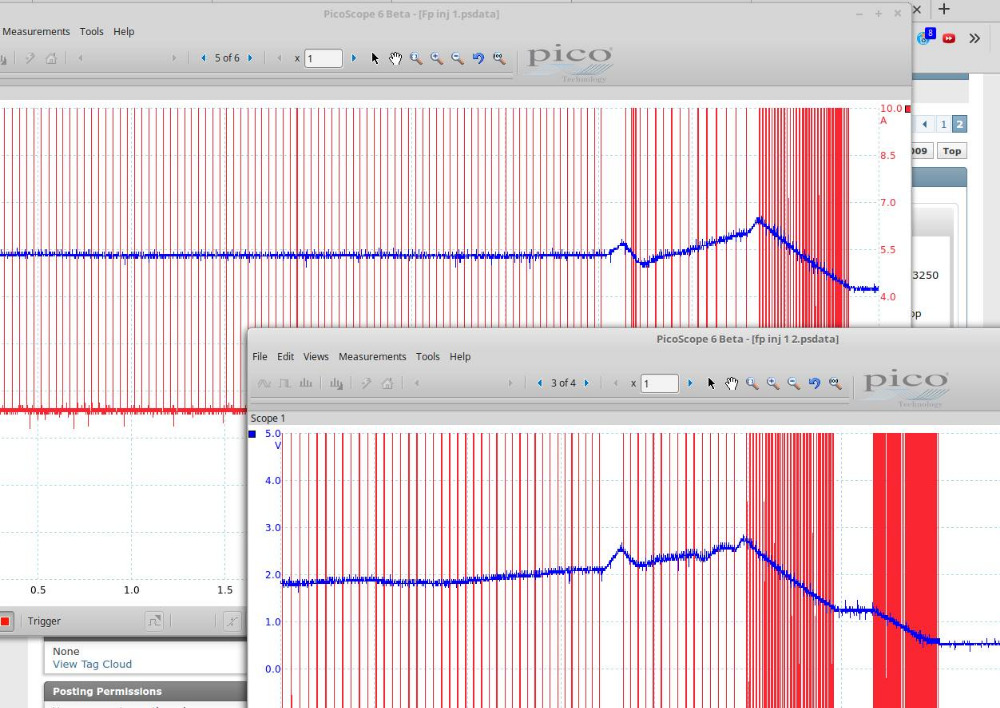

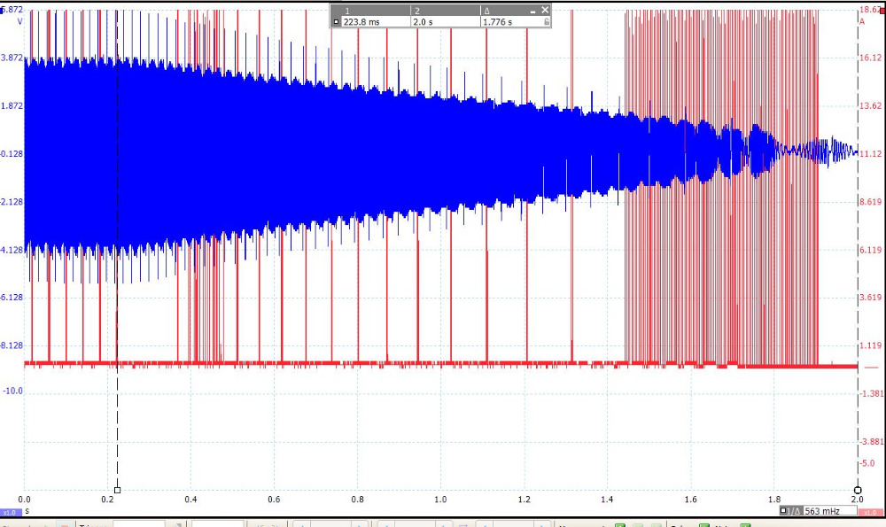

The ECU is cutting power to all injectors for 6-8 revs then bringing it back then going haywire firing them at double speed then 4x speed. This cut out and double firing also happens on a normal lift off and normal key shutdown has the same rapid firing - so it may be normal ?
Putting a scope on the fuel rail pressure (blue line) and Injector 1 (vertical red lines - current) you can see what is happening, it is 1.8s from first glitch (gap in injector firing) to dead stop. NB fuel pump is direct engine drive so pressure drops from random injector firing and slowing of pump. The graphs show the engine revving up to the cut out.
This is 2 separate tests :in the same pic

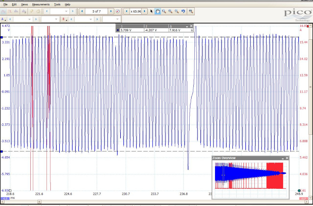

Crank sensor seems fine
The cam sensor shows no issues throughout the event either.
This is the file for that pic - engine is slwoing from first shut off of injector.
Can't see it as a wiring fault as it fails at a specific rpm, not fuel as can be seen from the pressure waveform, not injectors (inj 2 and 4 all behave the same way). It has to be something related to engine speed that is modified with temperature that is causing the ECU to have a fit. Can't see that it is an ECU failure due to the change with temperature.
Scoped the AC ripple and that seems fine, ran with the electronic turbo actuator disconnected (no difference), no anomalies, nothing stands out on live data and as I say the car starts, runs and drives ok unless you hit the cut out point!

Someone on the UK Jag forum suggested that the Mondeo's (same engine) had the issue if the Crank Sensor was not in as far as possible against a tooth when installed - literally 1mm of difference. Re-istalled it and problem gone.
Going to scope it again and see if there is a visible difference on the waveform because it looks perfect to me.

So I missed the obvious (well it is in hindsight!), see the 2nd pic down showing the lovely crank waveform, note the rulers showing 7.9v amplitude at 3250rpm. It should be 15-20v at idle and my scan today showed over 100v at 3250rpm when the scan in the pic was made.
Too easy to get hooked on those lovely curves and miss the numbers...
