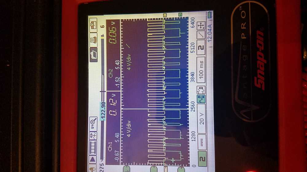

Today I had a 03 galant with a 2.4 liter. Owner said they stopped at a light and it died. First I tried to crank it over and it sounded light it wanted to fire every once in a while. You could smell fuel and got smoke out of the intake.
I checked for spark and had it at both coils.
Next I checked for codes and had po335 and po340. I looked at scan data and had RPM and the CKP signal pid switched to on.
Next I checked powers and grounds at the sensors and both were good. I hooked up the the signal wires on both and hand 0-5v square waves on both.
Both signal wires had 5v bias voltage when unplugged so next I checked mechanical timing and the marks lined up.
Next I tried to rule out fuel and started starting fluid in the intake and nothing. Vedited injection pulse and it's there.
I did a relative compression test and looked even across all cylinders.
I am at a loss on where to go next.
I am at a loss on where to go next. Any advice is appreciated.
Here is a video of the scan data and Cam/Crank signal on the car.

KOEO both sensors have 12v feed and are a 0v on the signal depending on where the tone ring is at. I'll attach a picture of the cam/crank during a crank. I don't have a known good to compare it too. Hopefully someone on here does.

On the signal wires? 0-5v square waves. They go all the way to 0 and all the way to 5.

Can you scope the timing? Amp clamp or battery voltage on 1 channel and coil signal on the other. Confirm the spark is close to tdc? The popping out the intake suggests that if the cam timing is ok, spark timing is not.

I'm looking for a known good cam/crank relationship right now, I'll get back on when I find one. My memory says that relationship is good, but I'm checking anyway.
I really like matt.white's suggestion to check spark timing! The trouble with this design is that there's only two crankshaft 'pulses' per 360 degrees, or four every 720 degrees, with no sync notch. This means it's possible for the crankshaft tone wheel/reluctor/toothed wheel to slip on the crankshaft, and still look like it's in time with the camshaft. :blink:

matt.white wrote: Can you scope the timing? Amp clamp or battery voltage on 1 channel and coil signal on the other. Confirm the spark is close to tdc? The popping out the intake suggests that if the cam timing is ok, spark timing is not.
Right on. I think that's a great place to start.
Do you know if it's had any service lately that would have required the removal of the crank pulley?
Looks like the crank sprocket, the CKP pick up and the balancer kind of sandwich together. I don't know if it's keyed or not, but if anything slipped here, you would end up with similar symptoms.
It's not keyed, but it should be. :angry: The reluctor is held to the crankshaft belt sprocket with little tiny roll pins... You can imagine how easily they fail and allow the reluctor to slip.

I have actually seen that happen, the roll pins break and the valve timing is on but the reluctor moves causing the spark timing to be off. Do what matt.white has suggested.
I had that though. I was sure how accurate it would be with starter current. I was wishing I had a pressure transducer.
I'll give it a try though.

Dsmnickk90 wrote: I had that though. I was sure how accurate it would be with starter current. I was wishing I had a pressure transducer.
Yeah, it's not all that accurate, but it'll be good enough to show the problem. If you're experiencing intake popping, then the spark timing problem will be obvious on the waveform.
