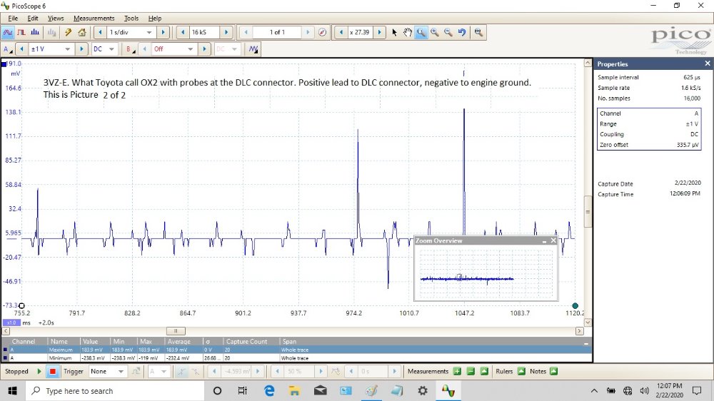

As I answered above to scanerjohn I do not have capability to read data for OBD-1 and as a DIY working for free, just for pleasure on a neighbors' car do not justify buying OBD-1 equipment since it phased out.
If I get some impulse I will try to Picoscan the O2 analyzers' behavior and also the Airflow Sensor since this engine does not have MAF.
Any ideas on how to Picoscope these two will be very welcome.

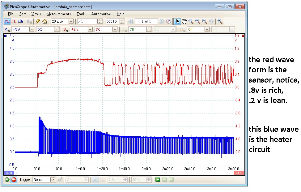

- tech25
- Posts: 86
- Thank you received: 27
6 years 8 months ago - 6 years 8 months ago #37704
by tech25
Replied by tech25 on topic WHat would be a good a good approach to diagnose Lack of power under following:
I cannot find any specs for fuel flow, so sorry about that, cant be certain about that.
if you go to pin 4 in the data link connector in the engine compartment, it should be a black wire.. that appears to be
the signal wire coming from the a/f sensor/o2 sensor.
I would definitely hook up the pico scope, and select the predetermined settings
here is a example...

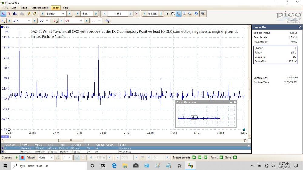

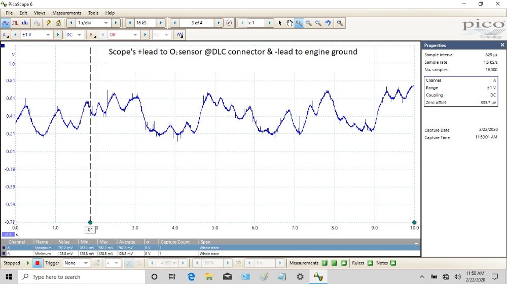

6 years 8 months ago #37978
by Batiscafo
Replied by Batiscafo on topic O2 sensors waveforms and how to adjust the transmmission kickdown
I went to the 17-18 Data Link Connector on the engine compartment and read the O2 sensors waveform to ground. This is what got and cannot make much sense of all those spikes that do not at all the waveforms I found for sensors that work on the 0.2 to 0.9 Volts.
But the spikes seems to be controlling the fuel mix since the car is running better now after I swap the ECU with a used one.
Also I could not figure out how to adjust the kickdown so when the gas pedal is depress hard and the car do not have the power in Drive, kicks down to second gear.
I try with the cable near the accelerator shortening end extended but not results.
Any help appreciated.
I am trying to attach three files I saved from Pico of the two O2 sensors

In the OBD1 days on the few vehicles that did not give scan tool data I would hook wires up backprobing the ecm.
Watch the O2 while driving see if it goes biased.
Watch and graph the mass arflow and see if it dips or drops off or is out of spec.
