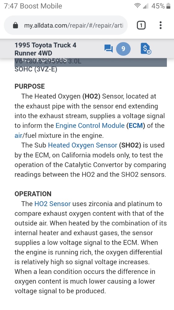

How do I know one from another? I have no clue and no idea how to identify them
These are on a Toyota 1995 4Runner with 3VZ-E engine.
Not a word on the FSM on this subject. Youtube goes on and on without clues to help me. All I knew is that there were O2 Sensors. Schrodinger mentions something about two types: 100-900mV; and others from 3V to 3.9 volts ???
Help will be appreciated.

6 years 8 months ago #37806
by VegasJAK
Replied by VegasJAK on topic O2 Sensors; Circonia, Titania, Titania with heater, ZIfrconia Pre & Post CAT, Bo
check the VECI label under the hood... it should tell you which 02 it is using...
Toyota OE#89465 prefix is for narrowband 02's.
Toyota OE parts site says it used the narrowband 89465-39755.
