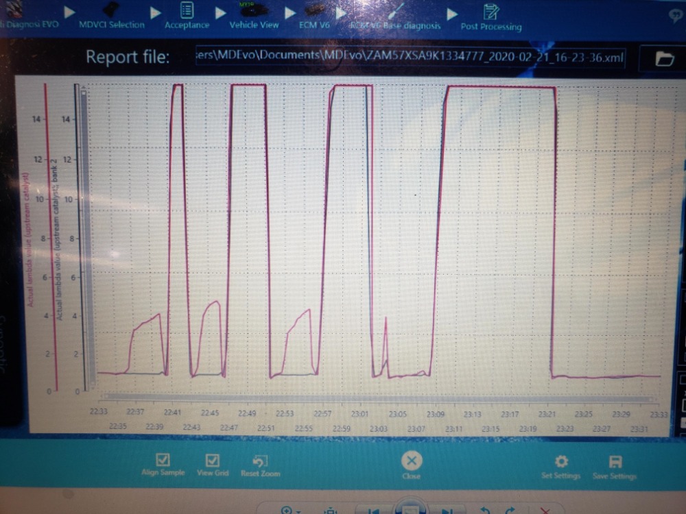

2016 Maserati Ghibli. New in stock vehicle. Low power under high load. 3.0 liter bi-turbo. Sets P0299-00, P0300, P0301-303. Bank 1 turbo assembly has been replaced, had other faults for wastegate control issues. Anti-rattle clip on wastegate actuator rod was improperly positioned, binding the rod movement. That issue is repaired. I have attached a screenshot of both banks lambda values when issue occurs. Bank 1 lambda goes well above 1 (3-7 roughly) when low power concern is happening. Bank 2 stays near lambda 1. Lift throttle lambda values track together around 15 (Injector shut-off I presume. I suspect an fuel delivery issue on bank 1 only, perhaps an ECM injector bump-up voltage supply issue, or an injector rail restriction, or even possibly a complete incorrect injector rail w/injectors on bank 1. Has single high pressure pump, with manifold to deliver fuel to each rail through individual pipes to each rail. Pressure sensor at end of rail for bank 1. P0299-00 is for Underboost.
Looking for any input prior to deeper testing, specifically any suggestions for the least invasive way to potentially verify a low fuel delivery issue to bank 1 under high load/rpm conditions. I have a Pico scope available.

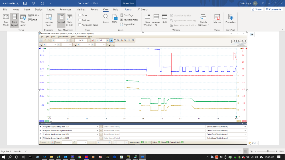

6 years 8 months ago #37873 by SHIMHEAD
So got Pico hooked up to injectors #1 and #6 (one from each bank), got a capture while low power issue happening. It seems that the #1 injector is not even being activated (same pattern on both + and - terminals at ECM). Have not yet tried the other 2 injectors on Bank 1, but suspect they may be the same, so the whole bank 1 may not be injecting any fuel when this happens. Will be verify ing ECM powers and grounds as well.

Yes we do get all bank 1 cylinder misfire codes. Have not yet tried a generic scan tool. I have a Snap-On Verdict, but last updated in 2011, but it should have an OBD2 mode, will see if we can get it hooked up soon. This is an in-stock vehicle and low on the priority pole at the moment. Also forgot to mention the scope patterns are with all channels connected through 20:1 attenuators just to be safe.

ok, possible fuel injectors faulty, but looking at your scope pattern, i am wondering if the ECM is actually activating the injectors. it looks like it not??
question for BOL guys. what do they think of the scope pattern, is the ECM grounding ( activating ) the injectors, or if they injectors is not firing, does the ECM shut down that injector for safety reasons??
6 years 8 months ago #37880 by Matts Auto
looks like your only getting about 3 volts to the injectors. can you retest power side of injector with scope negative to battery negative & then test injector negative side with scope positive to battery positive. I'm assuming these injectors are ground side controlled from pcm? Is injector voltage 12 volt ? I have no acess to maserati information. Possible electrical fault to injectors ?

6 years 8 months ago #37894 by SHIMHEAD
Using 20:1 attenuators, multiply scope reading times 20. Direct injected piezo injectors. ECM bumps voltage up to approx. 65 volts.

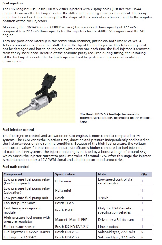

6 years 8 months ago #37897 by tech25
these are not piezo injectors.. they are solenoid type injectors. however the voltage is spiked up depending upon situations.
note.... info, about injectors.
6 years 8 months ago #37901 by Matts Auto
Ahhh. Makes sense. Sorry for my lack of knowledge on that
6 years 8 months ago #37904 by Matts Auto
Thanks for posting the injector information tech25

6 years 8 months ago #37906 by SHIMHEAD
Tech25,
Yes indeed you are correct, NOT piezo. Just finished looking through my Ghibli intro book as well looking for any details I might have missed regarding the fuel and engine control systems. Made an assumption based on other reading, and I was WRONG. I assume you are a Maserati dealer tech as well? Would you care to have a phone conversation about this vehicle?
