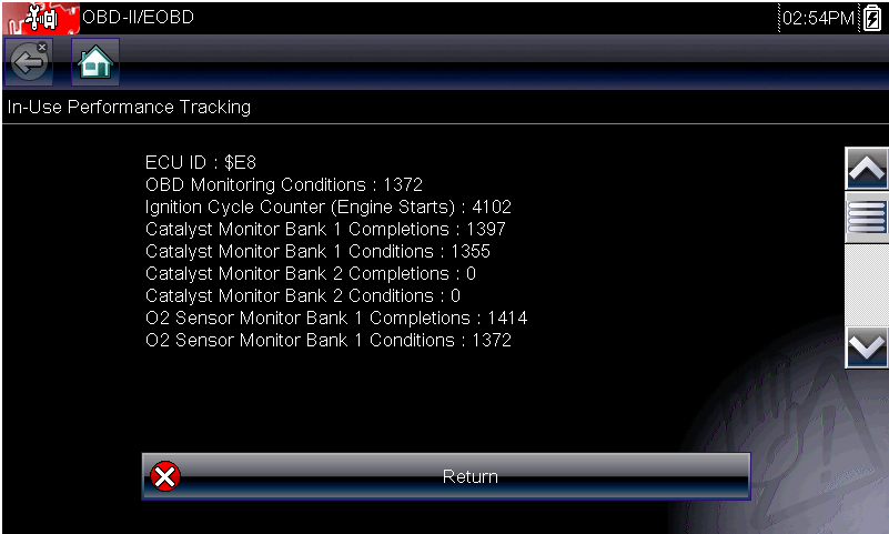

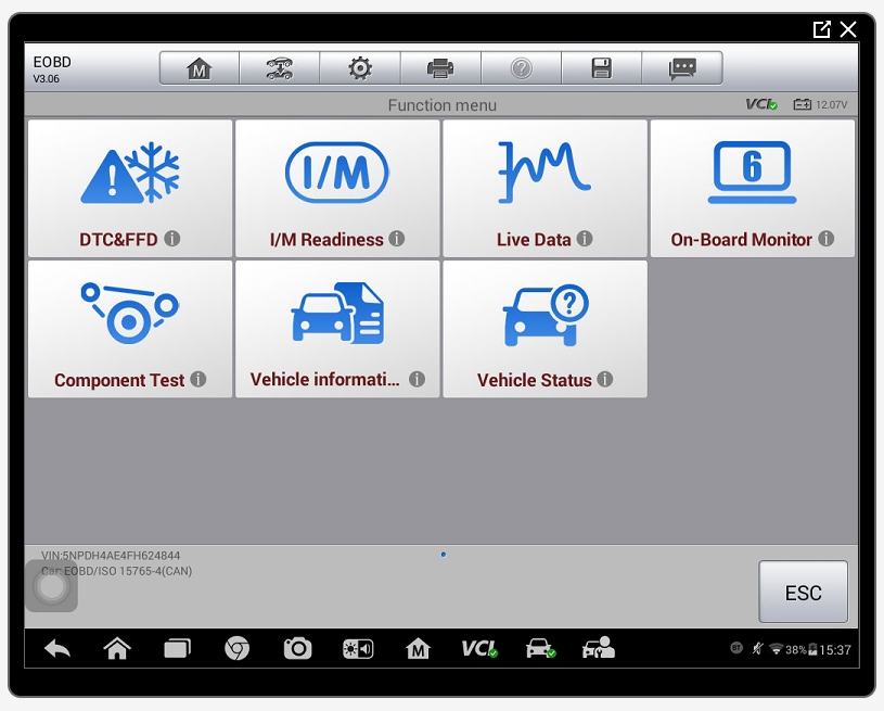

Getting Mode $06 and Mode $09 data should be pretty easy with the Autel. It'll be available under the OBD/EOBD option in the vehicle selection screen. Hitting the Mode $06 button should query all TID's and generate a list of all monitor results. Should allow you to save screenshots or a PDF.
I'm not positive how to navigate to In Use Performance Tracking data on the Autel. It'll be under Mode $09 somewhere, along with the VIN, Calibration ID and Calibration Verification Number. The actual data will look something like this:
  • derek.chung
  • derek.chung's Avatar Topic Author
6 years 8 months ago #37864 by derek.chung
Could not see any $06 on any page. I am in the OBD section.

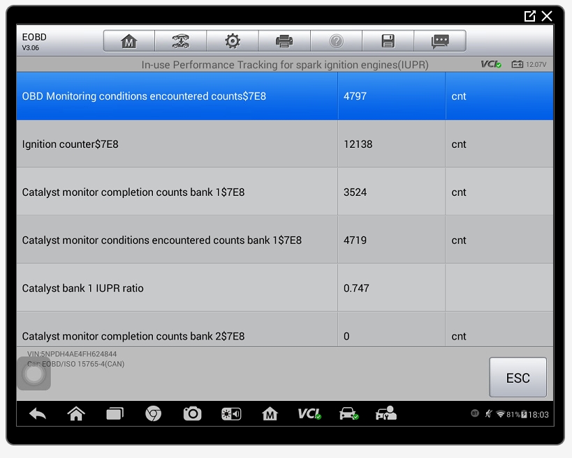

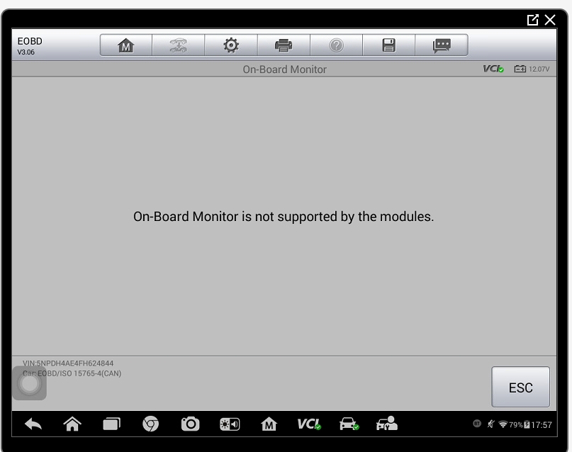

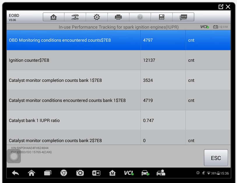

6 years 8 months ago #37866 by Tyler
Mode $06 will be under the 'On-Board Monitor' button. ;) Autel doesn't make that very clear.
IUPR (In Use Performance Ratio) is just doing the math for you between the completion counts, and the conditions encountered counts.
If you scroll down on the IUPT screen, does Fuel System show up anywhere? We know that the completion count should be zero, but I'm mostly curious about the conditions encountered count.

6 years 8 months ago #37868 by derek.chung
On board monitor button not supported:
No, I don't see Fuel System in the IUPR screen:
Tank has been emptied 2 times since tranny was replaced. Most of the time the tank was between 1/4 and 3/4. I kind of remember Fuel monitor is always the first to set. That is why I am baffled.

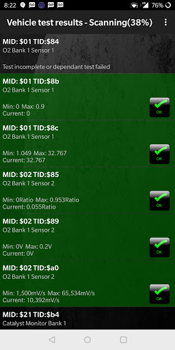

6 years 8 months ago #37879 by derek.chung
Ah, it must be this screen (below) that would provide more info.
The incomplete one is MID $01 TID $84.
Does it hint anything? I googled "MID $01 TID $84" and could not find anything specific.
(Looks like Torque pro can do more than what Autel MS906BT can)

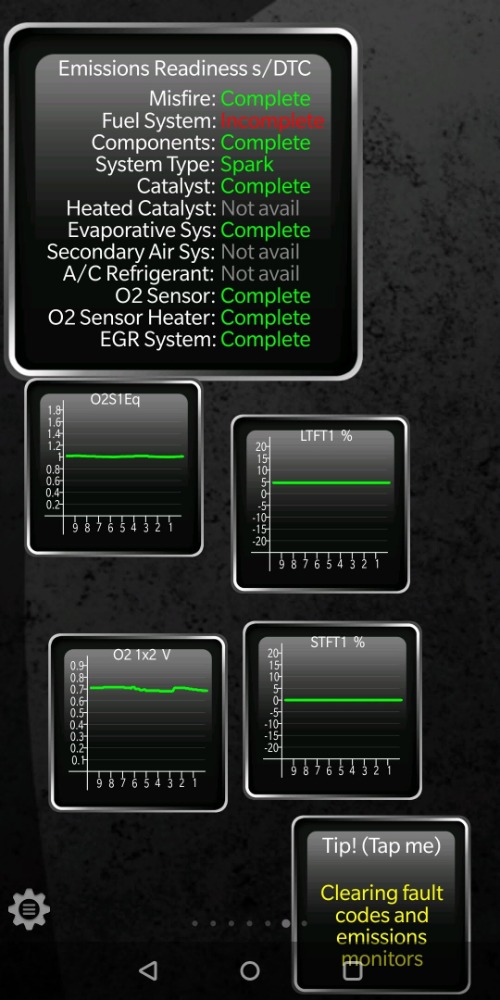

6 years 8 months ago #37883 by hakachukai
Post the output of the following as the car warms ( goes from completely cool to completely hot )
MAP/MAF sensor
Coolant Temp
Intake Air Temp
RPM
Fuel system status ( I.E. Open loop/Closed loop)
Primary O2 sensor voltage ( no calculations, just raw signal )
Those are usually the sensor involved in determining fuel system status, though I don't know if this car uses anything extra.

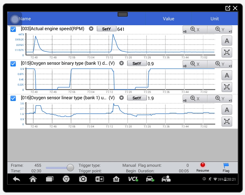

Hmmm. How do show? I got this video of it starting from cold to warm:
photos.app.goo.gl/HLNey2WEp7MDT7V89
I did not take intake air temp. No room on the tiny screen. I checked afterward, it was at constant 70.
6 years 8 months ago #37928 by hakachukai
Have you tried driving the car? Maybe the fuel monitor won't set until it tests the fuel system under real life engine load conditions.
Everything that I saw in the video looked pretty normal.
If you want you could trade out the bottom display ( O2 Sensor current for Intake Air Temp ).
We only really need to see the O2 lambda, it looked nearly perfect at 0.999:1 the entire time.
That does raise a question though. Don't car usually run a bit rich until they warm up?
That didn't seem to happen here.
Also I saw that your MAP went as low as 4psi and leveled out at about 6psia.
That is between 8 and 12 inHg of vacuum.
All of the engines that I've seen have a normal range between 17 and 22 inHg vacuum.
For example: my Civic and Accord both idle at 18inHg ( 8.84 psia )
I'll do some more research on it a bit later and I could be wrong... but
  1. Maybe something is up with your MAP sensor?
  2. Maybe the MAP is fine and air flow is restricted?
  3. Maybe its fine and I'm just wrong?
The lambda sure doesn't seem to know about it. I don't see it trying to correct by adding or subtracting fuel.
