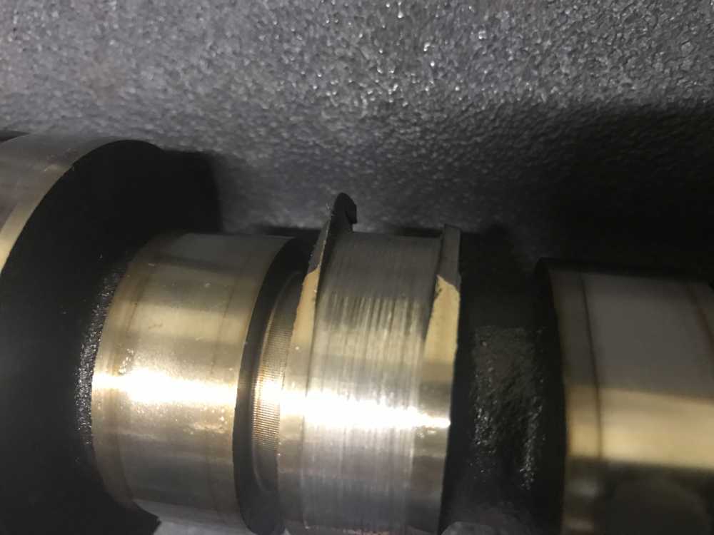

9 years 8 months ago #6258 by chris.arriazola
Replied by chris.arriazola on topic 2011 ram 1500 misfire
Wanted to do an update on this Ram 1500 5.7. Turned out to have a lifter that seized and tor the cam to crap.Here is a picture of the cam. Took valve cover off and turn the truck on and noticed the number 2 cylinder intake valve didn't move . Thanks for the help on this site.
9 years 8 months ago - 9 years 8 months ago #6263 by Noah
Replied by Noah on topic 2011 ram 1500 misfire
chris.arriazola wrote: Wanted to do an update on this Ram 1500 5.7. Turned out to have a lifter that seized and tor the cam to crap.Here is a picture of the cam. Took valve cover off and turn the truck on and noticed the number 2 cylinder intake valve didn't move . Thanks for the help on this site.
I'm sure it's not what the owner wanted to hear, but nice work all around. That thing looks toasted! Too bad these Hemi motors eat valve trains...
So do we have confirmation of intentional coil driver shut down?
Thanks for posting an update to this one and including that pic of the cam

9 years 8 months ago #6276 by chris.arriazola
yes we have confirmation that the pcm shuts both injection and coil firing on this engine to protect the cat.

So just to be clear, the misfiring cylinder was indeed #2? But your compression testing showed a problem with #6... No wonder we were confused. :lol: I'm trying to account for why the compression test didn't expose the lobe problem... Perhaps a running compression test would have been the way to go?

I did run compression test but it passed because the intake valve was staying closed. The lobe was so bad it wouldnt open to inject gas in the cylinder. Thats why it tricked me. The other problem with number 6 was a bent valve. It was kind of weird. If only I would of taken valve cover off at the beginning i would have seen the problem but i was focused on playing with my scope I made it a nightmare. LOL
