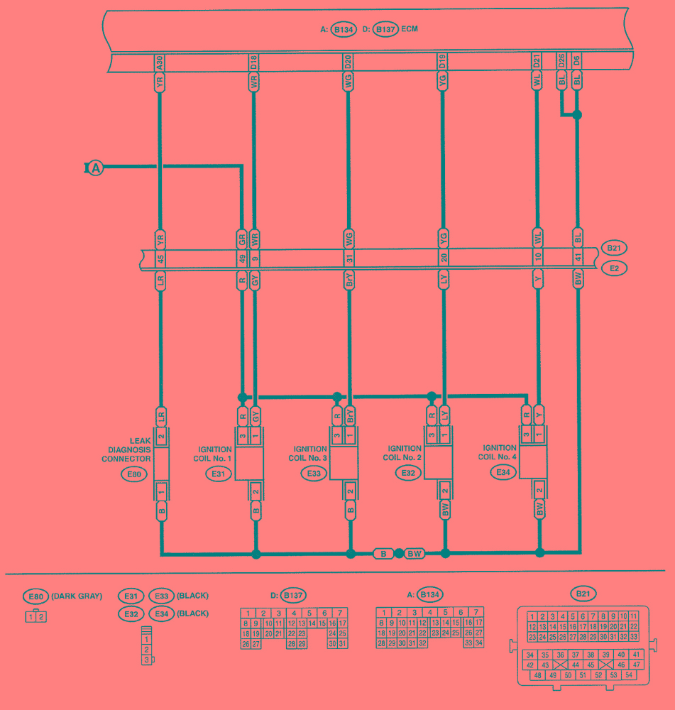

Hi,
working on a 2010 subaru wrx brand new motor installed, the car is only firing spark on 2 and 4 but not one 1 and 3. Looks like 1 and 3 fire first from what manuals say, 3 wire coil measures out 12 volts and a solid ground. What confuses me is that the switched ignition shows a slight ground on 4 coils when the key is off and increases when the key is on. Does this rule out cam sensors being bad? The car does run on starter fluid and continues if we feed it. Pulled plugs on 1 and 3 and it looks like they have never fired ever.

Hi it’s an 08 sti manual 6 speed. Getting strong 12 volts and .2 ohm ground. With the switched signal I am seeing a ground when the key is on but it’s stronger then the ignition is on but does not change brightness like it should on the videos.
Cylinders 1 and 3 are on the passenger side and do not fire even swapping coils. I did take out the exhaust cam sensor to see if that effects spark for the drivers side and it doesn’t not stop 2 and 4 from firing.

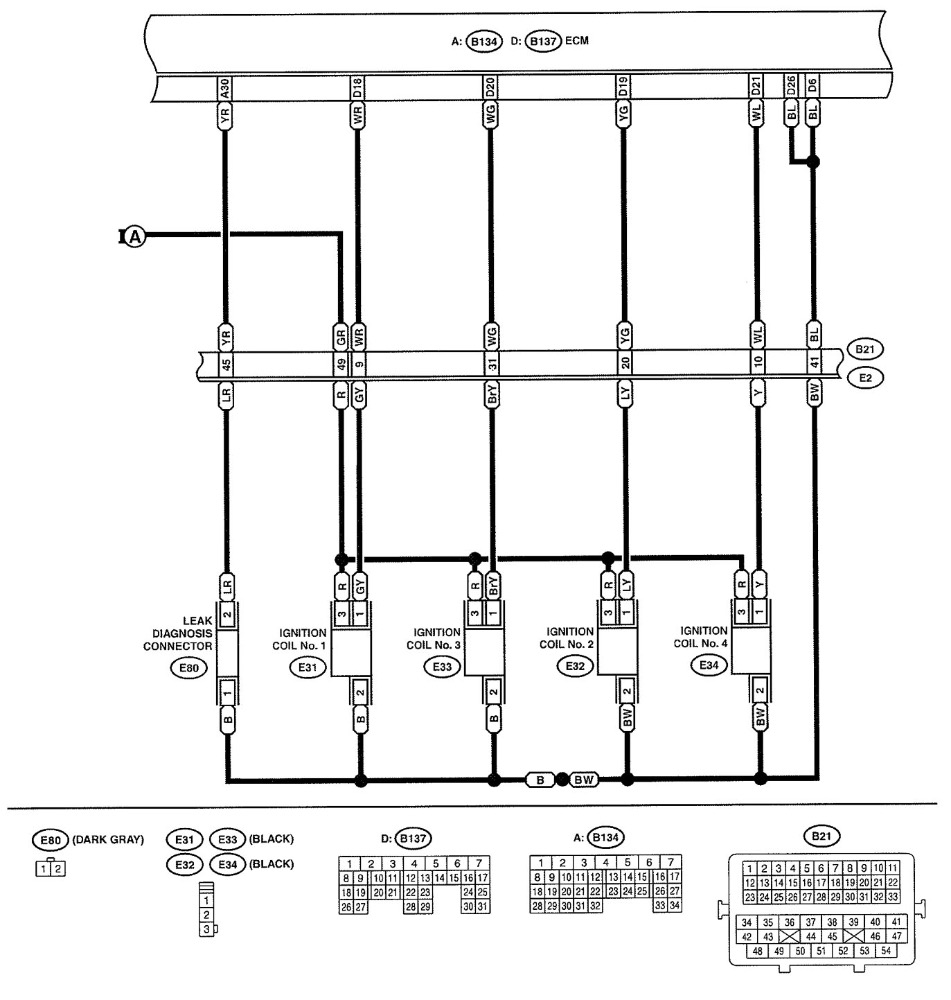

So doing some more testing, I am getting coil signal of 4.5 volts to the 2 and 4 but on 1 and 3 I am only getting .8 volts I tested it at the ecm and same readings. Please any help would be greatly appreciated.
6 years 7 months ago - 6 years 7 months ago #38290 by John Curtis
Replied by John Curtis on topic Car only sparking on 2 and 4 cylinder
AvBacon wrote: So doing some more testing, I am getting coil signal of 4.5 volts to the 2 and 4 but on 1 and 3 I am only getting .8 volts I tested it at the ecm and same readings. Please any help would be greatly appreciated.
Which wires?
Red is B+ for all coils
Coil 1 and 3 have a black wire for the ground.
Coil 2 and 4 have a black and white for the ground.
Coil 1 control should be grey
Coil 3 control should be brown and yellow
Being that both coils that aren’t firing share a ground, I would use a jumper to provide a known good ground or scope the ground and see if it’s a bad ground (being pulled up). It’s more likely that a shared ground is bad than 2 separate ecu drivers failing.
If you have B+ going in, and a good ground, the ECU control should be no less than 4.2v (the closer to 5 the better) and should be a square wave.
My question to you is how are you testing? The signal control signal may very be 5V but if you’re testing with anything other than a scope or graphing meter, then you’re not going to know for sure. The meter will average out the signal over whatever spec time.
