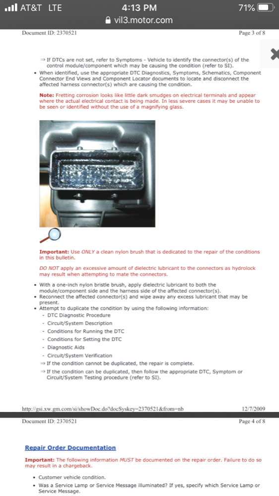

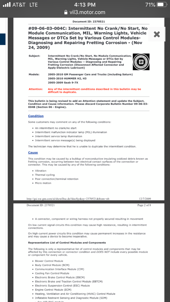

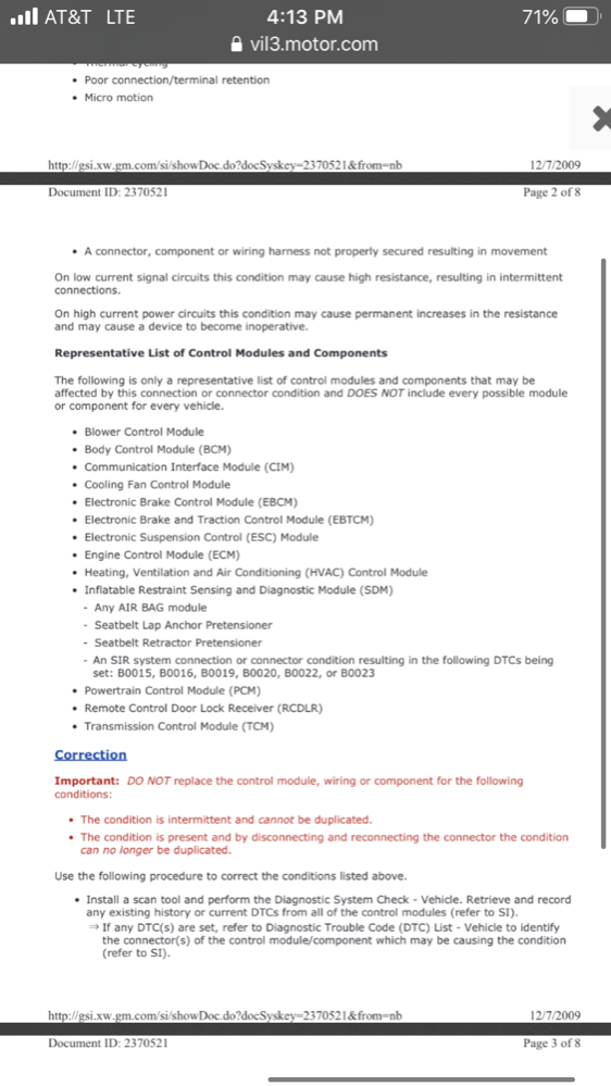

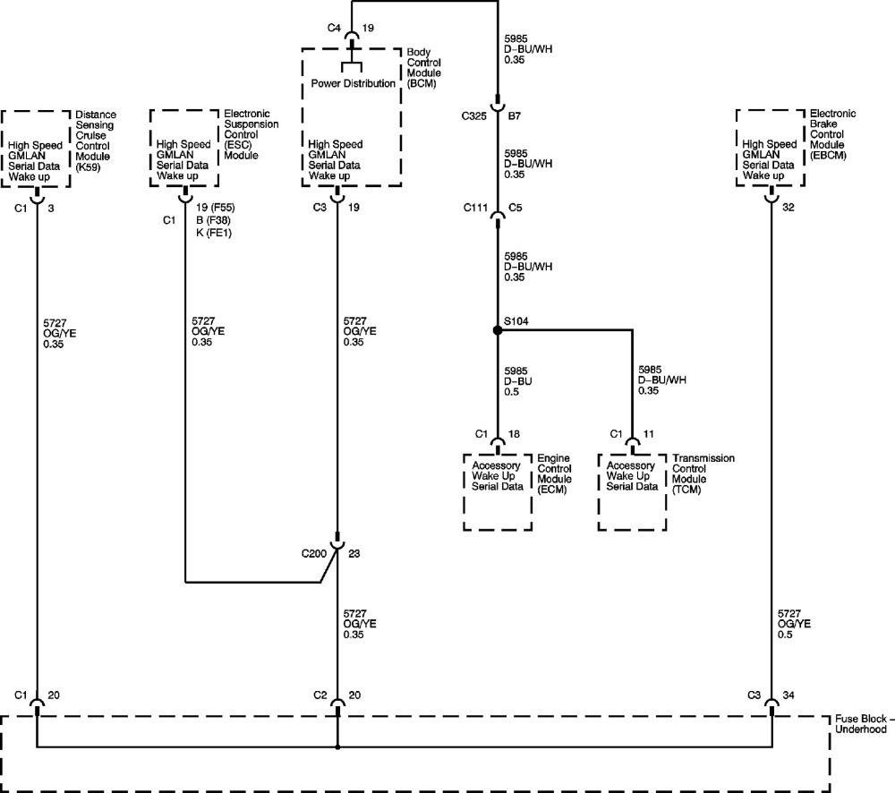

6 years 8 months ago - 6 years 8 months ago #38067 by John Curtis
Here is a TSB and diagrams of the data network.
What are all your codes?
Last edit: 6 years 8 months ago by John Curtis.

6 years 8 months ago #38075 by Betterway52
I have the wiring diagram thanks. i did not see this tsb i will check my module connectors for this condition. which i do not think is occurring.

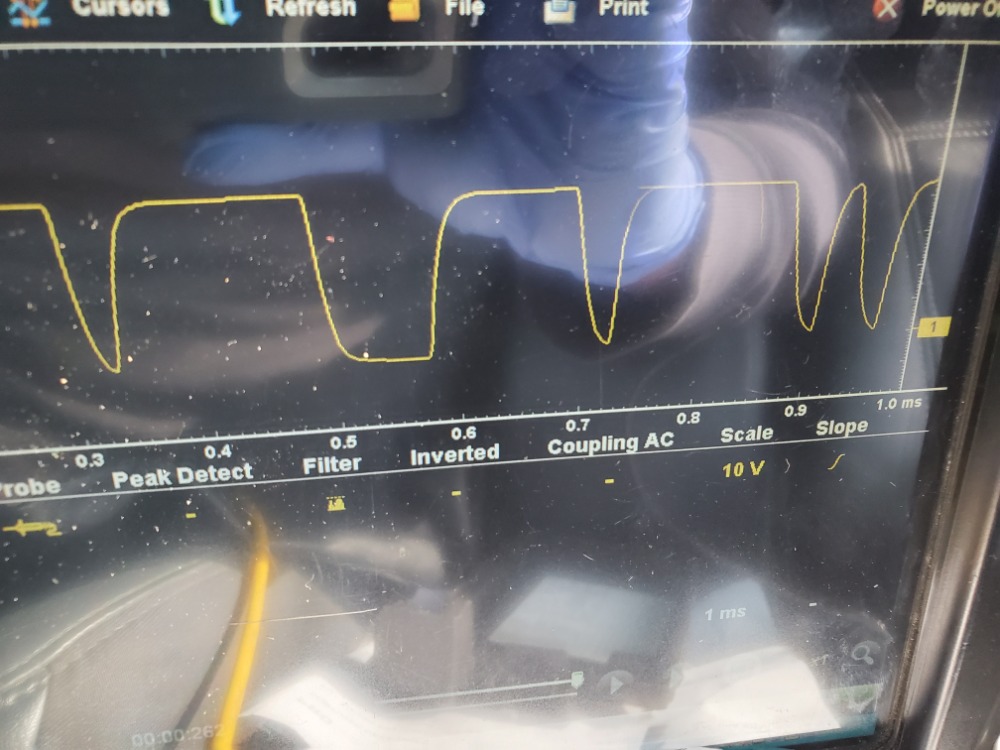

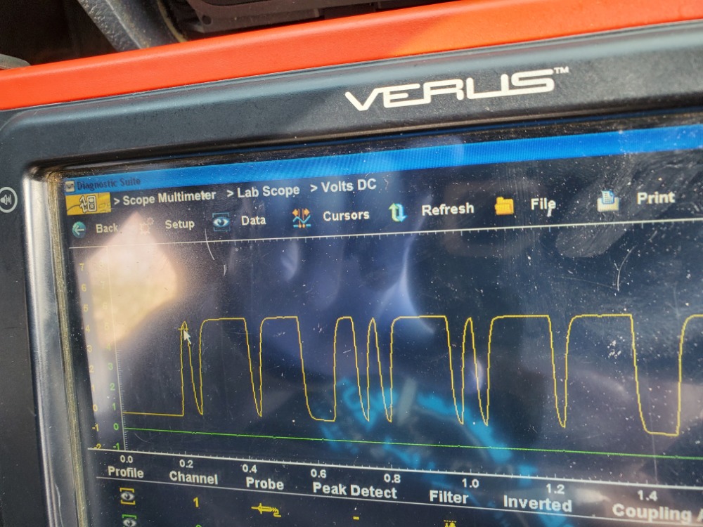

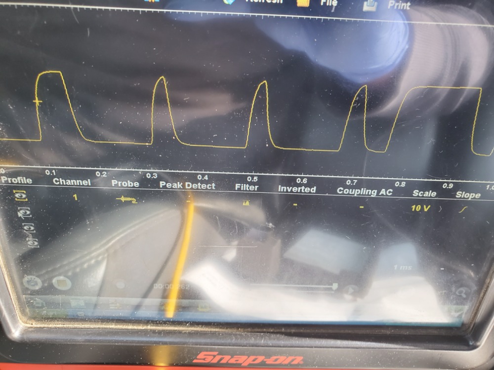

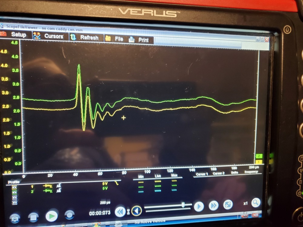

6 years 7 months ago #38622 by Betterway52
These images are from the dlc and then the single trace images are the can lines at the connector. Any idea what that looks like bad computer?

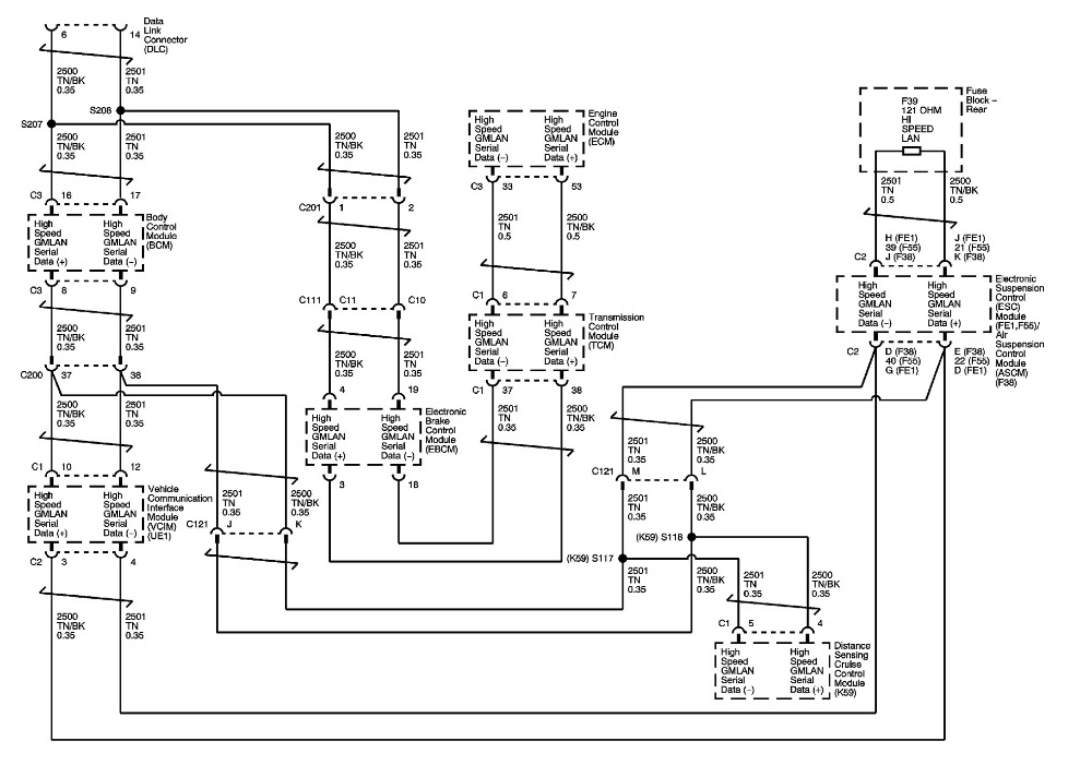

6 years 7 months ago - 6 years 7 months ago #38627 by jreardon
Betterway52 wrote: whenever i disconnect any module the resistance jumps to 123ohms. which i think is supposed to be normal?
I've redrawn that oe diagram just to make it easier to understand where the wires are going.

6 years 7 months ago #38635 by jreardon
c0550 - ebcm detects an internal malfunction
c0899 - device voltage low - ignition voltage to ebcm is less than 9v for 100 msec.
b1325 - device power circuit - system voltage below or above the calibrated value of 9v -18v
Clear the codes, make sure battery is good and terminals tight. Check battery for excessive ac ripple. Check what your low speed serial data looks like (dlc pin 1). 60 ohms on high speed gmlan and your image attachment shows it's intact, not shorted to each other, not shorted to power nor ground. Scope capture looks a little wavy haha. c0550 points to bad ebcm, if that code keeps coming back unplug that module and jump the terminals so the 120 ohm resistor in the ECM stays connected on the network.

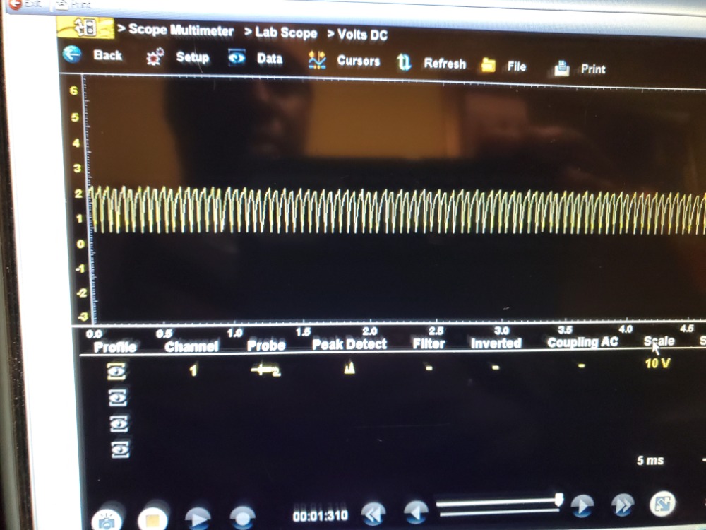

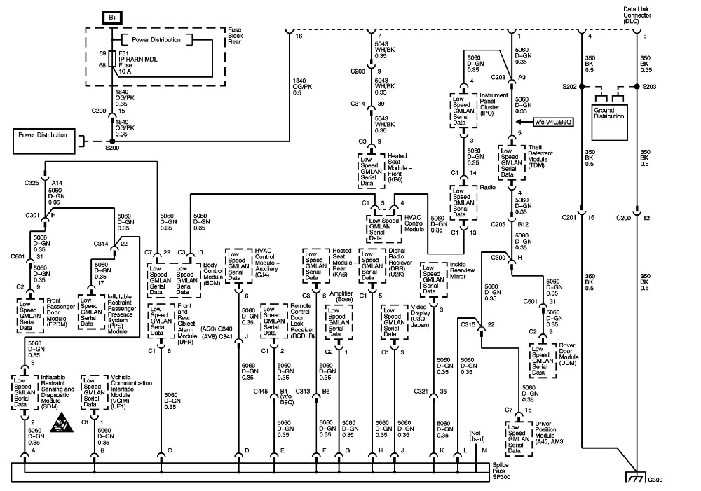

6 years 5 months ago #39855 by Betterway52
hey there car is still beating me up. i have a capture on my pin 1 of dlc the low speed can network. which shows constant communication. hours after car has been off. i also noticed that the data from my radio on the scan tool does not match power mode of the bcm. the radio data will show power mode off with car running and radio is playing. i cycled the key and it sometimes changes to acc or to run, im thinking now its an ignition problem or the bcm is not sending signal sometimes to radio. i need to look over how that circuit operates. now with the pin 1 capture shouldnt the waveform be all squarewaves for communication like on the high speed can lines?

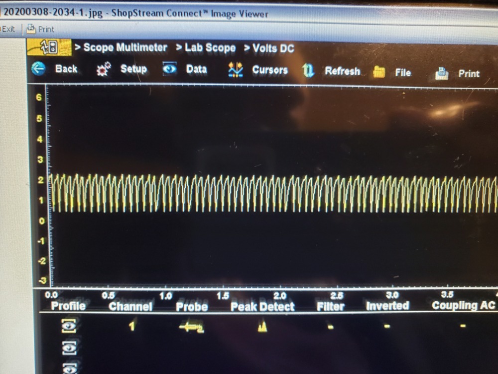

6 years 5 months ago #39856 by Betterway52
These are the pin 1 waveforms. Low speed can. Any help ideas are appreciated and welcomed.
6 years 5 months ago - 6 years 5 months ago #39869 by John Curtis
Missing termination resistor(inside the module).
you’ll see how the voltage is going too high for the can network specs?
As far as the location of the terminating resistor SI shows that on is internal to the PCM and the other is in the rear fuse box.
