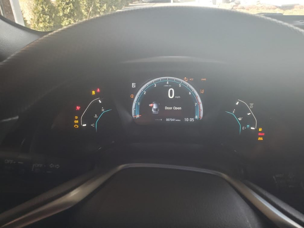

  • assem.nagi
  • assem.nagi's Avatar Topic Author
6 years 7 months ago #38198 by assem.nagi
Replied by assem.nagi on topic 2019 Honda Civic EX Htachback (5DR) wont start.
I attached what my dash looks like I see a weird blinking on the shift position indicator where there should be a Pfor Park but instead it shows a combination of all shift positions that blinks.
Again thank you guys for the help I'm a DIY guy and love to learn this stuff everything I learn will be passed on. Thank You.

6 years 7 months ago #38274 by TechNick
That’s good news!
Be careful swapping PCMs from different trim levels. You may have a different pin configuration.
Used PCMs are fine. I even do them at the dealership I’m at when the customer wants to save $$$. We just can’t warranty them.
The reason why you have a crank no start is the immobilizer doesn’t recognize the replaced PCM. Need to program it. An advanced aftermarket scanner can do it, or the dealer can do it for an hour using HDS.
