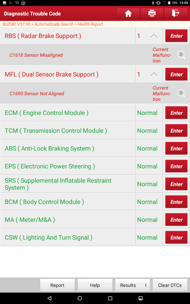

How can I solve this DTCs
C1618 sensor misaligned
After couple days this DTC is shown( C1690 sensor not aligned and I have data streamed screen shots
Thank you in advance
(This is same car posted on 8th March 2020)
6 years 3 months ago #41974 by Hardtopdr2
Replied by Hardtopdr2 on topic Re:Cruise Control
If there is a issue with the abs to where a code is generated it will dissable cruise control. So you will need to fix the brake system issue.

6 years 3 months ago #41986 by Hardtopdr2
You need to have RBS & MFL sensors aligned once that is done your cruise control should work.
