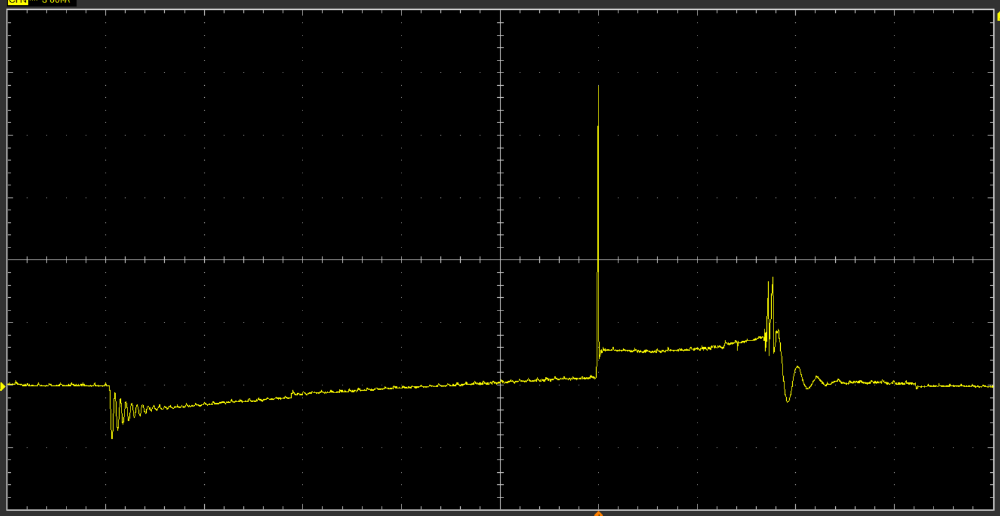

Hi all,
I'm tracing some idle misfire on my Wrangler 1995. 4.0 automatic. Engine shakes a bit but I can't find out why. It is not constant like when I unplug injector from a single cylinder, it is more like random cylinders misfiring. Distributor, coil and wires are as per FSM and have only 4-5 thousand miles on them. Cap, rotor and plugs are brand new. I had some issues with crank sensor signal and I've finally managed to get it to a decent shape.
I need some help regarding secondary ignition waveform interpretation. Is the waveform from video below ok? I can see some weird peaks at the end of burn line, sometimes it is longer than 2ms, and firing voltage is sometimes as low as 6kV. Video is slowed down (you can slow it down further on youtube) and it shows all cylinders (153624 firing order). I don't have another probe to use it as a single cylinder trigger. Time scale is 1ms while voltage is set to 2kV.

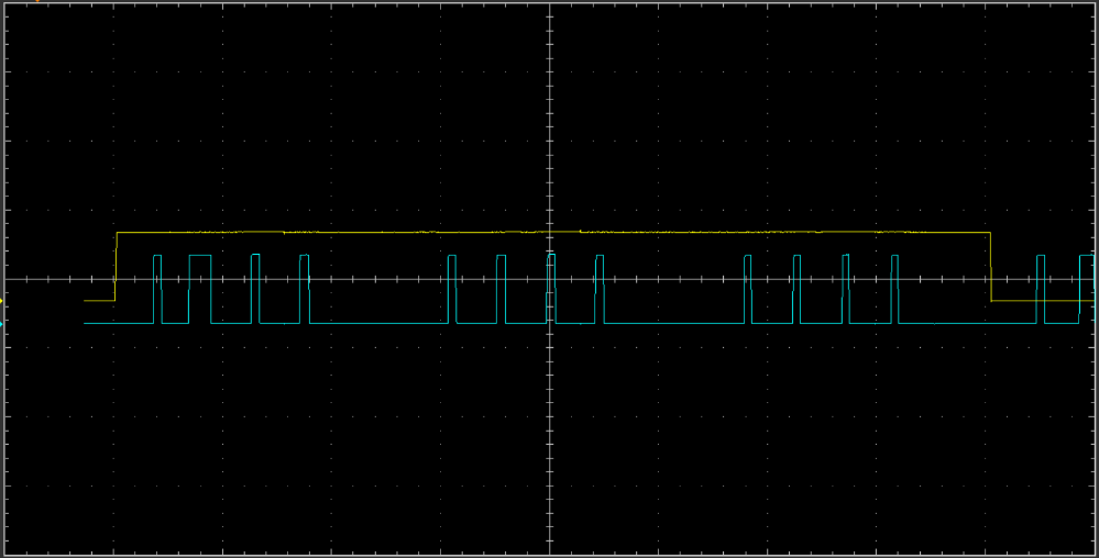

Here is the sample. I'm not sure if this is something scope related or it is really like that... Scales are 1ms and 2kV
I have just seen that CPS signal is not ideal yet. Cam/Crank relation should be different, it seems like the crank signal is a bit moved to the left. I'm wondering if cam/crank out of sync and this longer second pulse on crank signal would cause misfire?
CPS scale is 10ms 5v

spark firing voltage should be under 20kv. spark burn voltage 1.3 to 4kv (under 6kv). spark burn time 1.5ms no less then .9 or more than 2.4ms. 2ms can be Ok. end of spark is turbulence can be lean condition.
cam crank out slightly... should be 50% at turn on-off.

Hi sir not a lot of experience here that waveform does seem to be stretched out a bit I did not see an injector pintle hump and also that turn off oscillation looks funny where does ignition module get it s ground seems like spark line is a bit weak

Doesn’t look like a spark problem.
Here’s some things to keep in mind.
ANYTHING that can slow the revolution if the engine can create a misfire. Any pulleys, a harmonic balancer shifting wobbling.
I don’t really feel it’s necessary to ask for current ramp. I do think you should scope spark and spark control. Also a relative compression test and secondary ignition as a sync (timing).

Looks okay to me, not every firing stroke is identical and the fuel-air ratio is continuously changing in response to the O2 sensor. Also with distributor ignition systems individual aren't as repeatable as with coil on plug. From.your description I would want to double check the valve clearances, too narrow a clearance often won't show on a compression test.

Should have a slight rise in the burn line at the end which is left over energy from the coil at the end of the spark. When the tail raises up as in several of the waves, this indicates that all the hydrocarbons have been burned leaving high resistance in the cylinder, a lean condition.
If its in only one cylinder check for leak at intake runner of that cylinder. If its all check for lean variables for a global lean.
The burn line looks pretty good, should be flat. As you can see, it has a slight rise when you have the spike at the tail. The spark fire voltage will rise high as well.
If you view the waveforms in a parade view you can compare each and if you can isolate #1 cylinder you can see which of the cylinder are having problems. Looks a little erratic.

What bothers me are timing events. There is one pulse in crank signal that is a bit wider that all others. Could this one mess up spark/fuel timing enough to cause random engine shakes ?

I don't have current clamp so I cranked the engine and scoped crank sensor and secondary lead. It seems that spark occurs between 3rd and 4th peak of each crank sensor signal group. There are no missing sparks or more than one spark per cylinder, so this seems to be consistent.
After that I took fuel pressure gauge and measured pressure on idle. This time it had 27-8 PSI on idle. Factory spec is 31 psi. If I snap throttle it will bounce up a bit - maybe 2-3 psi, and when I release throttle it would go to 26 and then climb to 27-8. Is this proper behavior?
I have also tried to sync cam/crank sensor, but it is impossible to do so with this distributor. I followed FSM - put harmonic balancer to TDC (0 mark), blocked distributor shaft from rotating with a pin, however when I put it back i can't screw it in - i need to remove pin and rotate it a couple of degrees. This is weird, only thing that comes to my mind is that the clamping slot is not correct on distributor or that harmonic balancer does not point to TDC properly.
