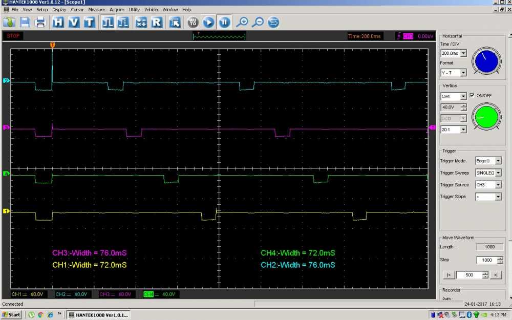

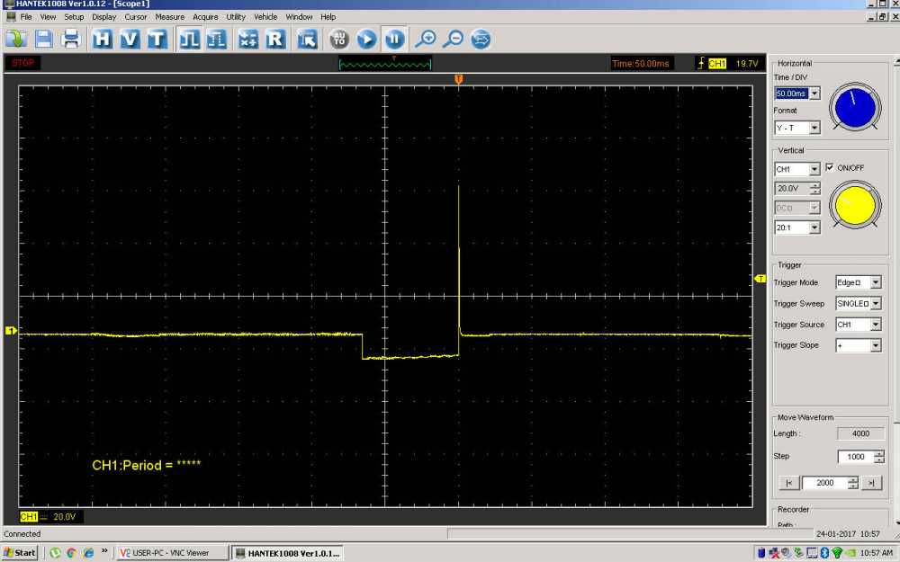

Have a 2003 PT Cruiser 2.4 non turbo, automatic. It is a no start, cylinders are super wet with fuel. After some poking around i did get it to start by disabling the fuel pump, and giving it a bit of starting fluid. When i say start i mean it ran on 4 cylinders until the "fuel" was gone. So i assumed at that point it was getting too much fuel, i back probed the ecm injector outputs, and i got 60-80ms pulse width while cranking!! (see attachments) The data PID for the "injector 1 pw" and "injector startup pw" are both ~76ms.. I tried resetting the computer with the scan tool (Autel MS905), no luck there.. None of the sensor inputs look to be out of whack, but i did notice both o2 sensors reading 5v KOEO, and the "bank 3" fuel trim was -100, but it didn't change with "resetting" the computer. I have checked powers and grounds to the ecm. At this point i want to say its a bad computer, but i want to throw this out there and see if anyone has seen this before.

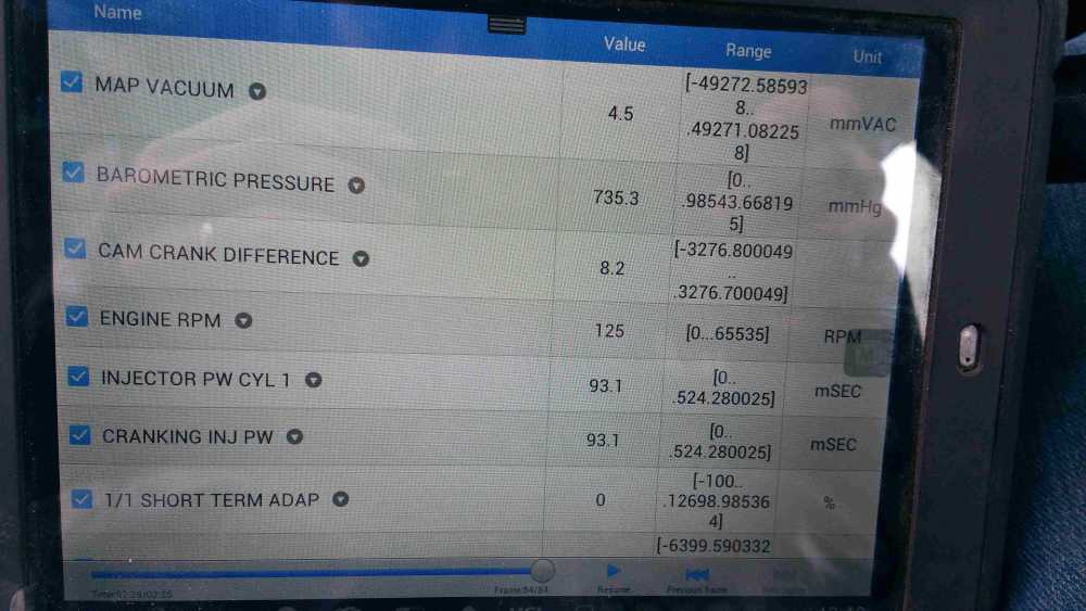

9 years 7 months ago #5151 by Jake
See attached image. I know the cranking rpm is a bit low, the battery isn't that great, i had it good and charged when i initially looked at it and the cranking speed was over 200rpm. This vehicle does not have a MAF, and i could not find any kind of estimated air flow value besides IAC estimated air flow, which i forgot to look at.. Might go do that.

9 years 7 months ago - 9 years 7 months ago #5194 by Jake
I installed the reman computer, started right up, i don't have time right now to drive it and make 100% sure its fixed, i will drive it some tonight and see what happens. On first start it had 50ms cranking, 3.?ms running, i forgot i had an open pcv hose, took care of that and we have 20ms startup now, will see what it does later.

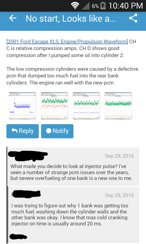

9 years 7 months ago #5227 by Noah
I just ran across a similar post on IATN about an Escape with a similar problem.
Can I post a screenshot of that without getting anyone in trouble?
9 years 7 months ago #5228 by Noah
I blacked out the names, we can call them tech a and tech b I guess.
9 years 7 months ago #5229 by Noah
Here's the link for other IATN members.
"No start, Looks like a jumped chain"
autop.ro/eIv

Nice find! I DEFINITELY would have chased a timing problem if I'd seen that relative compression waveform.
The original poster mentioned the max cold injector on time is 20ms... I wonder if he was using that as a general guideline, or on this specific engine? :huh: Either way, it seemed like that was a critical piece of information in his diagnosis. Without it, I think it'd be easy to go down the wrong path.

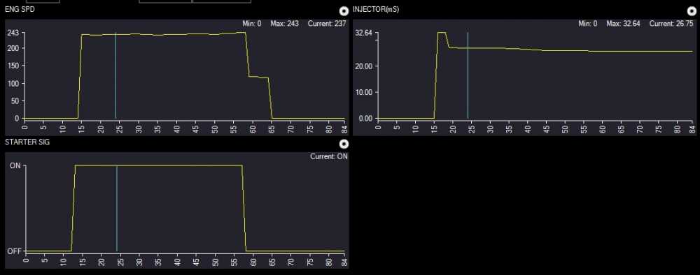

As usual, I had to try this on my personal car. This is a cranking shot, engine cold:
Forgot to get the ECT in there. :blush: Figure about 40 degrees. This falls within the 50ms value that Jake found earlier, so I'm pretty happy with that.
9 years 7 months ago - 9 years 7 months ago #5254 by Noah
Based on what we've learned, I think I'd be comfortable using a rough guideline of between 20 and 50 Ms on time while cranking. (For now of course. I realise that's quite a span of Time) I'll be paying more attention to this in the future for sure.

9 years 7 months ago #5255 by ScannerDanner
Replied by ScannerDanner on topic [FIXED] Long cranking injector pulse width (60-80ms)
50 m.s. sounds really high too! Had an old GM TBI with a 40 m.s. p.w. from a -40 ECT reading flood out the engine immediately. But then again, a big factor here is the flow rate differences of injectors themselves. I don't think the really is going to be a very good "ballpark" number.
