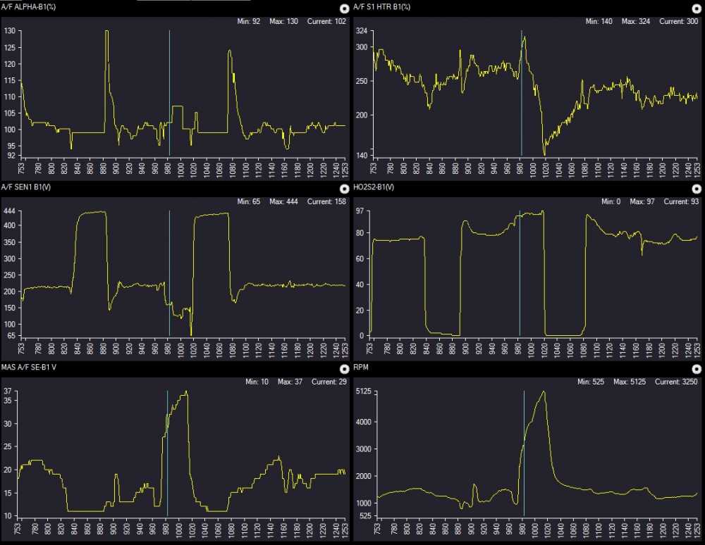

6 years 7 months ago #38382 by Tyler
Those lean spikes in the upstream A/F sensor are totally normal. Programmed reaction from the PCM when you get back on the throttle after a fuel cut deceleration event. The alphas/short terms will show a corresponding spike. I have a scan data example right here:
Nissan is also kinda weird about Long Term trims. :silly: So I'm not surprised at all that your Long Term PIDs show zero.
What's the average fuel economy that you're seeing? :huh: Highway, city driving?
