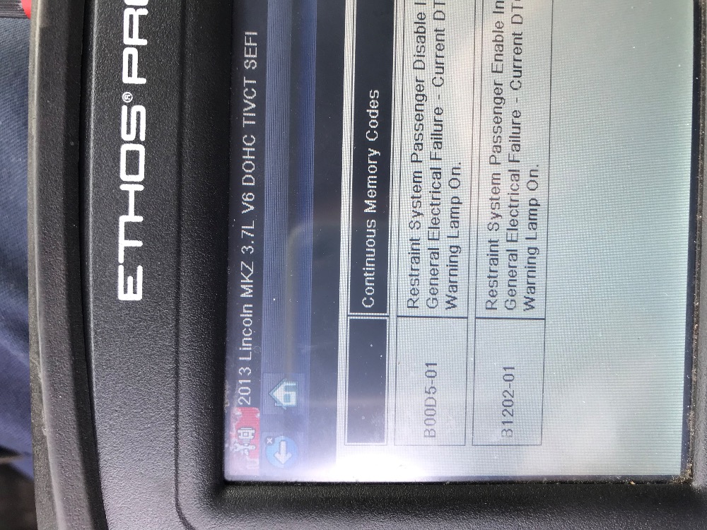

2013 mkz v6 airbag light on was created by Cheryl
I’m trying to find information on these dtcs but can’t find any information on them. Wondering if anyone has information or if ford just thinks it’s common sense so no need to publish information about them. Here is a screen shot of my cheap scanner . I’m about to go get my friends ids and see if Snap-on is pulling inaccurate codes or something. If I found code setting criteria I’d be able to diagnose it

Also if anyone has a wiring diagram factory or Mitchell is fine. Airbag system.

Those codes don't come up for me, sorry...

That’s an easy test. Where did you find this information at?? I checked alldata and they had nothing. Could you post removal of the fcim? I did the self test and it still threw the codes.

I use the old DVD version of Mitchell1 called OnDemand5 since I don't have subscription to those paid versions. See attachments in previous post on removal.

It doesn’t let me click on the link it’s just a screenshot. Guess I can youtube it. Just making sure no programming is required Because if it is I’ll borrow my friends ids

Okay I got them to work for some reason they didn’t work on my phone but on the laptop opened no issues. Thanks!
