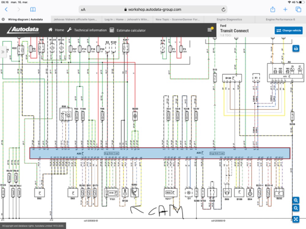

Hi I was doin som test with my scope on my car and I came across something weird about values on the cam sensor. All wires on all sensor goes directly to the pcm doesn’t share in wiring any wires. I measure with plug on 5v, ground and 12v. And assumed of course the 5v were my signal ? But apparently this is pull down on the 12v feed and this troubles me to understand. I’m lucky the sensor I working and doing tests on working engine but let’s say sensor was broken internal then I still would measure the same values and would have trouble determine which were signal wire.
I just think it showed that some time you just need the exact information from diagram. But I’ll attach one we use I Europe that for definite doesn’t show signal wire (signal I pin 3 on cam witkm12v)
