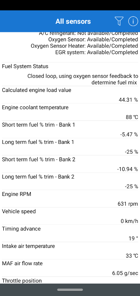

Hello first time using a forum because this time im desperate!
Ok here is the thing, I have a 96 F150 v8 5.0 getting P0172 and P0175 which means rich condition both banks.
I have replaced the following:
Fuel pressure regulator
Cleaned MAF
Oil change and sparks
coolant sensor
192 thermostat
Checked TPS and is working properly
Using a scanner at idle I see something weird all STFT bank 1 are oscilating -0.78% to +1.78% STFT bank2 are little off -5.08 to 2.04% BUT LTFT on both banks stay at -25% if I press the pedal they go to -14% or -7% or so. while truck running numbers change a little but as soon as I stop LTFT go back again to -25% on every component change I do a KAM reset to make sure truck relearn values.
I did a vaccum leak test to see if values change and yes all values go to positive.
I also notice engine load at idle is around 42% if pedal press it goes up
what could it be?
MAF??

6 years 7 months ago - 6 years 7 months ago #38411 by renegadiel
Replied by renegadiel on topic 1996 F150 P0172 and P0175
please take a look to attached picture

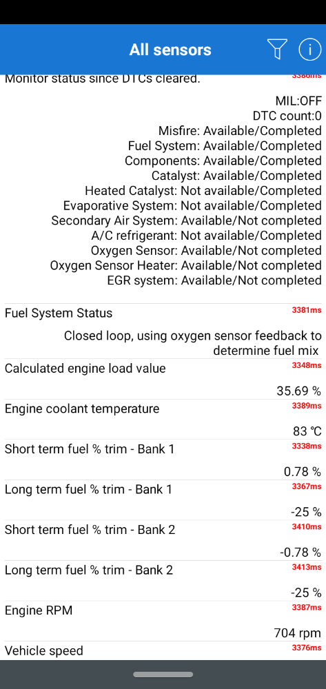

6 years 7 months ago #38418 by ScannerDanner
Replied by ScannerDanner on topic 1996 F150 P0172 and P0175
What are your trims and engine load values with the MAF unplugged

6 years 7 months ago #38526 by renegadiel
Hi ScannerDanner
please see the pictures with my maf disconnected.
engine off disconnect maf then start engine stft values were way negative and after 3 or 4 min tried to go back to 0
Hope this screenshots be good reference for you

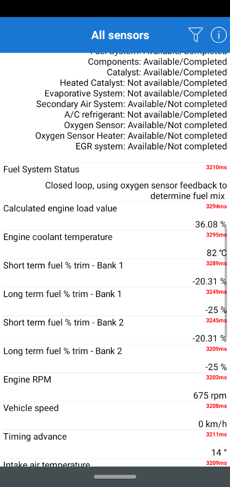

  • renegadiel
  • renegadiel's Avatar Topic Author
6 years 7 months ago #38566 by renegadiel
Hi ScannerDanner
any recomendation after unplugg the MAF? I attached the pictures
