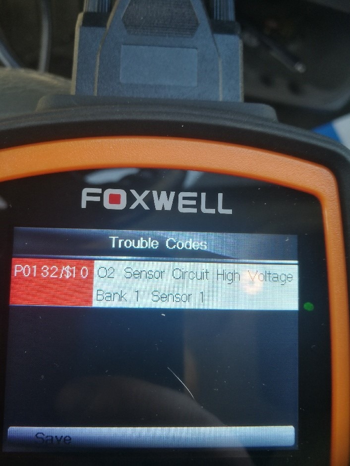

1. motorlight come on
2. diagnose: PO132 o2 sensor circut high voltage bank 1 sensor, look at picture 1.

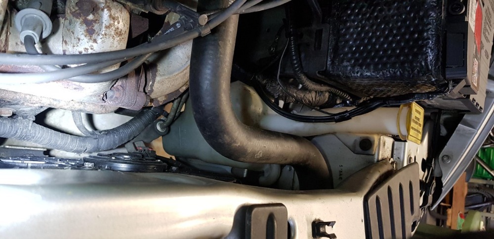

8. i have checked wires for breaks from 4 stifts oxygen sensor contact, exhause manifoil to the left side of the radiator, look at picture 2. this have done
with stripping off the whole thick wire . didn´t fine somthing that looked like a break.

Run the car long enough to allow the exhaust heat alone to heat up the o2 sensor and see if the o2 sensor voltage starts oscillating from high to low volts on the scan tool. If not check for the 5v bias voltage on the o2 sensor signal wire directly at the o2 with the key on, engine cold.
Can you elaborate on further on what you mean by chipped? Are there downstream o2 sensors or was that like programmed out or something?
How many o2 sensors have you tried and please take resistance reading of heater circuit as that may be useful data.
