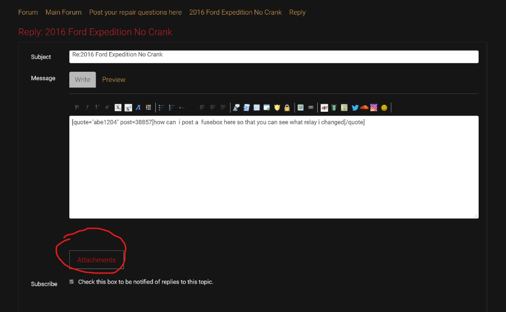

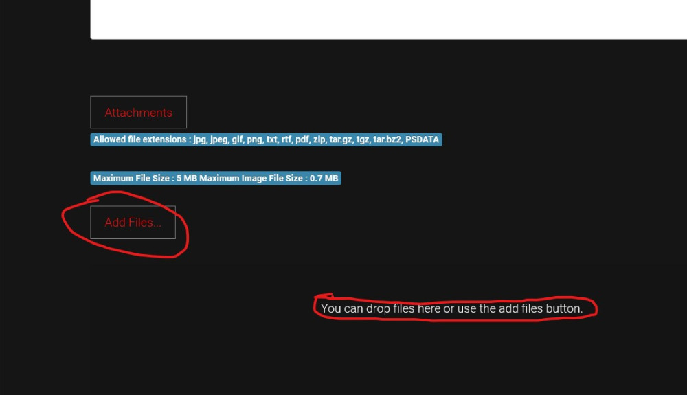

how can i post a fusebox here so that you can see what relay i changed
6 years 7 months ago - 6 years 7 months ago #38861 by Chad
Replied by Chad on topic Re:2016 Ford Expedition No Crank
abe1204 wrote: how can i post a fusebox here so that you can see what relay i changed
