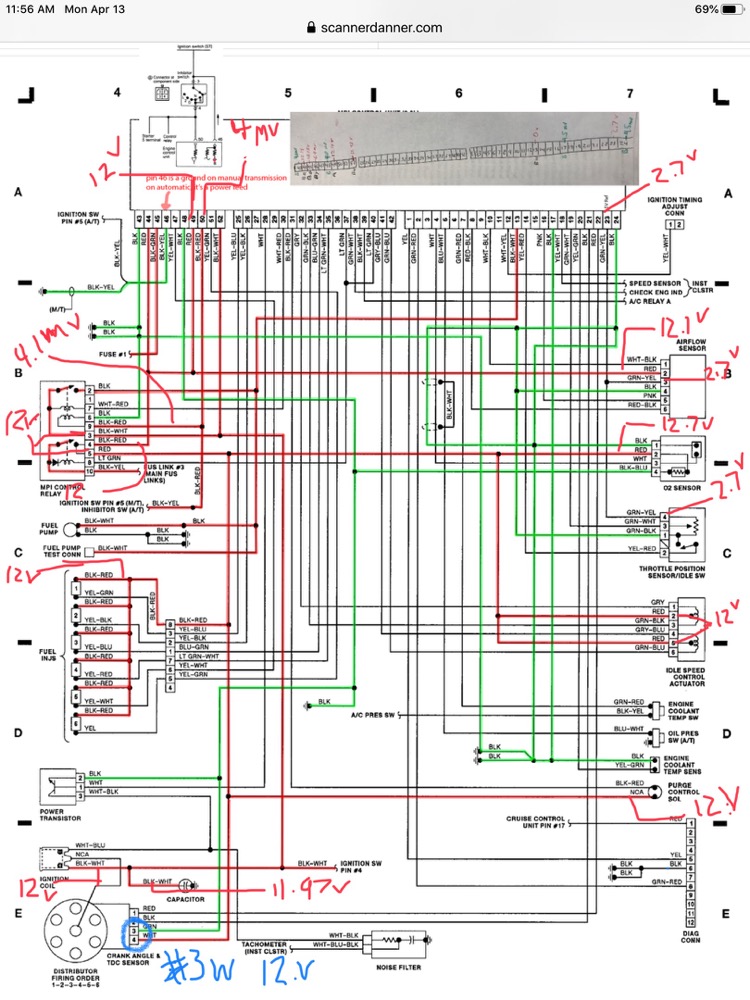

If this car has a fuel pump prime at key on, pin 13 should momentarily get voltage.
[strike]Pin 46 is low voltage so is this car a manual transmission?[/strike] never mind, 46 is only hot on start
Also check the female terminals visually and see if any looks weird at all.
Last edit: 6 years 6 months ago by jreardon. Reason: pin 46 mistake
6 years 6 months ago #39082 by jreardon
Replied by jreardon on topic 1990 Montero 3.0 Crank, No Spark
Here's updated image with your voltage readings, because I know for sure that image is upside down for you all lol.

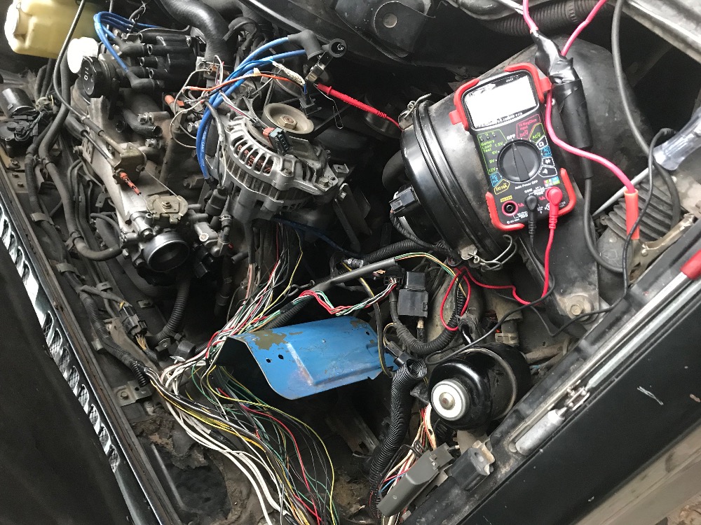

6 years 6 months ago #39090 by Minivandan
Replied by Minivandan on topic 1990 Montero 3.0 Crank, No Spark
Here are the next set of voltage readings with key on and sensors unplugged.
Just to be sure when I test grounds, red should be to battery positive and ground to connector or ecu?
Or should I be looking for voltage drop down the wire?
No power yet coming from 13 on initial key o position. I currently have the fuel pump disconnected at the pump due to with the other ecu the engine stopped rotating on cranking do to the excess fuel Pressure in the cylinders with no spark.
Still 2.7 v at tps and air flow sensor connector unplugged and same at ecu.
6 years 6 months ago #39092 by jreardon
Time to ohm check the 5v reference wire for a short to ground. The fastest way to check is to cut the wire at the ECU harness and check if voltage returns to 5v.
The longer way, if you don't want to cut wires, it to unplug the ECU, TPS, and Airflow Sensor. That way the wire is completely isolated. Take your multimeter and set it to ohms (the icon looks like a horse shoe) (if you don't have an auto-ranging meter, set it to the highest scale). Connect one end of meter to ground (battery negative is best) and the other end to the 5v ref wire you just isolated. It doesn't matter which end goes where. Please report your meter readings. "OL" means no short to ground. It also means your computer's bad.
