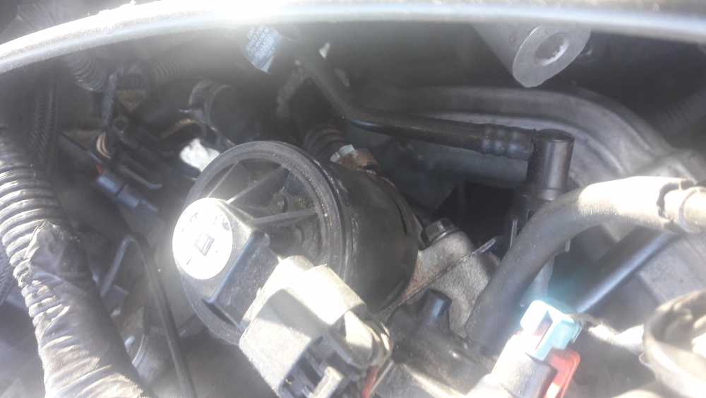

Donnyten wrote: Got about 240,000 miles on it. . Just wanted a ballpark before and after looseness.
With that mileage, I think you could justify a timing set, assuming that you mean to keep this vehicle for the long term.
To avoid making another topic do you know if these electronic general motor EGR valves can be serviced? Like is there a way to open it up and clean the carbon out?
Not that I'm aware of. You can clean the pintle and seat on some of the GM EGR valves, but I think yours looks something like this, right?
On these valves, it's tough to even get to the pintle for cleaning.

Yep. Definitely cleaned the intake passages and whatever I could. These things can't be serviced at all.
