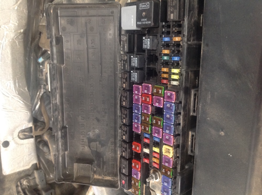

[FIXED] 2016 FORD EXPEDITION was created by abe1204
here a fuse box a ford wont crank
Last edit: 6 years 6 months ago by Tyler.

6 years 7 months ago #38890
by abe1204
Replied by abe1204 on topic 2016 FORD EXPEDITION
from right top second relay

6 years 7 months ago #38892
by abe1204
09 relay

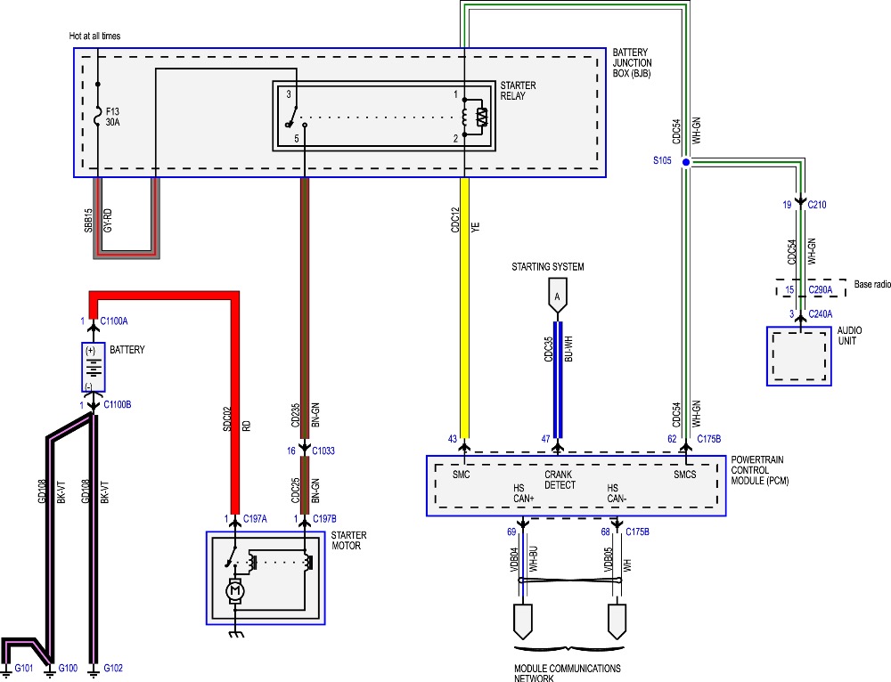

- John Curtis
- Posts: 345
- Thank you received: 111
6 years 7 months ago #38900
by John Curtis
Replied by John Curtis on topic 2016 FORD EXPEDITION
You need to see what you’re missing.
Check power on fuse 13 (30 amp)
At relay
Check pin 2 yellow wire is starter motor control during crank this should light a test light.
At pin 3 you should have B+
With key in run try jumping pin 3 to 5. This should power up your starter.
At the starter brown and green should like a test light or have B+.
Higher amp bulb (headlight bulb) test red wire at the starter and ground and see if it lights. (Checking off circuit can handle current)
Verify good grounds.
At relay

Your not getting any trouble codes on a system scan? You have a health report? So we can have something to go off of. Do you see crank request information in the bcm?

6 years 7 months ago #38903
by abe1204
Thank you Cheryl the one that i get is the number 09 relay RUN/ CRANK RELAY this relay is not working properly I found out that this relay supply voltage to PCM and ABS . so i changed and it works and crank fine now ,,

6 years 7 months ago #38904
by abe1204
THANK YOU JHON, yesi do checked everythings and i found that relay number 09 is not working propely i changed a new one it cranks fine now RUN/CRANK RELAY ,,
